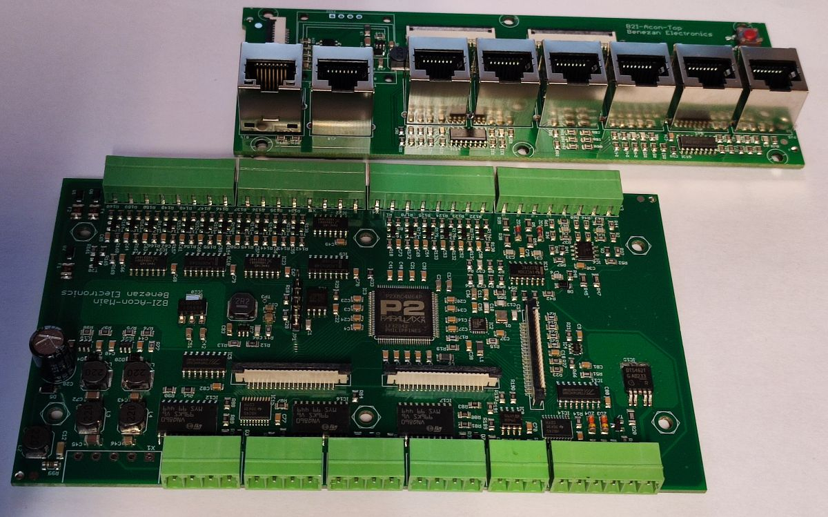

The controller will have two stacked PCBs. The main board at the bottom will hold the P2 and the 24V IOs. The upper board is for the Ethernet, encoder and axis ports. The upper board can be modified to fit special needs in the case customers request it. For example I could add more IOs or more axes by multiplexing some of the slower signals to save P2 pins.

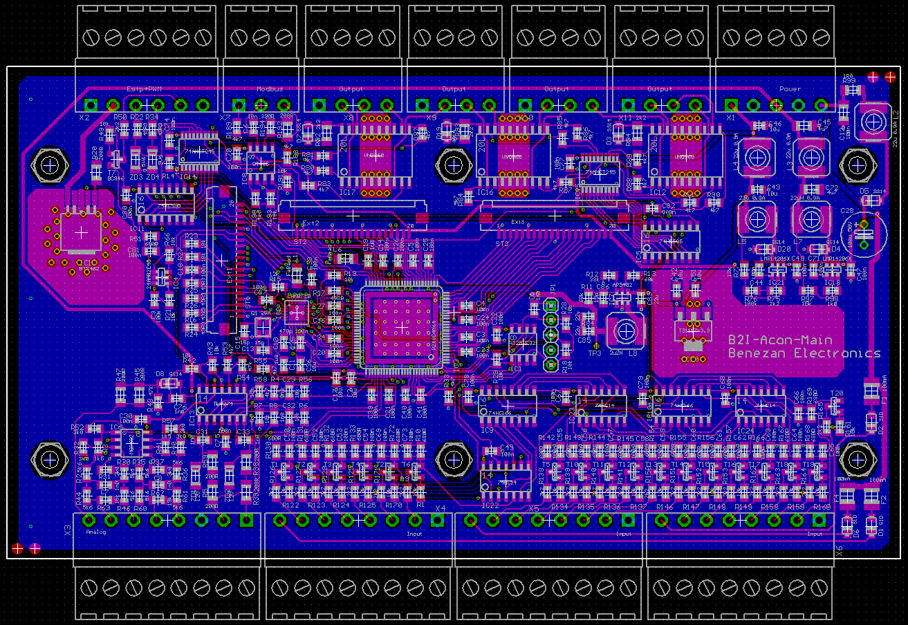

  • Layout of the main board finished.
    My friend Ingolf: "The board is almost empty. You should add some more features."
    Mariss: "I hate the color of green." :D
    My excuse: "The enclosure dictates the board size."

  • Amazing PCB layout work.
    Question: how do you protect the 24 VDC output power from random noise, voltage spikes, RF coupling, and all the rest ?
    Follow on: how are the input I/O control lines protected, buffered and filtered ?
    and how are the output I/O signals amplified and protected ? TIA...
  • I'm not sure what you mean with "24 VDC output power". Outputs are short circuit protected and have an internal voltage clamp so that they can directly drive inductive loads like solenoids or relays without getting damaged by voltage spikes. I use automotive lamp drivers (VNQ860) that already have full protection built in (overheat, overcurrent, reverse voltage).
    For the inputs I use a special circuit that is effectively a constant current sink combined with an RC low pass filter and schmitt trigger. It takes any voltage from 5 to 60V as high and everything <5V as low with a reaction time of ~1ms. Proximity sensors can be used without shielded cables.

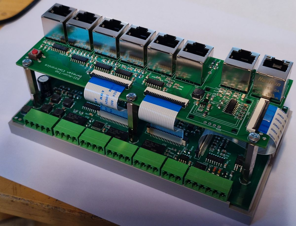

  • Yesterday, I assembled the PCBs.
    Those FFC cables save a bit of money, space and weight but I don't like the assembly at all. I'm always scared to break something and never sure if the connectors are tight and locked.

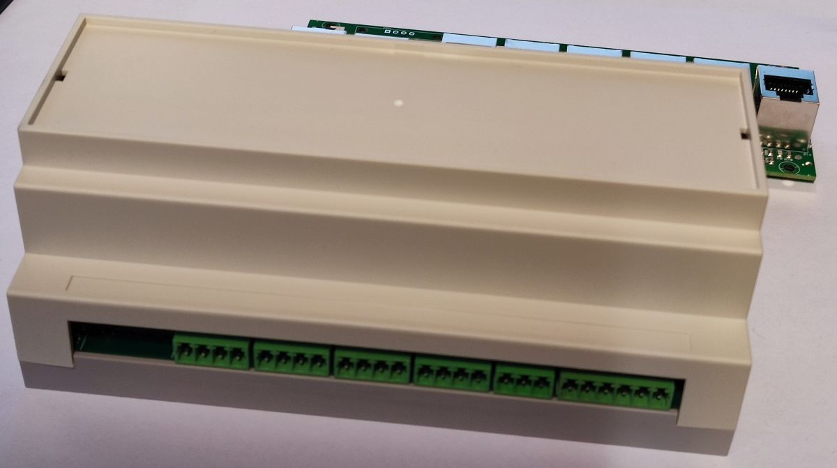

  • Very nice! those DIN rail enclosures are great for that. what brand is yours. I'd only seen ones with dividers in not-always-great positions, would prefer what you have with one wide open slot top and bottom.
  • The link to the enclosure manufacturer is in post #1. The BRT-80005-A1 has slots for the green terminals on both sides while the -A3 version has no cutouts. There is a transparent acrylic cover on the top side but it's of bad quality (unequal thickness causes distortions and rainbow reflexions). I will replace that with a custom made front panel. The inner board fixtures (see drawing) are also quit sub-optimal for my case. Standard M3 spacer posts also don't fit into the screw holes but that can be fixed with little effort.
    BAHAR offer customization to their enclosures like laser cutting and screen printing but I like to keep the enclosure itself standard and rather add customized panels which can easily be exchanged for different variants of the PCBs if customers requirements change.

    Today, I've machined the top cover.
    I've made some mistakes regarding the measurements of the enclosure. It's not exactly a rectangular box but has a slightly truncated pyramid shape to help extracting it from the injection mould. This means it gets narrower towards the top and the upper PCB doesn't fit exactly. I also have to move the display slightly inbound.

    The first smoke test was successful. No smoke, the voltage regulators work as expected, digital IO and display are OK.
    Next items to check: Ethernet, step/dir signals and encoder input.
    The layout needed some corrections: I forgot some pullup/pulldown resistors, outline needs to be some 0.1mm smaller

  • The schematics needed some small fixes. A series resistor to make an input 5V tolerant was too small. The current injected into the body diode caused two neighbouring DAC pins to fail completely (luckily not irreversibly). They saturated to 3.6V and 0V regardless of the DAC value. I changed the series resistor to a voltage divider to fix this.
    The encoder input, the Ethernet interface and the step/dir outputs are also working, now. :) And I've implemented the screen saver.
