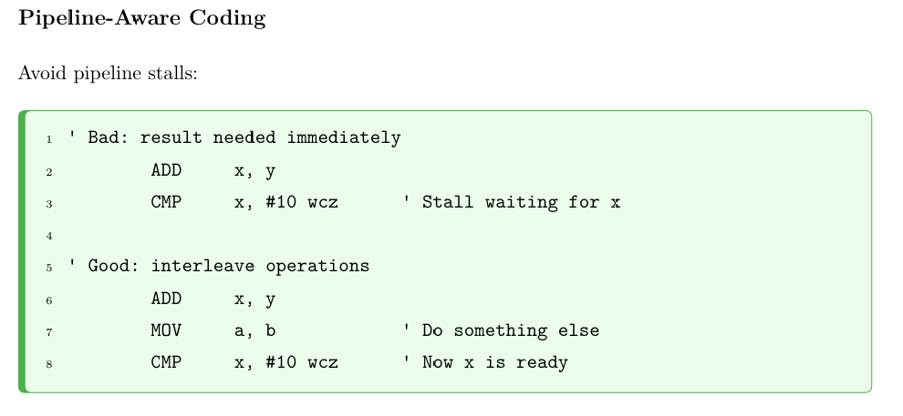

That's not what I mean. I think it is a matter of how the code blocks are translated to PDF.
I did a bit of digging through the source files.
This is the original code block, which is good.
**Basic Usage:**
```pasm
_ret_ add x, y ' ADD then return (flags same)
_ret_ drvnot #0 ' Toggle pin 0, then return
_ret_ mov result, temp ' Copy to result, then return
The PDF generator translates it to what seems a table with columns representing the indentation.
In the image above I tried to select just the first row but also selected the columns below, and all indentation spaces are trimmed.
What I was expecting is the code block to be translated verbatim so it can be selected.
I was going to try to suggest something, but I see that other documents suffer from the same issue (PropellerManual and also HydraGameDevManual), maybe it is a limitation of the PDF format or the translation (I think it skips the spaces entirely and prints just the text at the expected column). I used iText to generate PDF documents several years ago but I don't remember the details.
If not possible, a separate archive would be fine.

Is this really stalling the pipeline??????
No, of course not
