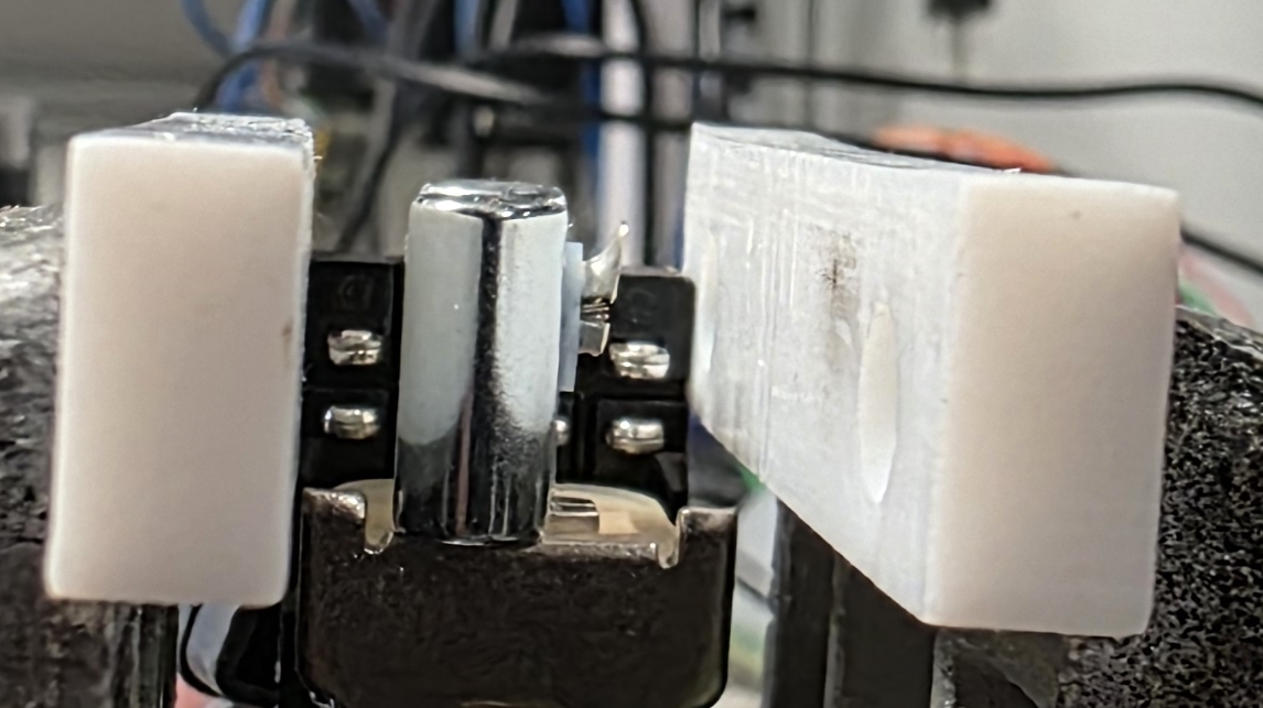

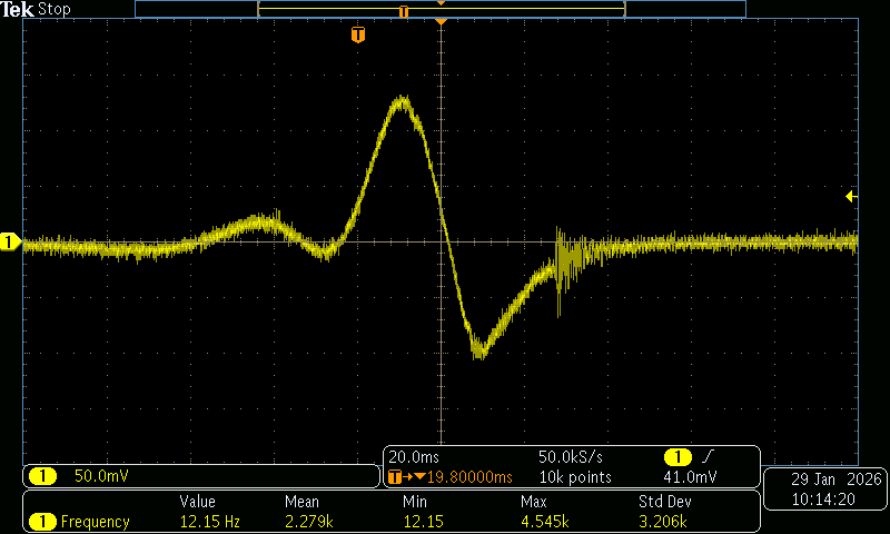

  • Experiments at lunch:
    2 magnets on a coil salvaged from a 24V DC relay. The magnets are 1/4 " diameter and apx 17/32" long. Unknown composition, but not impressive magnets at all.
    The oscilloscope capture is from sliding my wire stripper across the plastic jaws of the vice. Non-ferrous experiments with these weak magnets were disappointing. Better magnet(s) and pole pieces should help a lot.
    I will work on a one-transistor amplifier for this, it won't take much to go from 250mV p-p to clip negative at 3V3 resting.
    I attribute the 'ring' at ~ 130mS to vibration from the wire strippers going over the edge of the jaws.

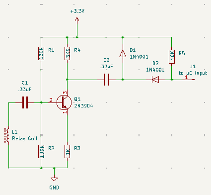

  • Not abandoning this, Had a busy weekend and just received small, but mighty neo magnets.
    This amplifier should have a V gain of about 10 dB, will certainly clip for the signal shown. D1 and D2 to ensure full negative drive. Will add 100 ohm resistor before uC input to soften any possible negative overdrive.
    again, THIS IS NOT TRIED YET.
    I am doing this because it is interesting. It is possible that the interference to the ball caused by the magnets involved will overcome any advantage of accuracy in the OP use, but not for me to decide.
