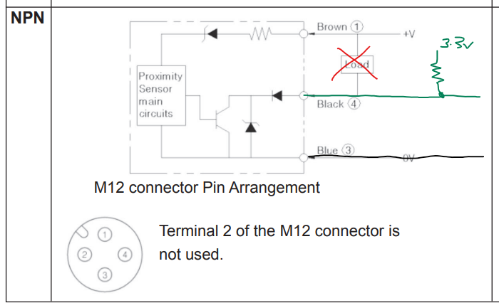

    There's a link to the datasheet right on the sales page. In that datasheet you'll find a circuit diagram -- I clipped and edited.
    That device is NPN/Open-Collector. What this means is that pin 4 (black wire) is either floating (like an open switch) or connected to ground. If you want to monitor that with a microcontroller like the Propeller, connect a pull-up (e.g., 10kl) to pin 4 and the other side to 3.3v. When the sensor is idle, the Propeller input pin will see a high; when the sensor is active, that pin will go low. Easy peasy. Note that the sensor is powered by 12v, and the ground on the sensor and the microcontroller must be connected together for this to work.
    Thanks, I did manage to wire it up. I was actually hoping for more insight into the mysterious "Proximity Sensor main circuits" box :smiley:
