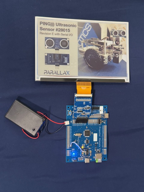

    Getting ready to test this out with P1.
    Not liking any of the image converter apps out there that prepare a data file from an image after some dithering maybe.
    Decided much better to just use Photoshop to create a 4-bit bmp file. The palette is specially made so the image data can be directly copied to the display.
    Image is too big for P1 though (188 kB), so will have to be on uSD...
  • RaymanRayman Posts: 16,225
    One sorta issue is that the busy signal requires a pullup resistor and P1 doesn't have those internally.
    Could add a real resistor to be pullup.
    But, have read that can just use a fixed delay instead of polling the busy pin...
    edited 2026-01-08 22:37
    Back to debugging P1 code :(
    There really should be a note in the library spin SPI driver that there is a minimum delay value...
    This calc:
    ClockDelay := ((clkfreq / 100000 * _ClockDelay) - 4296) #> 381
    comes out negative if delay is too small :(
    edited 2026-01-08 22:55
    Out of time for today, but got it to display an all green screen.
    Switched SPI driver to ASM, but still takes ~15 seconds to update.
    Guess doesn't really matter cause still showing old image while data is transferred...
    I've seen green and blue so far and they are both darker that was expecting...
    Well, the above code doesn't work today :(
    Seems we actually need to start with clock in low state, so start driver like this:
    spi.start(1,0)
    Must have been just on the edge before, shouldn't have worked really but did anyway for some reason, at least for a while.
    Anyway, think all better now.
    Think have it now, but colors are darker than what I'd call optimal.
    Am looking around for actual color palette and think may have found something on github:
    SPECTRA6_REAL_WORD_RGB = [
        (25, 30, 33),
        (232, 232, 232),
        (239, 222, 68),
        (178, 19, 24),
        (33, 87, 186),
        (18, 95, 32),
    SPECTRA6_DEVICE_RGB = [
        (0, 0, 0),  # BLACK
        (255, 255, 255),  # WHITE
        (255, 255, 0),  # YELLOW
        (255, 0, 0),  # RED
        (0, 0, 255),  # BLUE
        (0, 255, 0),  # GREEN
    Think that first one is supposed to be "Real_World". It appears like it might be right, so I'll try it in photoshop...
    480 x 640 - 214K
    Much better now. There was a bug in the palette. Forgot that there is no color #4 with this display. So, made color #4 a duplicate of color #0 (black) in Photoshop, and this seems to work. Fortunately, Photoshop will use the first instance of a color in the palette if there's a duplicate...
    Tried powering with coin cell. It's enough to power the board, but appears that it's not enough for uSD.
    So, switching to 3X rechargeable AAA
    Now doing life test. Switching between images on uSD every 30 seconds.
    In real life, would switch maybe once a day or once an hour or something, but speeding things up here.
    Assuming can put P2 in low power mode between refreshes...
    Well, it's been difficult to get an exact lifetime so far (cause busy with other things). But, seems 3X rechargeable AAA can power display for between 3 and 8 hours with screen updating every 30 seconds.
    So, if doing the math right, should be able to work for about a year without changing batteries if only updating once a day and can reduce power in between to as low as possible...
