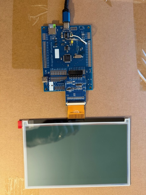

    Getting ready to test this out with P1.
    Not liking any of the image converter apps out there that prepare a data file from an image after some dithering maybe.
    Decided much better to just use Photoshop to create a 4-bit bmp file. The palette is specially made so the image data can be directly copied to the display.
    Image is too big for P1 though (188 kB), so will have to be on uSD...

    One sorta issue is that the busy signal requires a pullup resistor and P1 doesn't have those internally.
    Could add a real resistor to be pullup.
    But, have read that can just use a fixed delay instead of polling the busy pin...

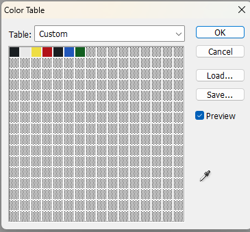

    Think have it now, but colors are darker than what I'd call optimal.
    Am looking around for actual color palette and think may have found something on github:
    SPECTRA6_REAL_WORD_RGB = [
        (25, 30, 33),
        (232, 232, 232),
        (239, 222, 68),
        (178, 19, 24),
        (33, 87, 186),
        (18, 95, 32),
    SPECTRA6_DEVICE_RGB = [
        (0, 0, 0),  # BLACK
        (255, 255, 255),  # WHITE
        (255, 255, 0),  # YELLOW
        (255, 0, 0),  # RED
        (0, 0, 255),  # BLUE
        (0, 255, 0),  # GREEN
    Think that first one is supposed to be "Real_World". It appears like it might be right, so I'll try it in photoshop...

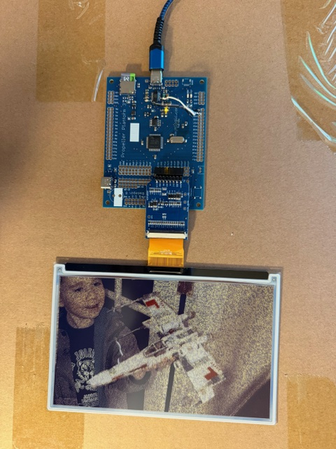

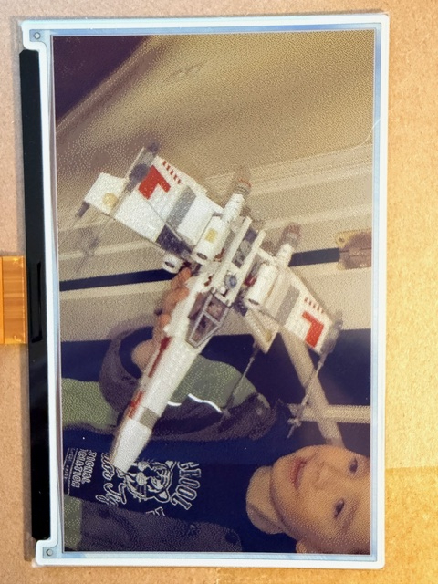

  • RaymanRayman Posts: 16,460
    Much better now. There was a bug in the palette. Forgot that there is no color #4 with this display. So, made color #4 a duplicate of color #0 (black) in Photoshop, and this seems to work. Fortunately, Photoshop will use the first instance of a color in the palette if there's a duplicate...
    Here are the .act and .pal palettes. Think would work with other image editors, like Gimp, etc. as well...
