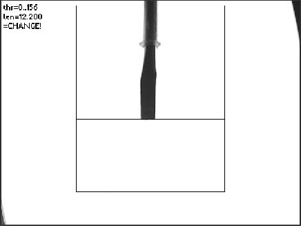

My new automatic tool changer means I can let the machine run unattended with longer jobs and multiple tools. But this also means if something goes wrong in the middle it can get more expensive. Sometimes the cutter breaks which is no big deal if you notice it. You stop the machine, change the cutter and continue.
But if unattended the machine continues to run but without removing material. So let's assume we want to tap pre-drilled holes. If the drill bit breaks the machine changes the tool to the tap drill and ruins it by ramming it into the solid material where the pre-drilled holes should be but aren't. :/
The usual fix to this is to measure the tool length with a touch probe or an optical laser barrier, once after the tool has been picked up from the tool changer and once again before it is stored back. But this takes time as the machine has to move to the location of the probe and then has to slowly advance the Z axis until the tool tip hits the probe or laser beam.
Inspired by the latest "AI & Vision with the cyber:bot and MakeCode" tutorial a better idea would be to do this with a camera and simply compare the "before" and "after" pictures. They could look something like this:
The point of interest is the distance from the collet to the lowest point of the cutter tip.
This point could be an a different side after the cutting process due to a different rotation of the tool.
But the overall length should stay the same within some small tolerance. If the length differs considerably then there's something broken.
I did some experiments with machine vision a long time ago. At that time this was usually be done with a PC, an industrial camera and a frame grabber card and you could easily spend multiple $1000s on it. Today, there a small gadgets like the HuskyLens for less than $100. But I don't know if this paticular thing is suitable. It looks like a "toy" for students with a very limited set of features like face or color recognition.
Does anybody here have experience with machine vision and can recomment something that can easily be programmed and tuned?

  • Nice! :D Although I intentionally asked the forum instead of ChatGPT directly to hopefully get some answers from real humans I have to admit that this is quite helpful. I don't know if I would trust the quoted code blindly but any flaws can be fixed easily if you have some basic technical understanding.
    Calibration is not necessary because the actual length doesn't really matter, only the difference. OK, for the scale of the tolerance it matters, but a rough guess is enough.
    BTW, I can take the picture inside the tool changer at the lowest position of the caroussel magazine. The tool stays there for a brief moment so no extra movement of the spindle is necessary and motion blurr is no issue.

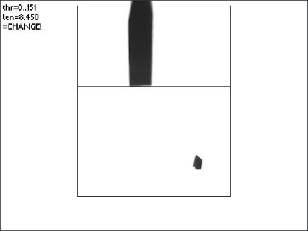

    Found my RT-1062, and after a few iterations with ChatGPT I have a program that prints to the terminal window when the object length changes. It needs more work to really make it work, this was just a quick test under poor lighting conditions.
    The program averages the first 18 frames as a baseline to which it later compares.
    OK     tip_y=219  len=9.950  len_ma=9.950  base=9.950  Δ=0.000 mm
    CHANGE! tip_y=171  len=7.550  len_ma=9.150  base=9.950  Δ=-0.800 mm
    CHANGE! tip_y=159  len=6.950  len_ma=8.150  base=9.950  Δ=-1.800 mm
    CHANGE! tip_y=152  len=6.600  len_ma=7.033  base=9.950  Δ=-2.917 mm
    CHANGE! tip_y=165  len=7.250  len_ma=6.933  base=9.950  Δ=-3.017 mm

  • It works! First, I've tested it with a plain white paper as background and a screwdriver.
    Most of the time the measurement is correct but sometimes the line that marks the tip jumps to a false edge inside the tool, for example the end of the insulation sleeve.
    With the backlight panel the background is fully saturated white and the contour recognition works much better, of course. The results are very stable. Now, I just need to figure out how to implement the learn vs. compare commands and drive the output pins accordingly. Shouldn't be too hard. There are examples of how to poll and drive pins. But I've never coded python before.
  • Hmm, celebrated too early. Only slight changes to the lighting conditions can lead to the tip recognition to fail.
    It locks to the step where the width changes instaed of the tip. I have to change the filtering.
  • banjobanjo Posts: 482
    Yeah, I remember it was sensitive, I did though not test it systematically under controlled conditions. If you don't get it to work, I suggest you ask in the OpenMV forums I linked to earlier, someone might have a better solution than I (with help of AI) created.
  • I think I already have an idea of how to fix it. The find_edges() and the if row_stat.l_mean() > 10 favors horizontal edges. If the tip is not rectangular but triangular (like a fish tail cutter or countersink) the algorithm focuses to false edges inside the tool shape. I'll try to extract a solid area instead of edges with Otsu's method.
  • Bingo!

  • ... and searching top-down instead of bottom-up still works with some dirt on the screen.
    Maybe I should use erode() and dilate() to eliminate smaller dirt particles and call find_blobs() and throw an error if more than one blob is detected.
