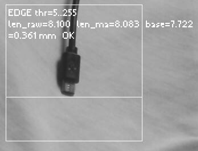

If you can control the lighting environment, the camera option might still be an alternative. If I have the bandwidth during the weekend, I might try to better simulate your scenario using the OpenMV Cam and program I already have.
This works better and faster, still room for improvements. It was challenging to find the right exposure settings, would've been easier if I'd used a lightbox where I control the lighting conditions, but as it's a chore to set it up I left it out. Will probably leave this exercise, at least for now.
# Detects the lowest edge row (tool tip) using find_edges(EDGE_SIMPLE) inside ROI. # Prints length in mm and flags if the tip position changes. 2025-10-25 03:40 — Thomas Vikström # Thomas Vikström import sensor, image, time # ==== USER SETTINGS ==== ROI = (10, 10, 240, 240) # must include the full tip and a bit of background below EXPOSURE_US = 28000 # fixed exposure for stability PIXELS_PER_MM = 20.0 # calibrate this once EDGE_THRESH = (5, 255) # low/high thresholds for EDGE_SIMPLE or EDGE_CANNY EDGE_MODE = image.EDGE_SIMPLE # try EDGE_CANNY for smoother contours PRINT_EVERY_N = 1 CHANGE_THRESH_MM = 3 # alert if |Δ| > this HYST_MM = 0.5 # ==== STATE ==== baseline_mm = None alarm = False ma_buf = [] MA_WINDOW = 3 LEARN_FRAMES = 10 learn_buf = [] def s3(v): return "{:.3f}".format(v) if v is not None else "--" def setup(): sensor.reset() sensor.set_pixformat(sensor.GRAYSCALE) sensor.set_framesize(sensor.VGA) sensor.skip_frames(time=2000) sensor.set_gainceiling(8) sensor.set_auto_gain(False) sensor.set_auto_whitebal(False) sensor.set_auto_exposure(False, exposure_us=EXPOSURE_US) print("READY — keep camera fixed, jog Z to move the tip up/down inside ROI.") def pixels_to_mm(py): _, y0, _, _ = ROI return (py - y0) / PIXELS_PER_MM def moving_avg(buf, x, n): buf.append(x) if len(buf) > n: buf.pop(0) return sum(buf)/len(buf) def learn_avg(buf, x, need): buf.append(x) if len(buf) > need: buf.pop(0) return (sum(buf)/need) if len(buf) == need else None def find_tip_with_edges(img): # Run edge detection on a copy of the ROI r = img.copy(roi=ROI) r.find_edges(EDGE_MODE, threshold=EDGE_THRESH) x0, y0, w, h = ROI # Scan from bottom→top for first row that has any bright edge pixels for j in range(h - 1, -1, -1): row_stat = r.get_statistics(roi=(0, j, w, 1)) if row_stat.l_mean() > 10: # 10–15 works fine for EDGE_SIMPLE return y0 + j return None def draw_overlay(img, tip_y, length_mm, sm_len, delta, alarm_flag): img.draw_rectangle(ROI, color=255) if tip_y: img.draw_line(ROI[0], tip_y, ROI[0] + ROI[2] - 1, tip_y, color=255) y = ROI[1] + 4 def put(s): nonlocal y img.draw_string(ROI[0] + 4, y, s, scale = 1.9, mono_space=False); y += 20 put("EDGE thr={}..{}".format(*EDGE_THRESH)) put("len_raw={} len_ma={} base={}".format(s3(length_mm), s3(sm_len), s3(baseline_mm))) put("Δ={} mm {}".format(s3(delta), "CHANGE!" if alarm_flag else "OK")) def main(): global baseline_mm, alarm setup() f = 0 while True: img = sensor.snapshot() tip_y = find_tip_with_edges(img) if tip_y: length_mm = pixels_to_mm(tip_y) sm_len = moving_avg(ma_buf, length_mm, MA_WINDOW) if baseline_mm is None: maybe = learn_avg(learn_buf, sm_len, LEARN_FRAMES) if maybe is not None: baseline_mm = round(maybe, 3) print("BASELINE {:.3f} mm (avg {} frames)".format(baseline_mm, LEARN_FRAMES)) delta = None; alarm_now = False else: delta = sm_len - baseline_mm if not alarm and abs(delta) > CHANGE_THRESH_MM: alarm = True elif alarm and abs(delta) < (CHANGE_THRESH_MM - HYST_MM): alarm = False alarm_now = alarm else: length_mm = sm_len = delta = None alarm_now = False draw_overlay(img, tip_y, length_mm, sm_len, delta, alarm_now) f += 1 if f % PRINT_EVERY_N == 0: if tip_y is None: print("NO_TIP (adjust EDGE_THRESH or lighting)") elif baseline_mm is None: print("LEARN len_ma={} ({}/{})".format(s3(sm_len), len(learn_buf), LEARN_FRAMES)) else: print("{} tip_y={} len={} len_ma={} base={} Δ={} mm".format( "CHANGE!" if alarm_now else "OK ", tip_y, s3(length_mm), s3(sm_len), s3(baseline_mm), s3(delta) )) time.sleep_ms(5) main()I have no doubt that this can work very well if you train for every specific job or material. But I don't run large volume series production but rather many small jobs, often one-time prototypes. Training would take more time than the cutting itself. So I simply don't want to do it that way.
Thanbk you very much, @banjo! I have to buy one of those OpenMV cameras. I think I can get much better lighting conditions with an LED backlight tile reducing background noise and shadows.

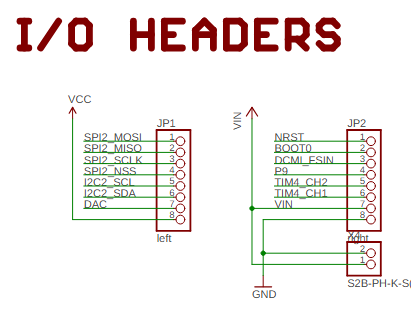

Errr, next question: which camera module would suit my application best? It would be good to have 3 IO-pins, two inputs for the commands "learn" and "check" and one output for "good/bad". This way I can interface it to the CNC controller without having to send serial data over USB.
Most camera modules have the two IO pin headers JP1 and JP2.
The description says the IO pins drive 3.3V and are 5V tolerant. I can connect optocouplers to interface to the 24V signals of the CNC controler. But which pins can I use as general purpose IOs?
The RT1062 has a lot more IO pins and even Ethernet and Wifi. I think I don't need that.
Ok, in this case I agree it would not be worth it to collect data and train a model.
If you are looking into OpenMV cameras, I suggest you ask this in their forum: https://forums.openmv.io/. As I understand it, the pins P0-P9 on the OpenMV Cam H7 Plus are GPIO pins, but there might be some caveats so better to ask before.

Browsing the forums I found this documantation page and the quick reference for the H7 plus board. So I think it's correct that P0..P9 can be used as 3.3V GPIO. I've just ordered a H7 and will try it out.

It works! First, I've tested it with a plain white paper as background and a screwdriver.
Most of the time the measurement is correct but sometimes the line that marks the tip jumps to a false edge inside the tool, for example the end of the insulation sleeve.

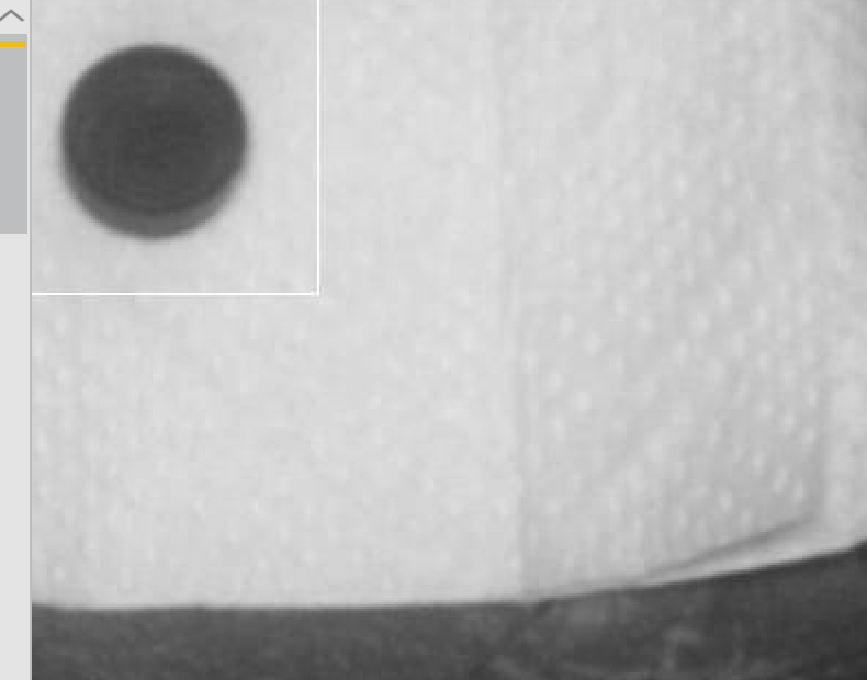

With the backlight panel the background is fully saturated white and the contour recognition works much better, of course. The results are very stable. Now, I just need to figure out how to implement the learn vs. compare commands and drive the output pins accordingly. Shouldn't be too hard. There are examples of how to poll and drive pins. But I've never coded python before.
Hmm, celebrated too early. Only slight changes to the lighting conditions can lead to the tip recognition to fail.
It locks to the step where the width changes instaed of the tip. I have to change the filtering.

find_edges()and theif row_stat.l_mean() > 10favors horizontal edges. If the tip is not rectangular but triangular (like a fish tail cutter or countersink) the algorithm focuses to false edges inside the tool shape. I'll try to extract a solid area instead of edges with Otsu's method.Bingo!
def find_tip_solid(img): global threshold # Run solid area detection on a copy of the ROI r = img.copy(roi=ROI) hist = r.get_histogram() threshold = (0, hist.get_threshold().value()) # Otsu's method r.binary([threshold]) # convert to black/white using threshold x0, y0, w, h = ROI for j in range(h - 1, -1, -1): row_stat = r.get_statistics(roi=(0, j, w, 1)) if row_stat.l_mean() > 10: return y0 + j return NoneMy biggest problem was to try to make up python code by trial and error. I thought this was easy because of the syntax highlighting editor of the IDE spotting every mistake I make. But it wasn't. The python interpreter crashes without warning if I pass parameters to a library function of which the data type doesn't match the expectations. The parser of the editor can't warn because it has no idea of data type until the code is executed.
... and searching top-down instead of bottom-up still works with some dirt on the screen.
Maybe I should use erode() and dilate() to eliminate smaller dirt particles and call find_blobs() and throw an error if more than one blob is detected.
