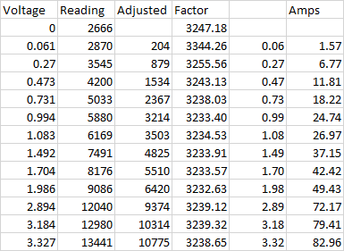

    This is a table of the results. The output reading jumps around so did not get a stable value to use.
    Will have to average the numbers somehow or maybe just divide by 10.

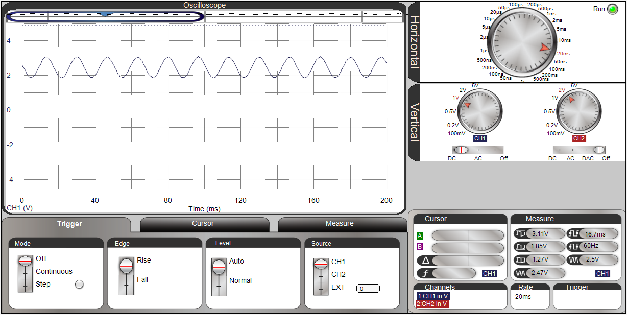

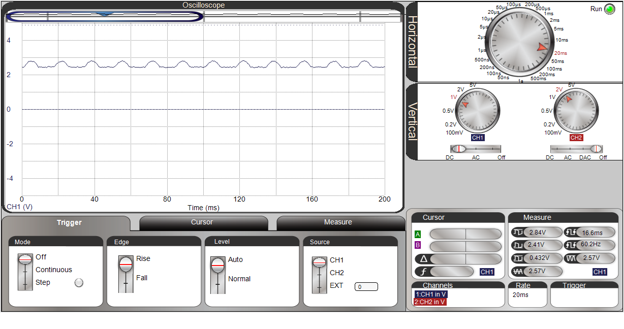

    I did some testing with a Hair dryer since that what I could find. The unit is rated at 1500 watts so should be able to come up with a number since I don't have a real amp meter to clamp on. May have to get one.
    Using my handy PropScope with the hair dryer at 50% I get this output
    I see that it is only giving me 50% of sine wave with a peek value of 2.85 volts. 2850mv - 2500mv = 350mv divide by 40mv = 8.75 Amps or 6.187 Amps RMS.
    At full power I get this output
    Now I get a sine way offset by the 2500mv. With a peek reading of 3070mv - 2500mv = 570mv divide by 40mv = 14.25 Amps or 10.07 Amps RMS.
    Since I don't have an Amp meter 1500Watts / 120Volts = 12,5 Amps. A number in between the two values I got.
    Well at least I'm getting something. I just need to get my numbers to line up at this point. Don't see a need to measure every millisecond as the RMS value is based on the peak value anyway.
  • evanhevanh Posts: 17,178
    edited 2026-01-24 13:48
    @iseries said:
    ... Don't see a need to measure every millisecond as the RMS value is based on the peak value anyway.
    That's only true for power factor = 1.0 (ie: pure resistive load) and the supply maintains a pure sine wave. But since most loads are not pure resistive and the supply can be quite distorted, you can be sure that using peak as a stand-in for RMS will be wrong.
    PS: A nice feature of the Propellers is they can dedicate a whole core to real-time compute and not be burdened.
  • It looks like that hair dryer uses a diode to get the low heat setting.
    It's safe to assume that an EV charger will have power factor correction. It's a requirement.
    If you want to just measure the peak, I would suggest you measure minimum and maximum. The current would be calculated from the peak-to-peak value. That way you will avoid the problem of determining what the voltage for zero current is.
    Measuring RMS will result in much lower noise in the reading. If you measure peak, that value may be inflated by a few counts due to random noise in the ADC. If you are computing RMS, that inflated peak value will be averaged with many samples that are not inflated with random noise. So its effect will be much smaller.
  • iseriesiseries Posts: 1,531
    I have a few problems here.
    First with a DC current the unit seems to work just fine but with an AC current the flux is only measured in one direction so 50% of the reading are missing at low current.
    If the unit is only measuring current and not voltage should the conversion for current be used which is .35355 and not .7071 to get RMS. In either case the reading that are returned are too high at lower current values and about right at higher current.
    I used an inline current sensor on the hair dryer and see that at the low setting it uses 4.67 amps and at the high setting 10.74 amps.
    Running the test code, I get 9 amp at the low setting and 14.8 at the high settings. Even using a conversion to RMS these numbers don't match up.
    With too few reading it's going to be hard to come up with a conversion factor that I can use to calibrate the readings.
    edited 2026-01-25 20:31
    James will be correct. The two waveform screenshots you posted is telling you that the hair drier is using a single rectifying diode in half power position. The transducer is showing the complete current usage.
    That's a pretty shitty way to treat the AC supply but is certainly a cheap solution to get half power.

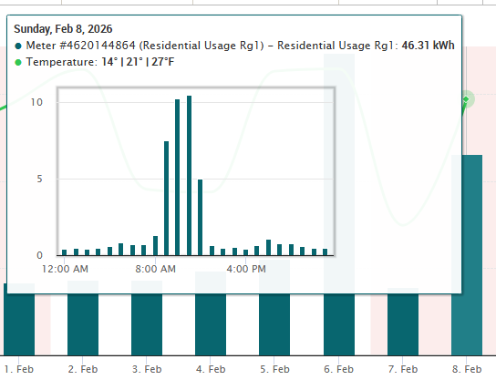

    I finally got around to doing a real test of the unit.
    The program works by determining the highest value every second and then sums that value every minute for display.
    I added two items to the display so every so often it displays the Current value, Time in minutes, and then the Total Power in watts.
    The charging session lasted about 192 minutes and showed I used 28,800 Watts.
    The car showed I added 32Kwh. My utility website showed I used about 29Kwh.
    Utilities
    Not sure what value is correct here, but the numbers are close.
    In any case it looks like it cost me about $3.00 to add fuel to the car.

        _pinstart(POWER, P_ADC | P_ADC_1X, 13, 0); // enable ADC with
        h = 0;
        while (1)
            micro = _getus();
            while (_pinr(POWER) == 0)
                _waitus(5);
            h = _rdpin(POWER) - 2972;
            if (h > HighValue)
                HighValue = h;
            Wait2 = _getus() - micro;
    Some more fine tuning is needed but the results look good.
  • I don't really understand your timing strategy. You call _waitms(998), _waitms(1000) and waitus(5) at some point but the variables Wait and Wait2 are set but never used.
    I think, it is essential to take multiple samples over one full AC cycle (16.6ms for 60Hz or 20ms for 50Hz depending on where you live).
    Averaging over several samples taken at 1s intervals might pick up nothing at all if you accidentally catch the zero crossings where the current is always zero. It might work in spite of that but it depends on good luck.
    If you take 100 samples equally spaced over 100ms and calculate the average then it's guaranteed to work for both 50 and 60Hz. Min/Max is no good strategy because a single spike caused by noise could result in a false reading.
    Wait1 and Wait2 are just to see what the time looks like running through the code. Not used for anything.
    AC and DC are based on peak readings. The difference is for AC to calculate the RMS value which is .7071 time the peak voltage of the device.
    Taking multiple reading of the sine wave would mean I would have to calculate the RMS value some other way.
    The EV charger uses a constant draw of power while it is charging. There should be no spikes.
