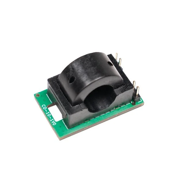

    The unit I am looking at is CTS-CS-CAX-10-050. This unit require 5 volts to power it and returns a voltage based on current flow. Not sure how this works.

    I finally got the unit in and started testing only to find out the starting voltage of the unit 2.5 Volts.
    Looking closer at the spec sheet show that it does indeed start at 2.5 volts and goes up to 4.5 volts.
    That's out of range for the ADC and now I need to use a voltage divider to get the voltage into the 0 to 3.3 volt range. I also found out that I cannot use a pull down smartpin resistor in ADC mode. That would have made it easy to insert a series resistor inline.
    The spec sheet shows that the typical value for the load resistor is 25K with a min value of 10K. I decided to use two 10K resistors and divide the output voltage in half to make the calculation easier. Instead of 40mv per amp now I only get 20mv per amp.
    Hopefully this will be enough resolution to get an accurate reading of the power used.
    Maybe I could use a couple of series diodes to drop the voltage by 1 volt.

    Actually, putting the unit in the circuit failed. All my testing was using a DC source, and the EV uses 240 AC.
    Putting a scope on the unit with an AC source turns out it only shows the current in one direction, and it shows it as a hump as the voltage and current go up.
    Had to change the code to start another cog that just returned the highest voltage within the second. Hopefully this is the right value.
    Would hate to have to do some RMS calculations.

    I did some testing with a Hair dryer since that what I could find. The unit is rated at 1500 watts so should be able to come up with a number since I don't have a real amp meter to clamp on. May have to get one.
    Using my handy PropScope with the hair dryer at 50% I get this output
    I see that it is only giving me 50% of sine wave with a peek value of 2.85 volts. 2850mv - 2500mv = 350mv divide by 40mv = 8.75 Amps or 6.187 Amps RMS.
    At full power I get this output
    Now I get a sine way offset by the 2500mv. With a peek reading of 3070mv - 2500mv = 570mv divide by 40mv = 14.25 Amps or 10.07 Amps RMS.
    Since I don't have an Amp meter 1500Watts / 120Volts = 12,5 Amps. A number in between the two values I got.
    Well at least I'm getting something. I just need to get my numbers to line up at this point. Don't see a need to measure every millisecond as the RMS value is based on the peak value anyway.

    I have a few problems here.
    First with a DC current the unit seems to work just fine but with an AC current the flux is only measured in one direction so 50% of the reading are missing at low current.
    If the unit is only measuring current and not voltage should the conversion for current be used which is .35355 and not .7071 to get RMS. In either case the reading that are returned are too high at lower current values and about right at higher current.
    I used an inline current sensor on the hair dryer and see that at the low setting it uses 4.67 amps and at the high setting 10.74 amps.
    Running the test code, I get 9 amp at the low setting and 14.8 at the high settings. Even using a conversion to RMS these numbers don't match up.
    With too few reading it's going to be hard to come up with a conversion factor that I can use to calibrate the readings.
