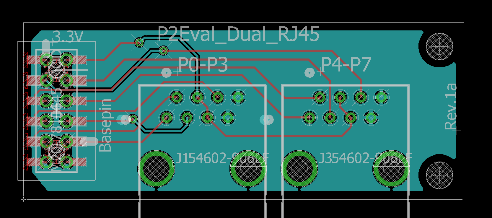

Designed up two new board to help the cause...
One is for breaking out the RJ45 pins and also connecting them to QWIIC connectors.
There are twin sides that can be connected by a solder switch matrix.
So could be an RJ45 jumper, or could be two separate RJ45 breakouts.

Feeling the need to extend this RJ45 interfacing to other boards that have Eval style headers.
So, getting some of these made. Each RJ45 uses four P2 pins, in the @refaQtor way...
