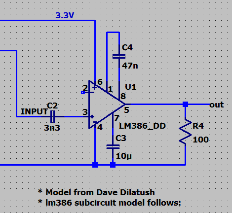

    As I don't have too many inductors lying here, I tried to design a simple load for the solar cell with low impedance for DC and 50Hz but high impedance for 10kHz.
    I had to free a breadboard and happened to find a LM386N-1 on it. - So Why not try this? It's 4-12V, be humble and swallow 3V3.
    At 1m distance I get -44dBV at 10kHz from the solar panel with 1k load.

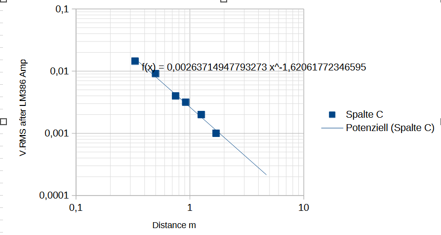

    Signal Strength after Amplification x200 per LM386 over distance. IR current about 5mA 10kHz Square Wave. 1.6V*5mA= 8mW.
    Solar Cell 50mmx50mm, 1k Load.
    At about 1,7m distance, the signal in the FFT vanishes in the noise.
    I had thought, that voltage should decrease with distance^-2 but it's only distance^1.6 . ???
    EDIT: Decrease with distance^2 is the rule for power, so my finding about voltage is plausible, I think.

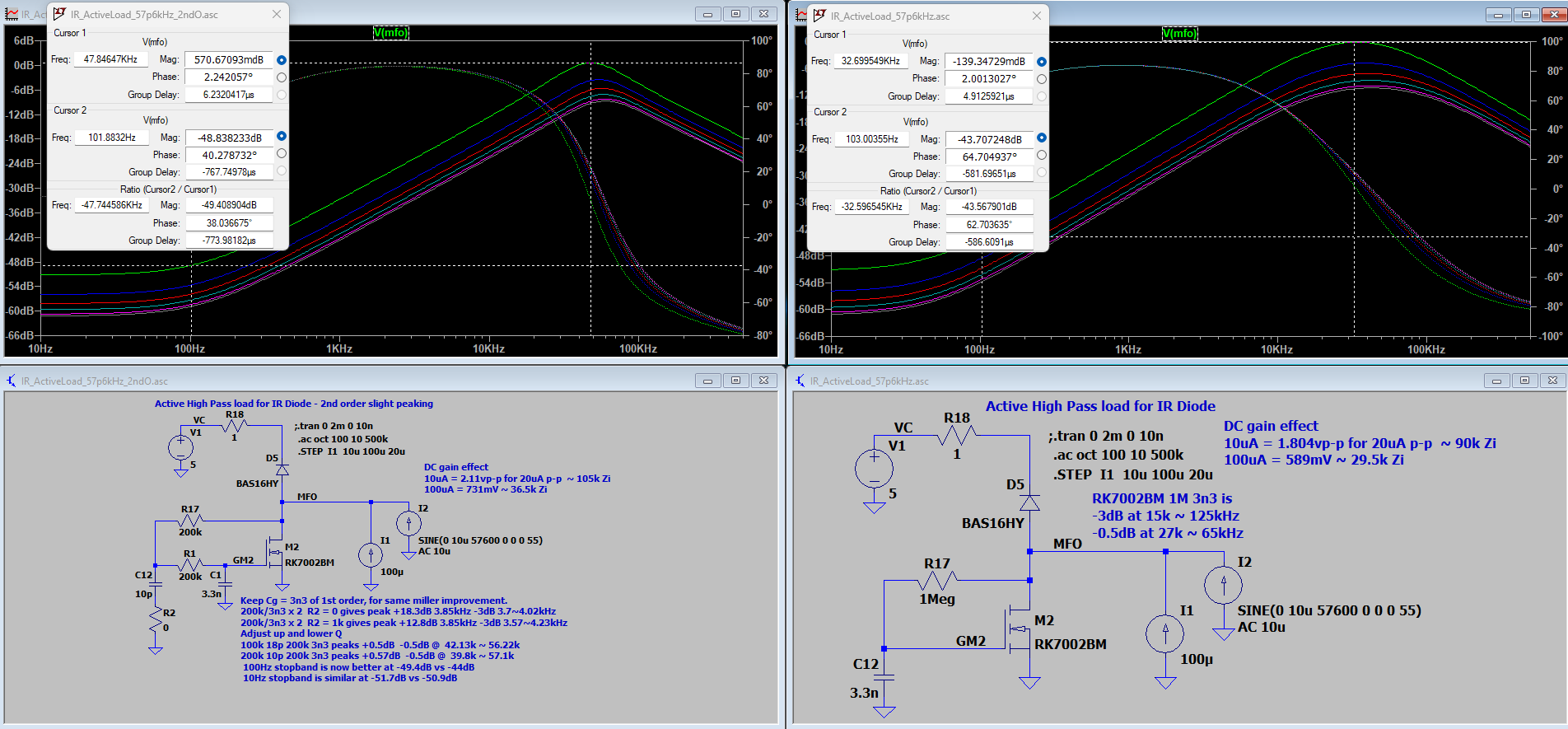

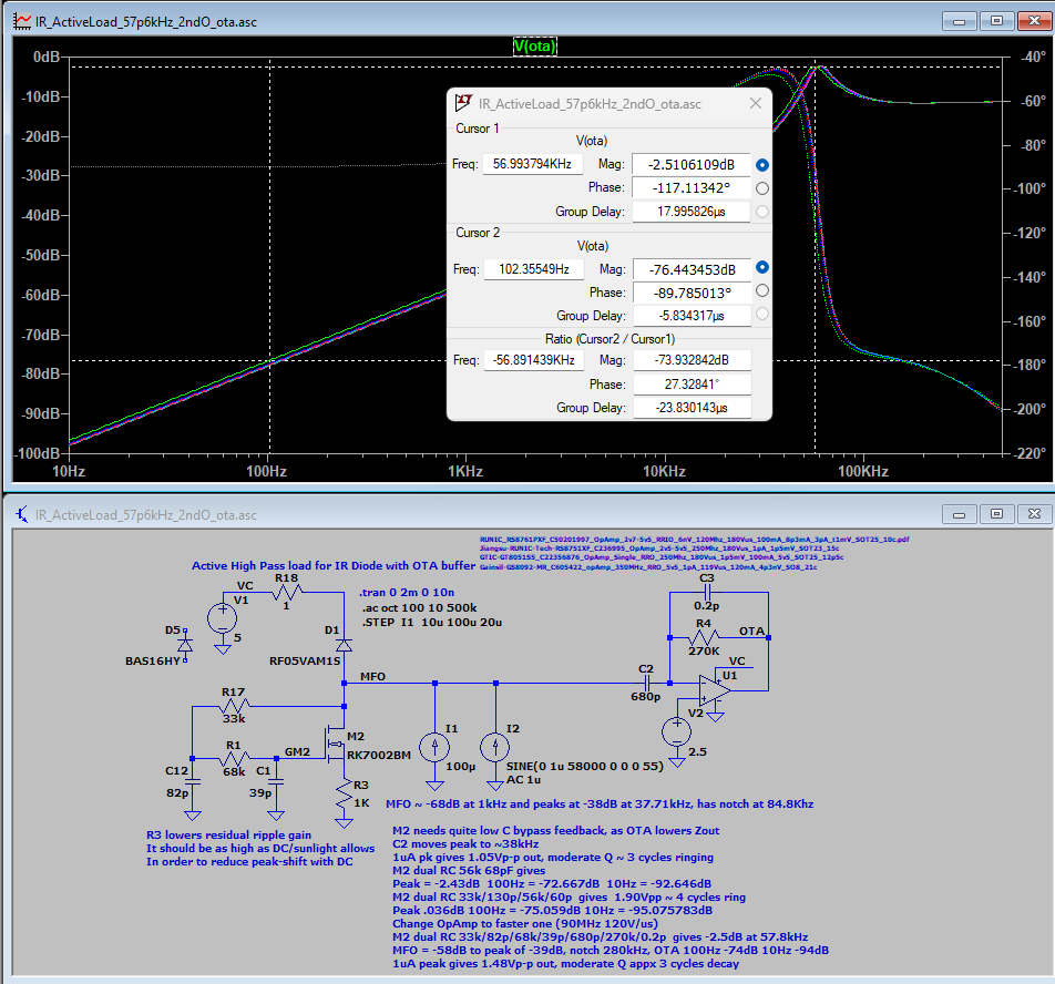

  • jmgjmg Posts: 15,200
    edited 2025-12-17 21:03
    @"Christof Eb." said:
    Hm, needed a while to grasp this. High pass filtering would be done in a second stage. Can't think of a version with integrated high pass. Problem is, that DC and 50Hz from lamps are very much more power than the IR sender.
    Yes, often an active load is used for the photodiode, that can provide 'static' DC~100Hz bias, but that gives a high impedance at IR frequencies.
    Here is an example, where I1 is sunlight and lamps, and I2 is the wanted signal.
    Addit : Plot updated to 2 choices, 2nd order feedback and tweak for slight improvements. Better 100Hz~1kHz rejection

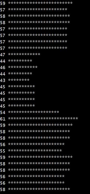

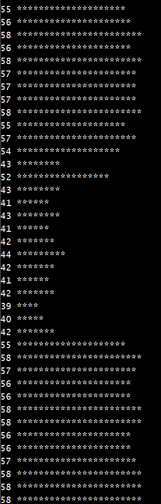

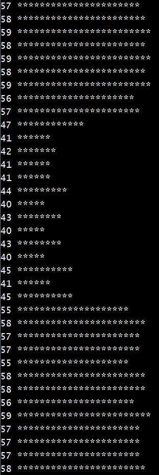

  • interesting discussion on frequency detection of optical signals... But, let me throw in what came to mind when reading the post subject, as I, too, have been scheming a dead simple system for distinguishing frequencies using cheap (cadmium di-sulfide?) photo-resistive cells. I found myself up in the frequencies of visible color light... and using the difference in the values of light coming through colored filters - green and yellow, in particular, to distinguish live/dead grass. I had very promising results just taping together a little handheld rig with two photocells and filters side by side and cheap analog volt meters on each... the needle swing was remarkably (that's why I'm remarking on it :) ) pronounced and encourages me to keep on that approach when I dig the project out again and the grass appears in the northern hemisphere.
    So, if colored light in the corners is an option you might consider something like that... imagine 4 photocells behind 4 primary color filters at the back of a 10? cm black plastic tube (black tube, as well as length and narrowness, aid directional precision) . This 4 filter scheme is one I use in a custom Non-Dispersive Infra-Red (NDIR) engine exhaust gas detector (2 gasses, 1 H2O, one reference). Anyway, lots of NDIR algo resources with that scheme, if you need.
    use the same color filter plastic over the light sources themselves probably increases distinction.
    actually, that grass detection scheme I was aiming to build out entirely analog... no micro at all, potentially.
    Thank you, this is very interesting!
    Christof

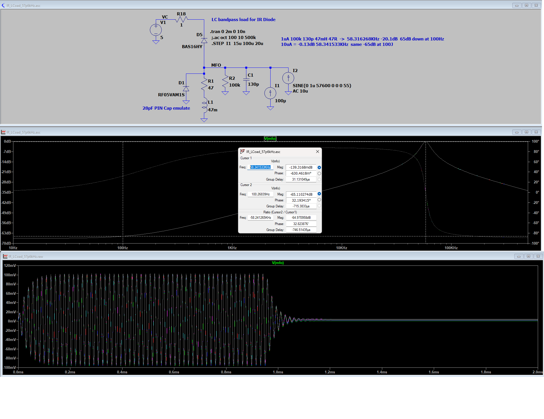

    @ManAtWork said:
    How about this?
    The capacitor couples the HF component of the signal to the opamp input while the inductor shorts the DC component.
    Direct sunlight has to be shielded and filtered optically. There is no way you can supress that electrically since the intensity is many orders of magnitude higher.
    Yes, that can work.
    In practice it has limitations
    • Inductor tolerance shifts the bandpass
    • Damping R is needed to avoid very high Q (moderate damping R2 shown below)
    • Inductor can now pick up stray magnetic fields.
    • low pass rejection is limited by inductor resistance
    • Inductor for IR carriers 10's of kHz is larger and not cheap
    • GM is lower than active load, due to LCR combinations. (lower mV/uA out)
    One plus, it is is very frequency tolerant of DC currents.
    If you compare the plots above, there is slight change in GM and peaks with DC/LF shunt current, as the shunt fet moves its operating point slightly.
    here is a frequency and time domain plot, showing the ringing effect of moderate Q, needed for data modulate.
    I actually had these problems: The inductor did indeed pick up "something". And the inductor 2.2mH, (that I happened to have and that looks as if it could cope with the solars cell's DC current) did not yield enough impedance at 10kHz.
    At the moment my feeling is, that my setup with that solar cell "should work", as I can push up sending power. If it was able to receive 8mW at 1,7m, then I would need (15m/1,7m)^1.6*8mW= 260mW. (??)

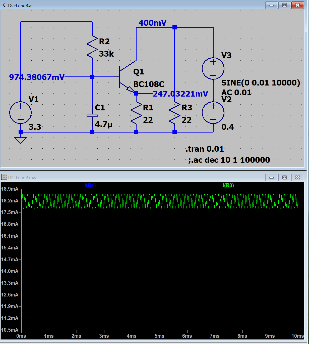

    There must be some rule about the S/N ratio of the carrier (10kHz here) and the bandwidth of the transmitted information? I even don't know how the level of noise is defined.
    Yes, there is a trade off.
    You can pick a very high Q, and get very good noise rejection. (you need to ensure the resonant freq equals your transmit freq)
    The trade off is, high Q means more ringing, and slower decays so modulation speed has to be slower.
    The plot above has that in picture form. You can see the frequency domain peak, and the time domain slow decay that results.
    There were high Q tuning fork resonators used for tone call radios, FWIR 500Hz-2kHz with 100's ms ringing times. They would trigger on tones well into the noise.
    Thanks for the input. If I define V.RMS when the sender is off as the "noise level" = 13mV, then a level of 5mV.rms after FFT is also "well into the noise".
    I use a microcontroller to generate the sender frequency. (What a waste) So the sender frequencies are very well known.
    (Seems also, that I could learn a lot about LTSpice from you....)
    I will now have to focus onto ADC-sampling and do Goertzel software filter + averaging.
    Cheers and thank you!
    Christof

    So now got adc sampling and software Goertzel filter for single frequency 10kHz running.
    For now:
    Sampling at 31250Hz, buffer length 500, => sampling of 20 buffers takes 320ms
    A triangle window and software Goertzel applied to each buffer, then average over the 20 buffers.
    Sample + window + analyse together takes 450ms
    Numbers are dB of magnitude.
    The picture shows at about 57dB the received signal and at 45dB the signal when the line of view to the sender is cut.
    Signal is from IR diode on/off 30mA at 1,7m distance. Room is mainly lit by my monitors.
    Reducing to 10 buffers and thereby reducing time to 225ms looks like this:
    When I switch off one of my monitors the picture looks like this for 20 buffers:
    I think it is not the light from the monitor but something transmitted via Aether.
    So all in all the method to receive a 10kHz IR signal with 50mW at 1,7m distance works but needs ~0,5sec for one magnitude.
    edited 2025-12-23 00:25
    Here is a further variant, with an OTA load, which presents a low impedance to the photo device, so makes the Sensor Cp have less effect.
    A higher IR carrier is chosen to allow easy swap/compare of a custom design with the faster all-as-one Vishay parts, and to give highest 10-100Hz rejection
    Compared with #14, the variation with gain & peak with dc injection is reduced. The f(peak) is tuned for least change with DC-I
    .asc renamed to attach
