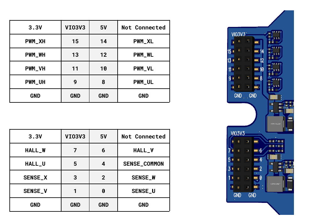

Hello. I have the new Universal motor driver 64010 Rev B. I have looked over the UniversalMotorDriver P2 add on guide-V.1.1. I am trying to get it running. I have used the HB-25 motor control and I love it. But as soon as I find something I like it is no longer available. I wright simple code for the HB-25 and it works like fantastic. Is the Universal motor driver 64010 Rev B anything like the HB-25???? Where do I input the PWM to what pin??? There are 15 input pins with no pins. Could someone take me by the hand and show me where the pins are to input the PWM (plus with modulation). I have already found the ground pin. Can I use the same code that I use to run the HB-25 on the Propeller 1 (one)?? Is there a demonstration video some where out there??? Or some other paper work that I do not know about?? Thank you very much for any help in this matter. 18nov2025(tue)

  • Hello . Still need input for the Universal motor driver. The blue print with the pin output it is not a mach for what is on the circuit board. The blue print for the connections do not show the pin out for the integrated circuit. What pin do I hook up the pulse with modulation input to is it pin 1 through 15??? I am trying to down load a pitcher but no can find the paper clip for attachments

  • Hello. Thank you for all your inputs. Rayman in your pitcher #11 what is the device in between the microcontroles and the universal motor driver??? Are the two black rectangle things with twelve square holes in each ( total 24 little square holes ) the input for the pulse with modulation. I do not want to buy the in between device to make it work. If so what Square holes do I input the pulse with modulation into. The blue print do not show the pin out on any integrated circuit on the universal motor driver. Stephen Moraco I went to your sight ( BLDC motor driver repository ) I clicked on a few things and can not get it to work? If I do not know where to hook the wires into the the universal motor driver then the driver is no good to me. I do not want to guess and burn something out at 80 dollars a pop for one driver. Thank you for your time 11dec2025(thur)

    The information you are probably looking for is hidden in the schematic:
    "IO+3" means that depending from the start pin number there is an offset of 3, if you plug this board into one of the connectors of the parallax P2 adapter. The choice of connector defines the absolute pin number.

  • Hello. I an using the Propeller one ( 1 ). I have used only 30 percent of the Propeller one capability's. Still learning the spin language and it is the only language I know. If you look at Christof Ed post # 15 the top pitcher pin out starts at pins 1 - 12 on the blue print. The bottom pitcher has the same number 1 - 12 . The universal motor driver pitcher shows the pin out the top pin 15 - 8 and the bottom pins as 7 - 0??? The universal motor driver blue print douse not mach the pins on the driver board it self. 18dec2025(thur)
  • Hi,
    The problem is, that you do not know for sure, which connector is j100 and which is j102?
    I would measure resistance to the hall connector to find out for Hall_V.
    There is also a picture in the product guide side by side.
    You are aware that the new motor driver needs completely different signals from the Microcontroller than the old one?
  • H @Iguanaman
    I meant that picture:
    Does this help to answer your question?
