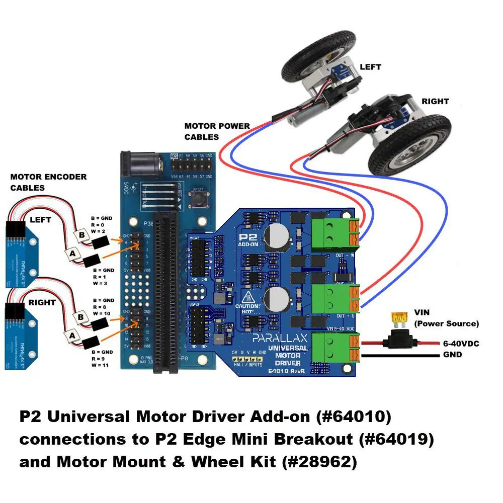

  • RaymanRayman Posts: 16,100
    Using this to drive Parallax motors.
    Hooked up just like in this image from product page and works...
    Haven't wired up encoders yet though...
    1000 x 1000 - 143K
    Ha! I'd forgotten about that helper diagram; feels like many moons ago I did that!
    Big thanks for bringing it up ; it shows perfectly how I had the Arlo wired in the above linked demo & code in a much better way than words could manage!
    Hopefully that's going to help Iguanaman figure out a working solution. Curious to see what gets created.
  • Hello. Thank you for all your inputs. Rayman in your pitcher #11 what is the device in between the microcontroles and the universal motor driver??? Are the two black rectangle things with twelve square holes in each ( total 24 little square holes ) the input for the pulse with modulation. I do not want to buy the in between device to make it work. If so what Square holes do I input the pulse with modulation into. The blue print do not show the pin out on any integrated circuit on the universal motor driver. Stephen Moraco I went to your sight ( BLDC motor driver repository ) I clicked on a few things and can not get it to work? If I do not know where to hook the wires into the the universal motor driver then the driver is no good to me. I do not want to guess and burn something out at 80 dollars a pop for one driver. Thank you for your time 11dec2025(thur)

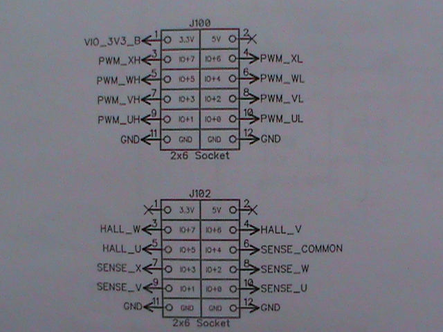

    The information you are probably looking for is hidden in the schematic:
    "IO+3" means that depending from the start pin number there is an offset of 3, if you plug this board into one of the connectors of the parallax P2 adapter. The choice of connector defines the absolute pin number.

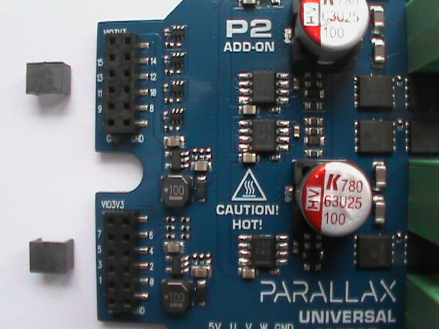

  • Hello. I an using the Propeller one ( 1 ). I have used only 30 percent of the Propeller one capability's. Still learning the spin language and it is the only language I know. If you look at Christof Ed post # 15 the top pitcher pin out starts at pins 1 - 12 on the blue print. The bottom pitcher has the same number 1 - 12 . The universal motor driver pitcher shows the pin out the top pin 15 - 8 and the bottom pins as 7 - 0??? The universal motor driver blue print douse not mach the pins on the driver board it self. 18dec2025(thur)
  • Hi,
    The problem is, that you do not know for sure, which connector is j100 and which is j102?
    I would measure resistance to the hall connector to find out for Hall_V.
    There is also a picture in the product guide side by side.
    You are aware that the new motor driver needs completely different signals from the Microcontroller than the old one?
  • H @Iguanaman
    I meant that picture:
    Does this help to answer your question?
  • This board was built to drive BLDC motors directly and is not like the HP-25 that drove the motors for you.
    You're going to have to do everything that the HP-25 did by hand. This board will not do anything that the HP-25 did.
    On the picture above there are 8 pins labeled XH/XL, WH/WL, VH/VL, UH/UL. These pins control the output voltage on X, W, V, and U.
    You will also need to supply 3.3v and GND to power the board.
    On the other side you have VDC and GND. This is what will power the motors.
    On the P1 side you will have to pick 8 pins that you will set low and plug them into XH/XL, WH/WL, VH/VL, UH/UL.
    To drive one motor, you would pull the pin attached to XH high and WL high. This will apply VDC to X and GND to W causing the motor to turn uncontrollably. If you apply a pulse (PWM) to XH you can control the speed of the motor. You could also apply a pulse to WL instead of XH.
    Do not make any of the H and L pins high at the same time as the output cannot be both VDC and GND at the same time.
    Now to make the motor turn the other way you need to make XL high and WH high and XH would be low as well as WL.
    The motor encoders will also have to be done by hand attached to 8 input pins on the P1.
    In total you will need 16 pins to make this work.
