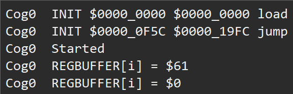

    Well, when I scope probe QD1, I do see data, but the SPI driver isn't returning data. I am going to throw the logic analyzer at this and see what's really going on with all of the pins. Based on the datasheet, I should send 3 bytes, all zeros, for it to be set to pull the chip version number, then read a dummy frame, and then I should get valid data.
    Instruction byte:
    bit 7-6 : 00 is single SPI mode
    bit 5 : 0 Read Access
    bit 4-0: 000_00 Common Register (Where the chip version lives)
    Address bytes:
    $0000 - This should be the address of CIDR0, the major ChipID.
    Read phase:
    Clock a dummy read byte.
    Clock a byte to get $0000 value (Expecting 00)
    Clock a byte to get $0001 value, (Expecting 61)
    All I get are $00 on the P2. Running the SPI in mode 0, which is valid for this chip.

    So, it looks like this was a hardware problem. The 1.2V had a low resistance on C4 and was causing the Wiznet to fold back and reboot. I am guessing this was solder that didn't fully melt or some debris made it's way under that component. It was showing shorted to ground. Luckily I only had to remove two caps to find the problem. Swapped out the Wiznet just to ensure it wasn't damaged. Now I can read what I expected!! W00T! Spent way too much time on something stupid. I want one of those PickSoEasy PSE-3000's. This stuff is microscopic!
  • ke4pjwke4pjw Posts: 1,250
    @evanh I guess I didn't understand before about the clock being on an adjacent pin to the data. It's not the first expensive mistake I have made :) I must admit that I really don't understand either the streamer or the various smartpin configurations. I didn't think it could be used to clock in nibbles. Currently I am using Jon's bit bang SPI driver (jm_spi.spin2).
    I will review the various smartpin configurations to understand what I should do for the next iteration of the board. I might be able to easily bodge the trace for my own use. Your idea of jumpers was a good one. I appreciate your suggestions!
