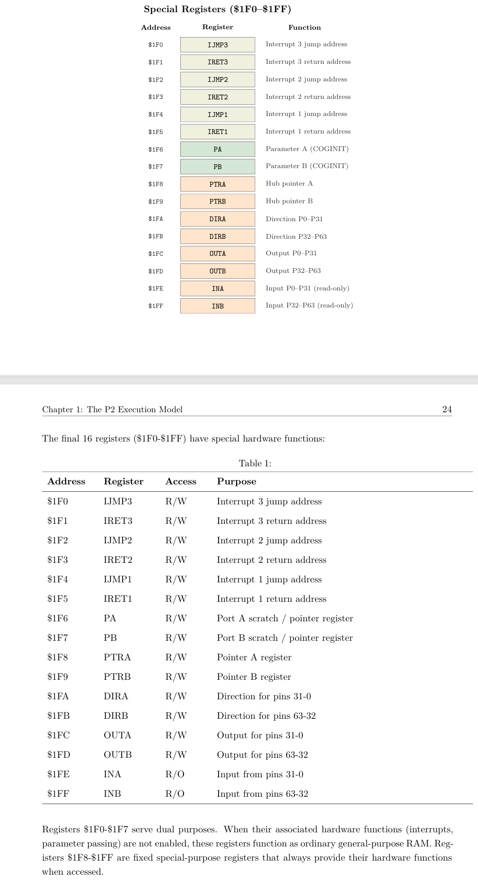

    • All instruction tables have the C, Z and Result columns mixed

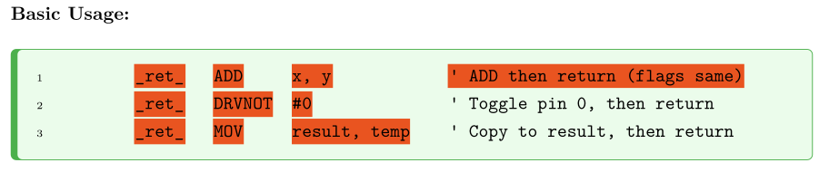

  • @"Stephen Moraco" said:
    @macca Ok, it seems that if what I'm learning is correct, I'm unable to do copy buttons that support all PDF viewers. Adobe Acrobat would be supported through a JavaScript approach, but macOS Preview and other tools won't work, and its PDF internal scripts are generally blocked by security...
    That's not what I mean. I think it is a matter of how the code blocks are translated to PDF.
    I did a bit of digging through the source files.
    This is the original code block, which is good.
    **Basic Usage:**
    ```pasm
            _ret_   add     x, y            ' ADD then return (flags same)
            _ret_   drvnot  #0              ' Toggle pin 0, then return
            _ret_   mov     result, temp    ' Copy to result, then return
    The PDF generator translates it to what seems a table with columns representing the indentation.
    In the image above I tried to select just the first row but also selected the columns below, and all indentation spaces are trimmed.
    What I was expecting is the code block to be translated verbatim so it can be selected.
    I was going to try to suggest something, but I see that other documents suffer from the same issue (PropellerManual and also HydraGameDevManual), maybe it is a limitation of the PDF format or the translation (I think it skips the spaces entirely and prints just the text at the expected column). I used iText to generate PDF documents several years ago but I don't remember the details.
    If not possible, a separate archive would be fine.

    Stephen, You seem to not read, what I write. I already had pointed you to the fact, that mul is not 32x32 in August.
    I still do not understand, why you print the exactly same table twice following each other????

  • When I run the fetch-kb-file.ps1 in powershell I get the following error:
    .\fetch-kb-file.ps1 p2kbArchCog
    .\fetch-kb-file.ps1 : A parameter with the name 'Verbose' was defined multiple times for the command.
    At line:1 char:1
    • .\fetch-kb-file.ps1 p2kbArchCog
      • CategoryInfo : MetadataError: (:) [], MetadataException
      • FullyQualifiedErrorId : ParameterNameAlreadyExistsForCommand
    I tried it with various keys and get the same error. What do I need to do to run it?

    I apologize for not attending to your responses. I've had really full days, but this is not an excuse.
    When we draft documents and convert regions of them into visual representations, it's common to accidentally leave a 2nd copy. It's not intentional. It's just incomplete editing. If this were done traditionally in-house, we would have multiple passes with reviewers and editors.
    Our experiment here is to ask for help from you and the rest of our community in locating these issues and reporting them. This is an attempt at crowdsourcing the reviewer phase of our document creation. Does this make sense?
    Your feedback is invaluable. I will incorporate it!
