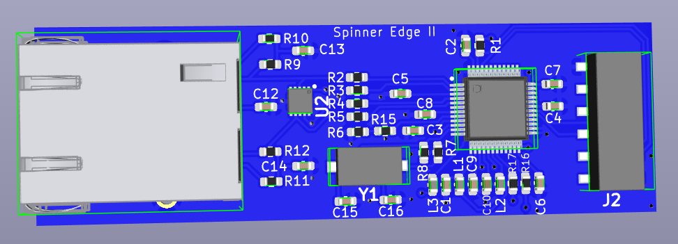

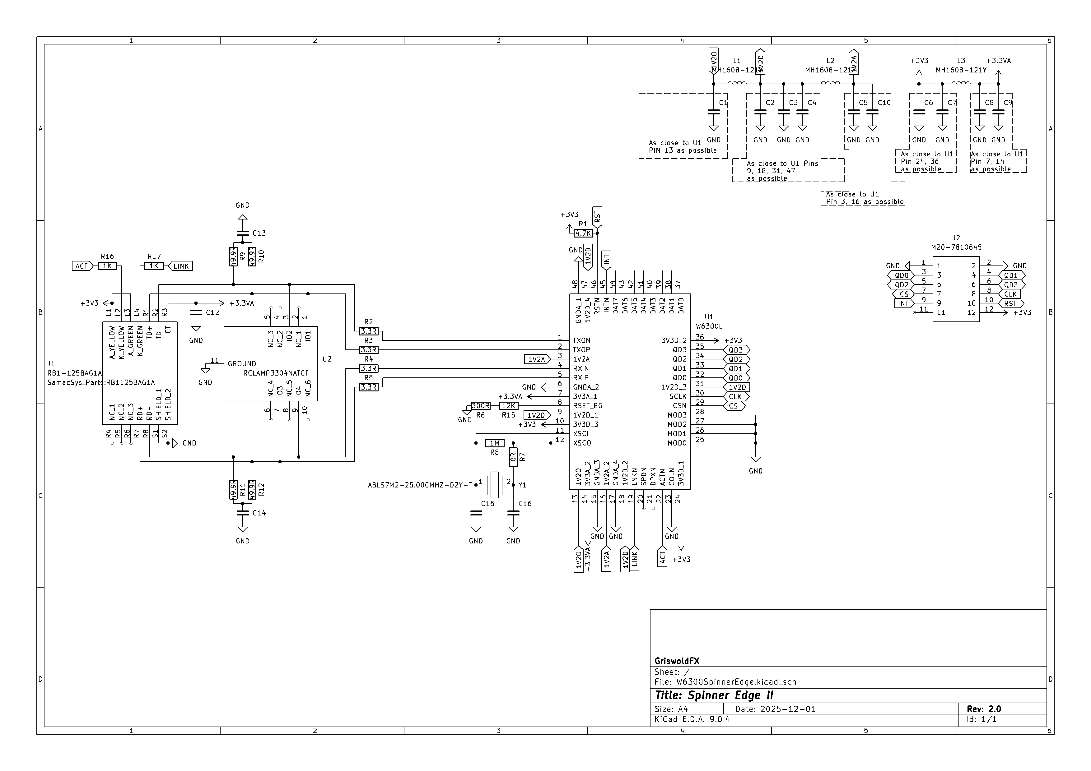

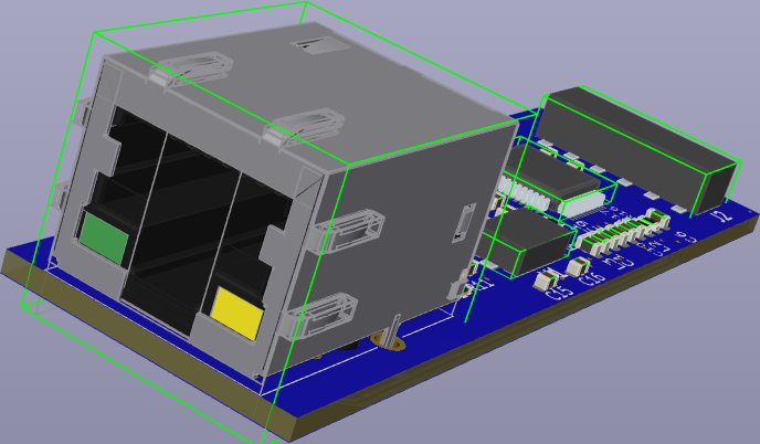

  • So I have started on the Spinner Edge II with the W6300. Wiznet sent me some samples. I have a couple of the raw ICs and I also have 2 of their RP-2350 based boards. (Too bad I can't figure out what tools are needed to program them)

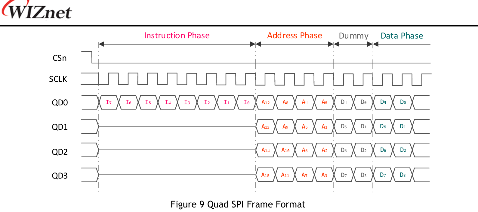

    I will only implement QSPI on the SE II, as that is what they recommend for best performance. (I really want that 90Mbps)
    Below is my (only checked over once) schematic. @evanh take a gander at the Quad SPI frame format. Is that unusual? Should I choose better CS and CLK pins? I think it would be helpful to have the nibble on a valid boundary to shift out data. I am not sure how or if those bit twiddling gymnastics could be performed by a smartpin.
    Please feel free to throw rocks. If there is going to be a problem, I want to know about it up front.

    Given that the instruction phase is sending 8 bits on QD0 with QD1-QD3 as don't care you can still make use of the streamer to send it all out in a contiguous block. You just need to distribute the 8 "I" bits into the streamed command - the MERGE instruction would let you group 8 bit instruction into nibbles and send it out with the LSB sending the data (although you'd need to reverse the 8 bits beforehand to send MSbit first, unless you setup the streamer to do the reordering). You'd first stream the instruction then the 16 bit address and 8 bit dummy and the real write data for writes, or for reads turn the bus around to read it back during the dummy step. Timing is everything but it's all doable. You need the nibble aligned on a 4 pin boundary if you use the streamer for highest performance. Other control pins can be anything. The clock would be generated by a smart pin and be some multiple of the P2 clock period. A 200MHz P2 could read up 100MB/s for example, although you can do it slower at 12.5MB/s and that still supports 100Mbps transfers.

    The boards and all the parts have arrived. Hopefully I will have some time tomorrow night to make a couple of them. If anyone is interested in helping me develop a driver, PM me.
  • Well, it's real. It gets link and activity, so I can assume the oscillator is running. I can also pull P7 low and it will reset. (Loses link and comes back when expected)
    Now I need to figure out how to do more than poke it with the proverbial stick :)
    Oh, also, the V1.0 datasheet was wrong. They had pin 10 as 3v3A. This did not match their example boards. I raised the issue in email, online forum, etc, with no response. I checked yesterday, and the V1.0.1 datasheet was created on the day I reported the problem. Glad I went with their example in my layout and not the datasheet.

  • Well, when I scope probe QD1, I do see data, but the SPI driver isn't returning data. I am going to throw the logic analyzer at this and see what's really going on with all of the pins. Based on the datasheet, I should send 3 bytes, all zeros, for it to be set to pull the chip version number, then read a dummy frame, and then I should get valid data.
    Instruction byte:
    bit 7-6 : 00 is single SPI mode
    bit 5 : 0 Read Access
    bit 4-0: 000_00 Common Register (Where the chip version lives)
    Address bytes:
    $0000 - This should be the address of CIDR0, the major ChipID.
    Read phase:
    Clock a dummy read byte.
    Clock a byte to get $0000 value (Expecting 00)
    Clock a byte to get $0001 value, (Expecting 61)
    All I get are $00 on the P2. Running the SPI in mode 0, which is valid for this chip.

  • evanhevanh Posts: 17,055
    edited 2025-12-15 04:40
    Sorry, I didn't see your request for help. The pin order you've chosen for 4-bit wide suits the streamer, not smartpins. I would have recommend using the streamer for 4-bit anyway. It is a little tricky but you get benefits for the effort. But we'll get to that after having success with 1-bit SPI mode first.

    PS: A pin order that could have done both streamer and 1-bit SPI would be:
    base+0  RST
    base+1  INT
    base+2  CS
    base+3  CLK
    base+4  QD0
    base+5  QD1
    base+6  QD2
    base+7  QD3
    That places CLK pin right next to QD0 and QD1 to assist smartpin routing, and it keeps the data pins in order on a 4-bit boundary to suit the streamer.
  • So, it looks like this was a hardware problem. The 1.2V had a low resistance on C4 and was causing the Wiznet to fold back and reboot. I am guessing this was solder that didn't fully melt or some debris made it's way under that component. It was showing shorted to ground. Luckily I only had to remove two caps to find the problem. Swapped out the Wiznet just to ensure it wasn't damaged. Now I can read what I expected!! W00T! Spent way too much time on something stupid. I want one of those PickSoEasy PSE-3000's. This stuff is microscopic!
  • @evanh I guess I didn't understand before about the clock being on an adjacent pin to the data. It's not the first expensive mistake I have made :) I must admit that I really don't understand either the streamer or the various smartpin configurations. I didn't think it could be used to clock in nibbles. Currently I am using Jon's bit bang SPI driver (jm_spi.spin2).
    I will review the various smartpin configurations to understand what I should do for the next iteration of the board. I might be able to easily bodge the trace for my own use. Your idea of jumpers was a good one. I appreciate your suggestions!
