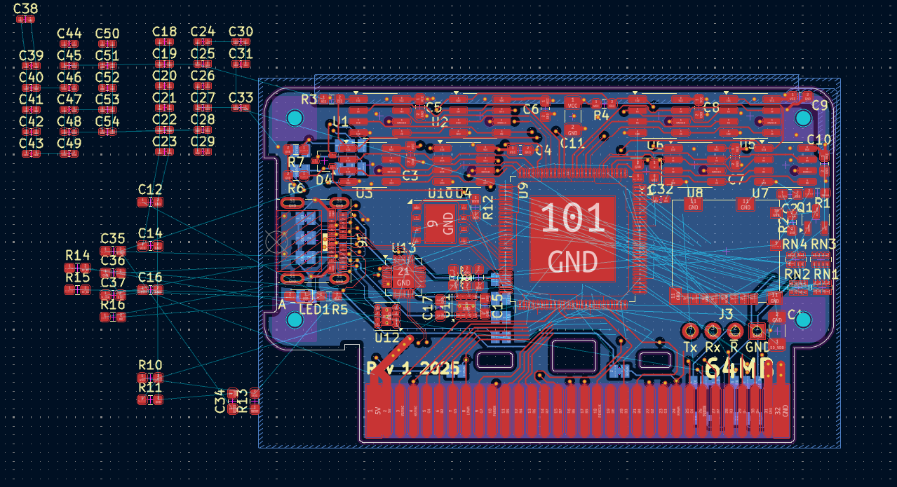

If I do make another variant I think I could put the P2 on the top surface of my FireAnt P2 board with a single sided load. When I measured the inside of the case this leaves about 6mm from the PCB top to the inner top edge of the cartridge. A 1.2mm P2, a 1.5mm AL plate and a 3mm fan would just fit. The fan would sit over the P2 and blow air down onto the plastic case. Cuts in the AL plate would allow some airflow around the hot areas. Holes may need to be drilled above the fan in the case for intake/exhaust.
The only other way is to somehow route out the plastic case underneath the PCB for the P2 to sit exposing the ground on the top surface but it makes assembling the board very difficult with a double sided load, and I'm kind of wondering where all those bypass caps would go too. I'm still deliberating...

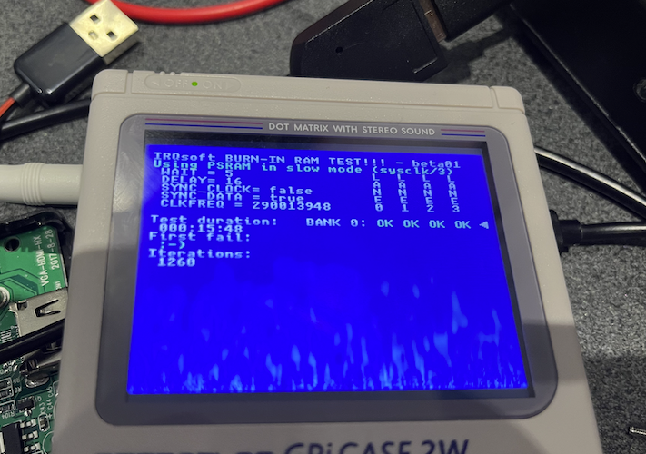

I ran the RAMtest slower just by setting CLK_MULTIPLIER to 12 instead of 14 (~290MHz), and it has already lasted over 15mins with no issues, with no fan no heatsink and fully sealed up in my intact case cartridge (not the earlier one with the huge cutout at the back). I'll stop it at 20mins open it up and quickly measure the temp it gets to.
Update: reached 20mins okay and I stopped it there yanking it out and quickly measured the P2 temp. IR thermometer showed a 68C peak and then was seen reducing after that as it cooled down. 20C ambient. So even though the P2 was as hot or hotter than in the earlier failures, the RAM was still good at this frequency...interesting.

UPDATE2: Also just ran that RAM test for 20mins fully enclosed with no cooling at a CLK_MULTIPLIER of 13 (314MHz) and it passed the RAMtest there too. I'd kind of expect equilibrium to be reached by then at this load but it may still be rising slowly - ideally I need to try to feed a thermocouple in there to see when exactly it tops out. P2 temp got up to 77C (wow it's cooking), room temp was 20C. What happens if the P2 gets too hot????

Just so you know what I'm working with. I've gotta find a home for all these bypass caps, now sized as 0402.
