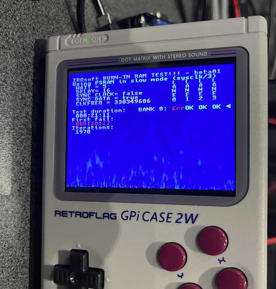

    @Wuerfel_21 I have ported your emulators to my updated HW and ran into some issue after loading screen. Screen changes and freezes and looks like this once MSLug gets loaded. I tried with 4 bit SD initially then backed off to original SPI mode but effect is the same. Using PSRAM timing same as edge but also tweaked up and down a few clocks without help.
    It did load up once the very first time and let me get into the initial in-game MSlug menu and played sound fx etc but locked up just before it would have started actual gameplay when I wanted to start it.
    Wondering if PSRAM settings might cause this, or actual overheating...?
    Didn't you have a RAM test app that ran when the other Cogs were running sprite stuff at rated game clock speed? That could potentially be useful to debug this issue.
    EDIT: wow the boards are HOT. Just took them out of the case to see how warm. Would be worth adding a thermocouple into the housing if I can fit it in while game is running. Even though my board is transferring some P2 heat too, I think an actual heatsink plate is going to be needed. :disappointed: Might also explain why it seemed to work the first time but not afterwards (once it had warmed up a lot). Also when I ran the memory test again now when things were warm I got worse values vs prior run.
    You did try tweaking the sync/async settings, right?
    Hard to decisively distinguish. But looks to me moreso like PSRAM fail rather than P2 core fail.
    That the screen changes when trying to boot is normal, on startup the menu fix graphics are kicked out in favor of the game's fix graphics.
    yes. Will need to drop the customized NeoVGA into this.
    Note that this doesn't just test PSRAM integrity, but is also really hard on the P2. If it doesn't run properly or locks up, that's a P2 core fault. Bad PSRAM only ever leads to red FAIL prints.

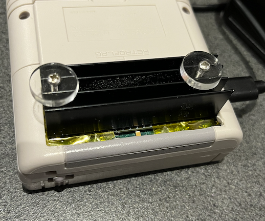

    EDIT: ... I think an actual heatsink plate is going to be needed. :disappointed:
    And now a whole other hand-warmer engineering exercise begins.

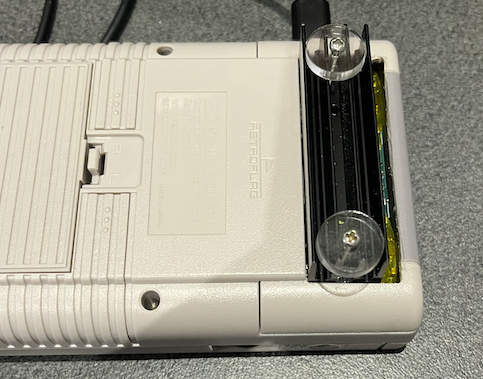

    If a suitable part is modelled, we could potentially then create a 3d printed metal backshell in the same profile as the plastic (or squeezes just under the existing plastic) and contacts the P2 - this would give a large surface area to spread/radiate the heat. But whether stainless steel is as good enough a heat conductor vs Al or Cu not sure.
    Existing cartridge shell looks like this inside. There's probably a 2-3 mm gap above the components on Lachlan's P2 board to the back surface, so enough room for a custom metal plate. It could also go though to the outside of the plastic at the back with fins in the worst case. But ideally it could retain the same external size for a cleaner look.

  • roglohrogloh Posts: 6,166
    Ran MSlug with the back open for over 8mins before it locked up. Temp started out at ambient 19C and then rose to ~64C on the hottest part detected by my infrared thermometer when pointing towards the P2. I think this is probably a thermal issue. I might try blowing air on it while playing and see how it behaves and whether it lasts even longer before failing, if it even does fail with that. I could also try to add a heatsink from a RasPi kit or similar as another test.
    This test was run with the slow PSRAM clock enabled (sysclk/3) and a 16 clock delay according to these config.spin2 settings.
    PSRAM_WAIT  = 5
    PSRAM_DELAY = 16
    PSRAM_SYNC_CLOCK = false
    PSRAM_SYNC_DATA = true
    ' \/ Uncomment for lameness
    #define USE_PSRAM_SLOW
    edited 2025-11-10 09:46
    @Wuerfel_21 , I was able to build your RAMtest app (with Flexspin 7.5.0) and got some video data on screen though no audio output (was there meant to be audio too?). I'd copied my working patched NeoVGA.spin2 and my config.spin2 settings file from NeoYume. I also tried setting _CLKFREQ to 128000000 and _XTLFREQ to 64000000 as the initial default in case it was starting out with bad values assuming a 20MHz XTAL instead of my 64MHz clock - I presume that NeoVGA will update the clock to the real frequency later anyway. Not sure if there's anything else I'm supposed to do that you know to make the audio work if there is meant to be some - code seems to show OPNAcog being spawned with playVGM stuff.
    Ran for a few mins
    2nd try once warmed up - failure seen right away and then locked up to black screen a few mins in. This was with that green heatsink on too.

    I visited @Tubular again last week and we did some thermal experiments with heatsinks and fans etc. With the green heatsink and small fan above, the RAM test survived fine for at least 15mins - we stopped the test there thinking it was okay. We also ran it without the fan but it did fail after just a few minutes. We then changed out the heatsink for a much larger black one (16x60x16.5mm, 8 degrees C/W) and I ran the RAM test today with that and it lasted about 12 mins before the first failure was observed. Temperature reached 47C on the heatsink in a 21C room temp. We are using thermal tape (the sort you use with SSDs in enclosures) to transfer heat to this heatsink from the P2. It's not an ideal clamping pressure (as I don't want to crush the insulated regulator components) but I do see that it does make some contact between the P2 and the heatsink.
    Based on these results it seems to me that a fan is pretty much needed to create at least some airflow to help remove the heat, or a very large/impractical heatsink is going to be required. We may look into a custom plate for holding a small fan over the P2 at some point next. The P2 at this overclock and PSRAMs just generate too much heat for a small enclosure like this without active cooling.
  • TubularTubular Posts: 4,761
    For sake of completeness, one thing we should still try is a heatsink with the fins oriented the correct direction, along the lines of the green heatsink you started with.
    But yes I suspect a tiny fan is going to be the best option going forward

  • After talking with Tubular today I ran the RAM test with the heatsink sideways so air would rise up along it and convect away more heat, and sure enough it lasted a fair bit longer with first RAM test failure at over 20mins. Same room temp 21C. Failure temp of heatsink around 47C max reported with my infrared thermometer - same as before as well. So any rear heatsink would be best with vertical fin alignment for optimal handheld use. Makes sense.
