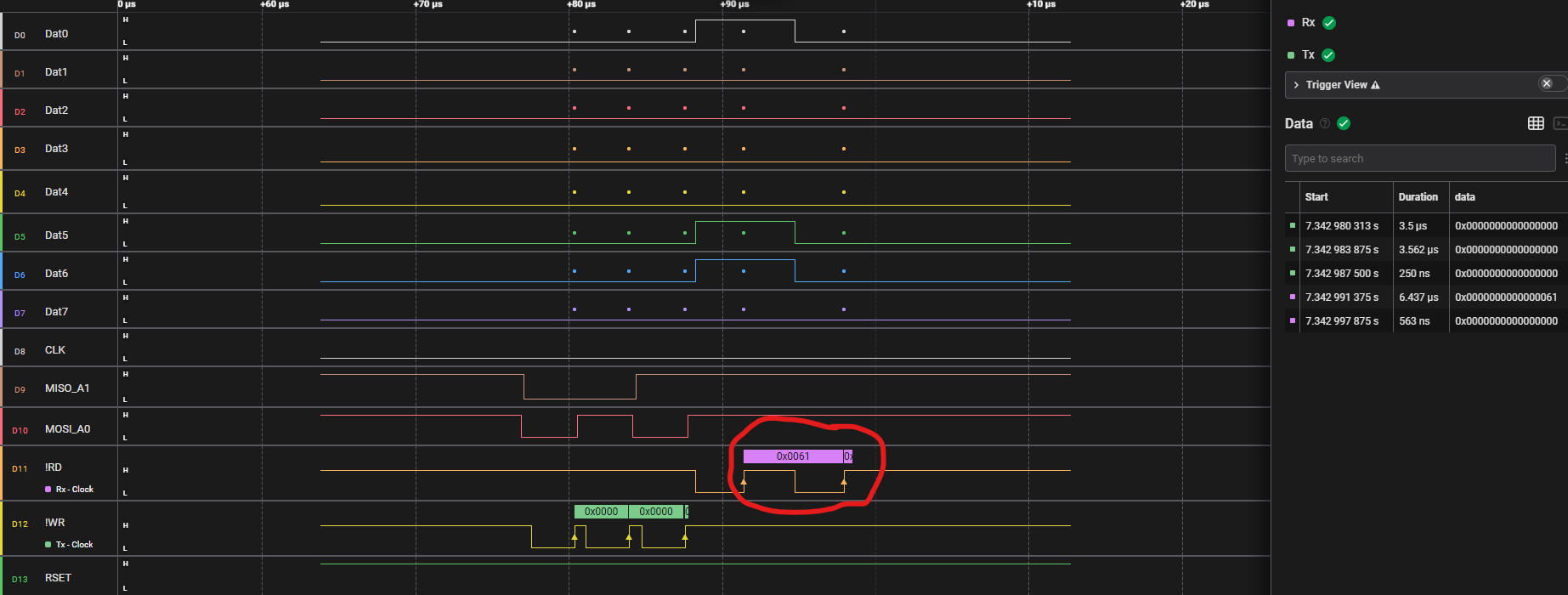

  • R BaggettR Baggett Posts: 229
    edited 2025-11-17 12:19
    Hi,
    I am trying to get this to work on a custom board. I wonder if there is any more solid information on what is needed for the parallel connection.
    I think I have it figured out, but not working and the signals I see seem a little strange.

  • Well, Clock wasn't it. It never toggles anyway, since I am using parallel comm. According to my capture, I think things are working perfectly until it is time to interpret the signals from the W6100.
    According to my monitoring of the digital lines, Attempting to start is working as far as this spot in W6100_Etherned1a.spin2.:

    At this point I see 3 zeros sent to 0,1,and 2 (Addresses via A0 and A1) the W6100, and then a read of $61, $00 from the W6100. This should be perfect..
    BUT
    debug says:
    Cog1 Chip Identification: $F7 $F7
    Cog1 Error: Wiznet W6100 NOT detected.
    I cannot think of any way to flip and invert the bits on the bus to turn $61,$00 into $F7,$F7, and I do not understand PASM well enough to make sense of what is going wrong.
    I have switched from the W6100drv from this thread to the one from the Spinner Edge repo, and changed the pin defs to match my board.
    What am I doing wrong?
  • RaymanRayman Posts: 15,841
    It might be DPINS is set wrong. Appears this is telling the code which byte on INA to use for data.
    The original had data bus starting at P24 and so DPINS was set to byte #3.
    See if changing DPINS to 0 works for you...
  • So that got me all the way to 'Cog1 Waiting for TCP request on Socket 1 port 80' which at this point seems to be total success.
    Think it does need to be multiple of 8.
    U r lucky did it that way.
    Although code could be changed if wasn’t …
    DPINS = DATA/8
    Was thinking same thing…
    One can also automatically handle the port being on PortB.
    Just divide base by 32 and add to ina…
