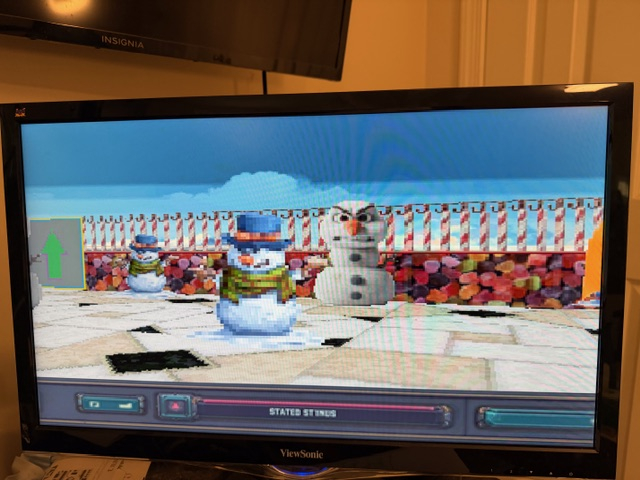

    Added a new snowman and a gumball & candy cane fence.
    Like how can now make the boundary walls partially transparent and see the background behind them. Think can only use this on the outer walls..
    AI is a big help with making the artwork. That's the part that is hard for me...
    Found that the keywords "pixel art" and "sprite sheet" helps make the low res stuff needed here.
    Wanting to get an actual playable thing going by Xmas. Think will start with stationary snowmen that through snowballs and player throws snowballs back.
    Just something simple to get points on the board...
    On the technical side, thinking that could easily have double resolution art for walls and sprites that is used when they are close. This increases demand on PSRAM a bit, but think that'd be OK. Right now, these things are drawn double pixelled when close. So, the size and P2 cycles need is basically the same for the close things in low res or high res.
    But, going to save that for another day. Sometimes simplicity might be better than visuals...

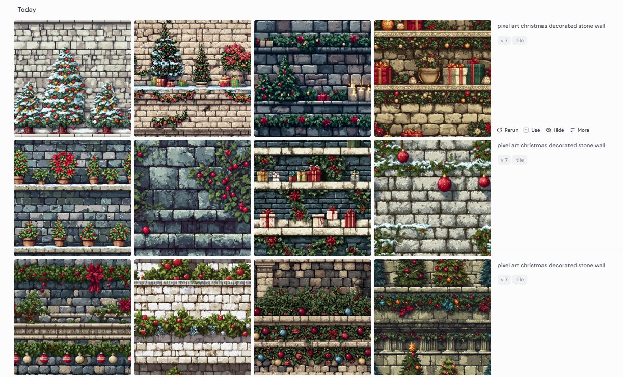

    Getting good walls in the theme from Midjourney...
    1223 x 742 - 1M
  • Neat, nice quick way to generate artwork for games. Do you need different mipmap levels for these graphics textures as well in your 3D engine and if so is that easy to generate yourself from an original higher resolution texture?
  • RaymanRayman Posts: 16,287
    The graphics are currently all 64x64. Could improve maybe in the future, but also nice to keep things simple...

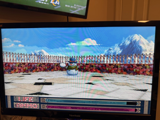

    It's close to being a playable game now.
    The snowmen can shoot snowballs.
    The player can also shoot.
    Have life and ammo status bars.
    640 x 480 - 218K
