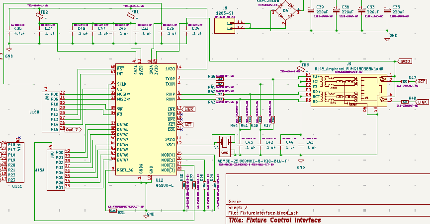

  • R BaggettR Baggett Posts: 233
    edited 2025-11-17 12:19
    Hi,
    I am trying to get this to work on a custom board. I wonder if there is any more solid information on what is needed for the parallel connection.
    I think I have it figured out, but not working and the signals I see seem a little strange.
    Here is my modification to W6100drv (I picked up my copy on this thread..):
      CLK   = 39'16
      'MOD   = 16
      'ADDR  = 18 ADDPINS 1
      RSET  = 12'RAB 23
      CSn   = 14'RAB 40'17
      RDn   = 11'RAB 21
      WRn   = 10'RAB 22
    '  INTn  = 20  'Not used
      DATA  = 00 ADDPINS 7'RAB 24 ADDPINS 7
      DPINS = 24 / 8
      A0    = 08'RAB 38'18      'mosi in spi
      A1    = 09'RAB 41'19      'miso in spi
    And my connections where XX is the P2 pin, and 'text nn' is the datasheet name and w6100 pin number.. Have I got this much right?:
    (Yes, I did the board by the suggested schematic from Wiznet before attempting to understand this driver..)
    00 'DATA0 37'
    01 'DATA1 38'
    02 'DATA2 39'
    03 'DATA3 40'
    04 'DATA4 41'
    05 'DATA5 42'
    06 'DATA6 43'
    07 'DATA7 44'
    08 'MOSI 32'
    09 'MISO 33'
    10 '!WR 35'
    11 '!RD 34
    12 '!RST 48'
    13 '!INT 47'
    14 '!CS 29'
    'MOD[2] 27' is pulled high, other MOD pulled low. all the places in the driver where MOD is manipulated are commented out. I found only instances where it was placed high for parallel mode.
    The schematic I use: P2 Edge is U15
    ANYONE that sees this Correct the painfully obvious mistake of grounding SCLK by connecting it to a pin on the P2.

  • Well, Clock wasn't it. It never toggles anyway, since I am using parallel comm. According to my capture, I think things are working perfectly until it is time to interpret the signals from the W6100.
    According to my monitoring of the digital lines, Attempting to start is working as far as this spot in W6100_Etherned1a.spin2.:
    ' ID Chip
      W6100.readreg(W6100.REG_CIDR0,W6100.IDM_BSR_Common_Register,2,@CHIPID)
      debug("Chip Identification: ", uhex_(CHIPID[0])," ",uhex_(CHIPID[1]))
      if  CHIPID[0] == $61 and CHIPID[1] == $00
        debug("Wiznet W6100 detected")
      else
        debug("Error: Wiznet W6100 NOT detected.")
        if CHIPID[0] == $FF and CHIPID[1] == $FF and W6100.isspimode() == true
          debug("Did you forget to remove J1 for SPI mode?")
        if CHIPID[0] == $00 and CHIPID[1] == $00 and W6100.isspimode() == false
          debug("Did you forget to add J1 for Parallel mode?")
        abort
    At this point I see 3 zeros sent to 0,1,and 2 (Addresses via A0 and A1) the W6100, and then a read of $61, $00 from the W6100. This should be perfect..
    BUT
    debug says:
    Cog1 Chip Identification: $F7 $F7
    Cog1 Error: Wiznet W6100 NOT detected.
    I cannot think of any way to flip and invert the bits on the bus to turn $61,$00 into $F7,$F7, and I do not understand PASM well enough to make sense of what is going wrong.
    I have switched from the W6100drv from this thread to the one from the Spinner Edge repo, and changed the pin defs to match my board.
    What am I doing wrong?
  • RaymanRayman Posts: 15,874
    It might be DPINS is set wrong. Appears this is telling the code which byte on INA to use for data.
    The original had data bus starting at P24 and so DPINS was set to byte #3.
    See if changing DPINS to 0 works for you...
  • So that got me all the way to 'Cog1 Waiting for TCP request on Socket 1 port 80' which at this point seems to be total success.
    with that said, shall I assume that DATA must be some multiple of 8?
    So it seems that DPINS = DATA/8 might be a sensible way to define DPINS.
    Thanks!
    DPINS = DATA/8
    Was thinking same thing…
    One can also automatically handle the port being on PortB.
    Just divide base by 32 and add to ina…

  • So here is how I am defining the pins in my modded 'W6100drv_FCB_000'.
    it is intended to be parallel only
       RSET  = 12            '!RST WZ Pin 48
      CSn   = 14            '!CS WZ Pin 29
      RDn   = 11            '!RD WZ pin 34
      WRn   = 10            '!WR WZ pin 35
      Data0Pin = 0          'DATA WZ pins 37-44 Must be byte aligned in OUTA
      'Data0Pin = 8
      'Data0Pin = 16
      DATA  = Data0Pin ADDPINS 7
      DPINS = Data0Pin / 8
      A0    = 8             'mosi in spi WZ Pin 32
      A1    = 9             'miso in spi  WZ Pin 33
