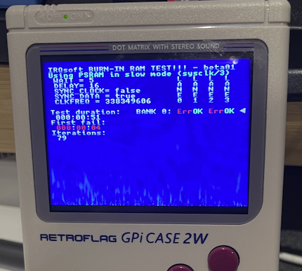

@Wuerfel_21 , I was able to build your RAMtest app (with Flexspin 7.5.0) and got some video data on screen though no audio output (was there meant to be audio too?). I'd copied my working patched NeoVGA.spin2 and my config.spin2 settings file from NeoYume. I also tried setting _CLKFREQ to 128000000 and _XTLFREQ to 64000000 as the initial default in case it was starting out with bad values assuming a 20MHz XTAL instead of my 64MHz clock - I presume that NeoVGA will update the clock to the real frequency later anyway. Not sure if there's anything else I'm supposed to do that you know to make the audio work if there is meant to be some - code seems to show OPNAcog being spawned with playVGM stuff.
Ran for a few mins
2nd try once warmed up - failure seen right away and then locked up to black screen a few mins in. This was with that green heatsink on too.

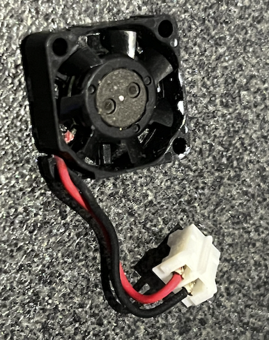

Am planning to visit Lachlan's work again soon to try more customized heatsink options to see if it helps with heat transfer away from his P2 board at the high overclock speeds. It's good this test triggers failures so early as we can make use of it for benchmarking these options.
E.g. Something like this might help too - I reckon 4mm could just about be made flush with a drilled out case back for airflow and I could tap the source 5V power which is switched on/off by the main switch anyway. https://www.ebay.com.au/itm/304477919935
EDIT:LOL turns out I already have one from an old P1V tablet project's heatsink. Slightly bigger at 15x15x5mm

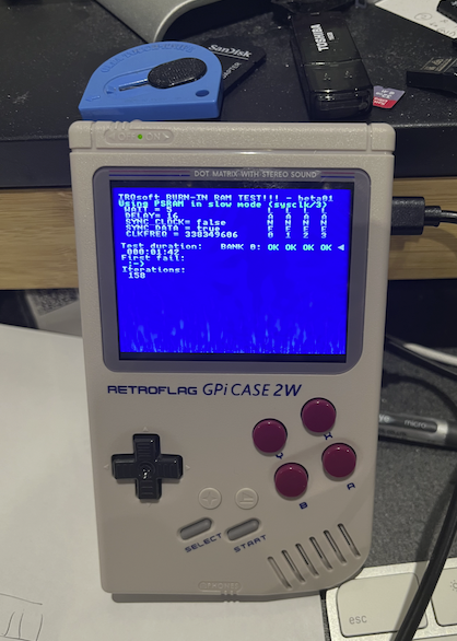

@Wuerfel_21 I have ported your emulators to my updated HW and ran into some issue after loading screen. Screen changes and freezes and looks like this once MSLug gets loaded. I tried with 4 bit SD initially then backed off to original SPI mode but effect is the same. Using PSRAM timing same as edge but also tweaked up and down a few clocks without help.
It did load up once the very first time and let me get into the initial in-game MSlug menu and played sound fx etc but locked up just before it would have started actual gameplay when I wanted to start it.
Wondering if PSRAM settings might cause this, or actual overheating...?
Didn't you have a RAM test app that ran when the other Cogs were running sprite stuff at rated game clock speed? That could potentially be useful to debug this issue.
EDIT: wow the boards are HOT. Just took them out of the case to see how warm. Would be worth adding a thermocouple into the housing if I can fit it in while game is running. Even though my board is transferring some P2 heat too, I think an actual heatsink plate is going to be needed.
Might also explain why it seemed to work the first time but not afterwards (once it had warmed up a lot). Also when I ran the memory test again now when things were warm I got worse values vs prior run.

You did try tweaking the sync/async settings, right?
Hard to decisively distinguish. But looks to me moreso like PSRAM fail rather than P2 core fail.
That the screen changes when trying to boot is normal, on startup the menu fix graphics are kicked out in favor of the game's fix graphics.
yes. Will need to drop the customized NeoVGA into this.
Note that this doesn't just test PSRAM integrity, but is also really hard on the P2. If it doesn't run properly or locks up, that's a P2 core fault. Bad PSRAM only ever leads to red FAIL prints.

Ran MSlug with the back open for over 8mins before it locked up. Temp started out at ambient 19C and then rose to ~64C on the hottest part detected by my infrared thermometer when pointing towards the P2. I think this is probably a thermal issue. I might try blowing air on it while playing and see how it behaves and whether it lasts even longer before failing, if it even does fail with that. I could also try to add a heatsink from a RasPi kit or similar as another test.
This test was run with the slow PSRAM clock enabled (sysclk/3) and a 16 clock delay according to these config.spin2 settings.
Aluminium is the way. Cheap, easy to work, lightest weight of the three, and does a good job as a heatsink. Anodise it for looks and wear resistance, then maybe add plastic handles or similar where it gets a lot of wear.
So I went and quickly purchased a 14x14 mm stick on heatsink and ran with that (back open) and I played for 30mins then I stopped without crashing. Heat reached about 58C on the back of the P2 according to my thermometer which is 5C less than the crash point, although this was with 19C ambient so room temp of 25C may still fail.
At least this shows a marked improvement and it would appear overheating is the prime issue to resolve. A custom heatsink case or insert would be nice to sort out and 3d print.
Ran for a few mins
There ought to be audio, but remember that this board/case has super quirky/off-spec audio, doesn't it? It's not that important, anyways.
Yeah it does use PWM audio not DAC audio Not a big deal to not hear it.
UPDATE:
Found an even smaller one at just 3mm thick and up to 3.5V operation. Wow. I do wonder if it would have any effect at all.
https://www.digikey.com.au/en/products/detail/sunon-fans/UF3F3-700-TC/9805486
