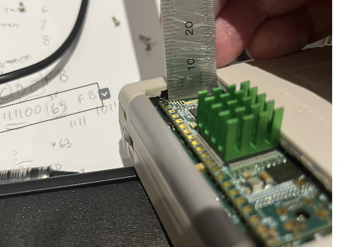

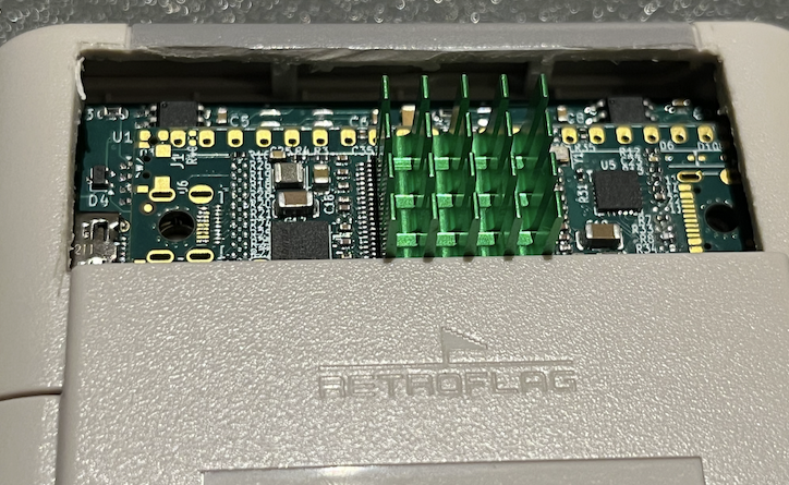

Existing cartridge shell looks like this inside. There's probably a 2-3 mm gap above the components on Lachlan's P2 board to the back surface, so enough room for a custom metal plate. It could also go though to the outside of the plastic at the back with fins in the worst case. But ideally it could retain the same external size for a cleaner look.

Ran MSlug with the back open for over 8mins before it locked up. Temp started out at ambient 19C and then rose to ~64C on the hottest part detected by my infrared thermometer when pointing towards the P2. I think this is probably a thermal issue. I might try blowing air on it while playing and see how it behaves and whether it lasts even longer before failing, if it even does fail with that. I could also try to add a heatsink from a RasPi kit or similar as another test.
This test was run with the slow PSRAM clock enabled (sysclk/3) and a 16 clock delay according to these config.spin2 settings.
Aluminium is the way. Cheap, easy to work, lightest weight of the three, and does a good job as a heatsink. Anodise it for looks and wear resistance, then maybe add plastic handles or similar where it gets a lot of wear.
So I went and quickly purchased a 14x14 mm stick on heatsink and ran with that (back open) and I played for 30mins then I stopped without crashing. Heat reached about 58C on the back of the P2 according to my thermometer which is 5C less than the crash point, although this was with 19C ambient so room temp of 25C may still fail.
At least this shows a marked improvement and it would appear overheating is the prime issue to resolve. A custom heatsink case or insert would be nice to sort out and 3d print.

Few other pics...there's just a 2mm gap between the FireAnt board and Lachlan's P2 board.
Nice work on a heatsink. Amazing what a difference it makes, hate to think how hot this P2 is internally.
Its easy enough to make up an AL plate, probably have 1.6, 2 or 3mm at work, and its so each to machine. We also have some bergquist thermal blanket somewhere
3D printing a stainless cover won't help, unfortunately. Stainless famously doesn't spread heat, you get real hot spots and yet next to no spread. AL or copper PCBs are an option though and provide the ability to be insulated where you need insulation (above the reg gaps etc)
Yeah maybe stainless is not the best option. These pics show the space available after I put the cover on the back that I'd already cut up in the past for the proof of concept design with the P2 edge sticking out. It'd be good to make something fit even if the cover has to be cut to expose to outside airflow etc. Looks like about 3mm from the top surface of the upper P2 board to the underside of the plastic.
