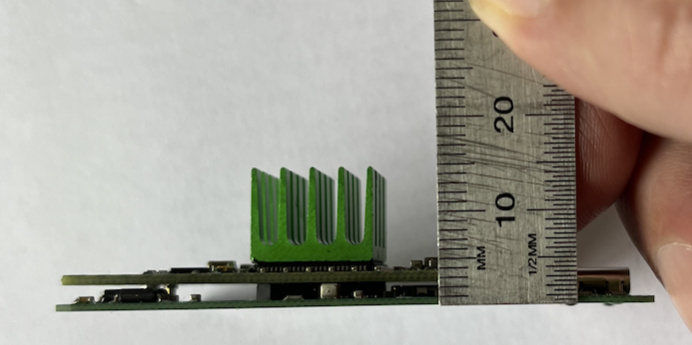

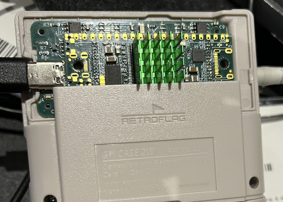

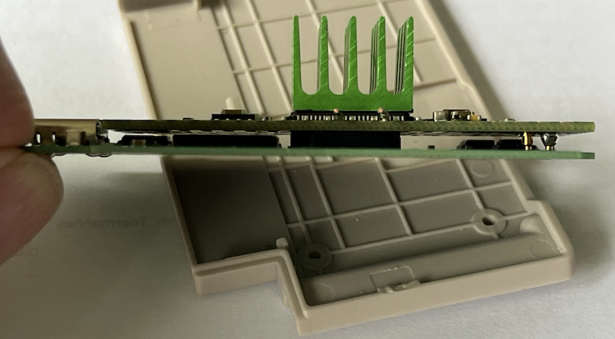

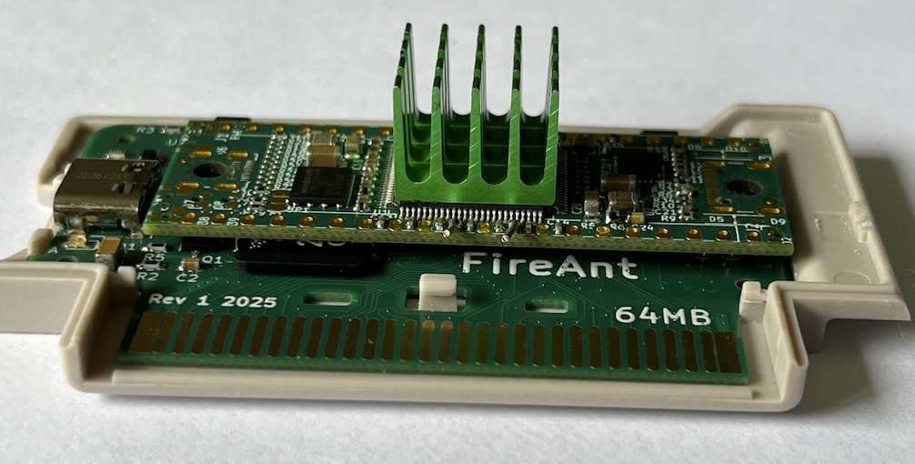

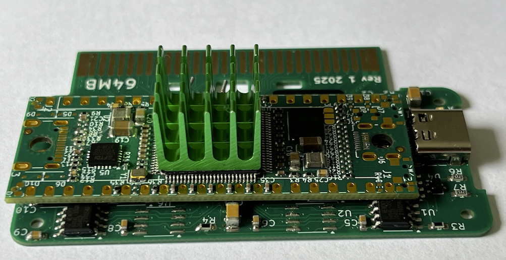

So I went and quickly purchased a 14x14 mm stick on heatsink and ran with that (back open) and I played for 30mins then I stopped without crashing. Heat reached about 58C on the back of the P2 according to my thermometer which is 5C less than the crash point, although this was with 19C ambient so room temp of 25C may still fail.
At least this shows a marked improvement and it would appear overheating is the prime issue to resolve. A custom heatsink case or insert would be nice to sort out and 3d print.
Roger.
Few other pics...there's just a 2mm gap between the FireAnt board and Lachlan's P2 board.
