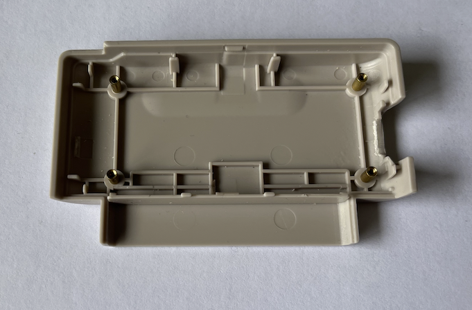

    @Wuerfel_21 I have ported your emulators to my updated HW and ran into some issue after loading screen. Screen changes and freezes and looks like this once MSLug gets loaded. I tried with 4 bit SD initially then backed off to original SPI mode but effect is the same. Using PSRAM timing same as edge but also tweaked up and down a few clocks without help.
    It did load up once the very first time and let me get into the initial in-game MSlug menu and played sound fx etc but locked up just before it would have started actual gameplay when I wanted to start it.
    Wondering if PSRAM settings might cause this, or actual overheating...?
    Didn't you have a RAM test app that ran when the other Cogs were running sprite stuff at rated game clock speed? That could potentially be useful to debug this issue.
    EDIT: wow the boards are HOT. Just took them out of the case to see how warm. Would be worth adding a thermocouple into the housing if I can fit it in while game is running. Even though my board is transferring some P2 heat too, I think an actual heatsink plate is going to be needed. :disappointed: Might also explain why it seemed to work the first time but not afterwards (once it had warmed up a lot). Also when I ran the memory test again now when things were warm I got worse values vs prior run.
    You did try tweaking the sync/async settings, right?
    Hard to decisively distinguish. But looks to me moreso like PSRAM fail rather than P2 core fail.
    That the screen changes when trying to boot is normal, on startup the menu fix graphics are kicked out in favor of the game's fix graphics.
    yes. Will need to drop the customized NeoVGA into this.
    Note that this doesn't just test PSRAM integrity, but is also really hard on the P2. If it doesn't run properly or locks up, that's a P2 core fault. Bad PSRAM only ever leads to red FAIL prints.

  • @evanh said:
    @rogloh said:
    EDIT: ... I think an actual heatsink plate is going to be needed. :disappointed:
    And now a whole other hand-warmer engineering exercise begins.
    If a suitable part is modelled, we could potentially then create a 3d printed metal backshell in the same profile as the plastic (or squeezes just under the existing plastic) and contacts the P2 - this would give a large surface area to spread/radiate the heat. But whether stainless steel is as good enough heat conductor vs Al or Cu not sure.
    Existing cartridge shell looks like this inside. There's probably a 2-3 mm gap above the components on Lachlan's P2 board to the back surface, so enough room for a custom metal plate. It could also go though to the outside of the plastic at the back with fins in the worst case. But ideally it could retain the same external size for a cleaner look.
