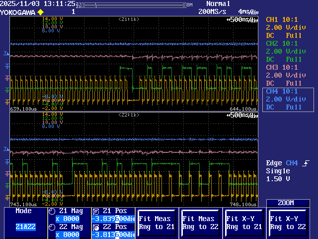

A proper regression squashed: The minimum write block-to-block gap (Nwr = 2) of two clock pulses wasn't being respected from v1.8 onward. I'd even deleted the comment stating spec requirements. Brain fart!
This only manifested when operating at a large clock divider because then clock gen can cancel in less than a SD clock cycle length after card-ready is detected, and Nwr also applies to the end of card-busy. The block write routine fully preps for a quick transition while waiting on a long card-busy.
The screenshot shows the beginning (top half) and end (bottom half) of the second block written of consecutive blocks.
The end of the second block (bottom half) shows very end of 512 byte data block, then the written CRC, followed by slower clocked CRC response back from the SD card. The response being CRC mismatch error. Which occurred because the SD card wasn't ready for the start bit when it was sent.
Orange trace is SD CLK pin.
Green trace is SD DAT0 pin.
Pink trace is SD CMD pin.
DAT0 is low (top left) while card is busy handling the first block written. DAT0 goes high to indicate card has become ready. The driver stops the clock and sets DAT0 low (start bit) to send the second block, then restarts the clock and write data all nicely aligned.
Problem is the clock should have gone at least one more pulse before stopping to reconfigure. Now it does, again.

That seems to be everything. I'm no longer getting any Nrc problems even though I'm not explicitly ensuring the minimum value of 8. Implementing full response collecting of the many CMD12 occurrences has rectified this one. Most command handling has always had excess trailing clocks beyond end of response to fill the minimum Nrc spec.
So, stable again.
