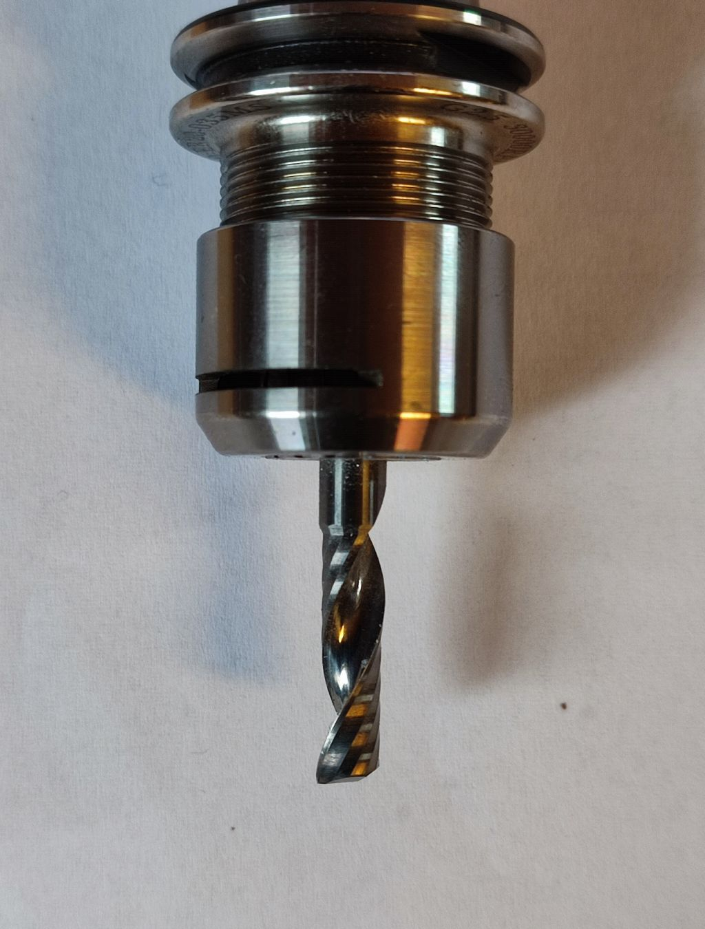

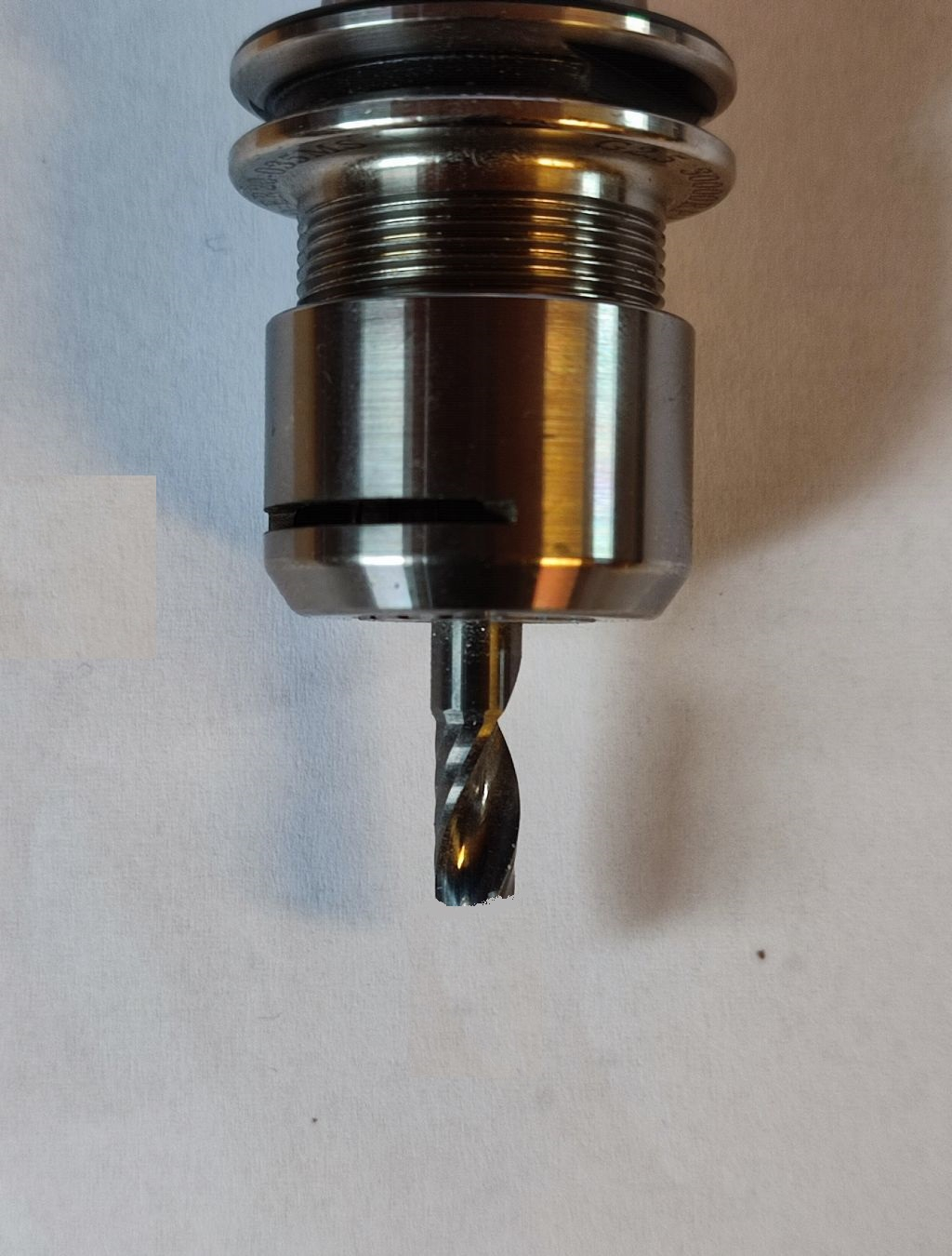

My new automatic tool changer means I can let the machine run unattended with longer jobs and multiple tools. But this also means if something goes wrong in the middle it can get more expensive. Sometimes the cutter breaks which is no big deal if you notice it. You stop the machine, change the cutter and continue.
But if unattended the machine continues to run but without removing material. So let's assume we want to tap pre-drilled holes. If the drill bit breaks the machine changes the tool to the tap drill and ruins it by ramming it into the solid material where the pre-drilled holes should be but aren't. :/
The usual fix to this is to measure the tool length with a touch probe or an optical laser barrier, once after the tool has been picked up from the tool changer and once again before it is stored back. But this takes time as the machine has to move to the location of the probe and then has to slowly advance the Z axis until the tool tip hits the probe or laser beam.
Inspired by the latest "AI & Vision with the cyber:bot and MakeCode" tutorial a better idea would be to do this with a camera and simply compare the "before" and "after" pictures. They could look something like this:

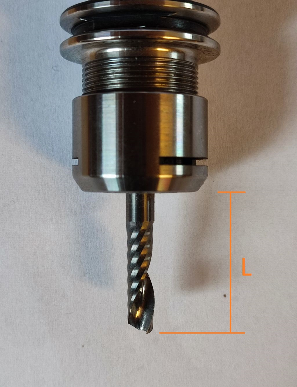

The point of interest is the distance from the collet to the lowest point of the cutter tip.
This point could be an a different side after the cutting process due to a different rotation of the tool.
But the overall length should stay the same within some small tolerance. If the length differs considerably then there's something broken.

  • Nice! :D Although I intentionally asked the forum instead of ChatGPT directly to hopefully get some answers from real humans I have to admit that this is quite helpful. I don't know if I would trust the quoted code blindly but any flaws can be fixed easily if you have some basic technical understanding.
    Calibration is not necessary because the actual length doesn't really matter, only the difference. OK, for the scale of the tolerance it matters, but a rough guess is enough.
    BTW, I can take the picture inside the tool changer at the lowest position of the caroussel magazine. The tool stays there for a brief moment so no extra movement of the spindle is necessary and motion blurr is no issue.
