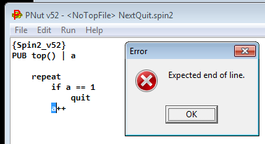

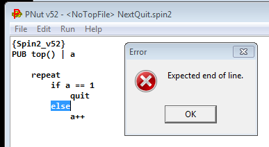

  • maccamacca Posts: 1,058
    edited 2025-10-09 10:03
    @cgracey said:
    • NEXT/QUIT now allowed to select nesting level of operation.
    Seems something is broken, I got an error on a simple if/else block:
    Can be reproduced also with the parser.spin2 (and other sources in the PNut package) example.
    Am i missing something ?
    Edit: worst than expected, seems that nothing can be added after a quit statement:
  • @macca Is a number now compulsory ? Does it work with "quit 0" or "quit 1" ?
    (Sure, that would be silly, but just an interesting test / workaround. I'm not able to try it at the moment).
    Ah, yes, with quit 1 it works (quit 0 is not valid since must be 1 to 16).
  • Oh goody. Might just need the default case adding back into the compiler.
    @cgracey
    May we have an override for "quit" and "next" without a parameter to behave like they used to, equivalent to "quit 1" and "next 1" ?
    edited 2025-10-09 14:08
    Sorry, Guys!
    I see the problem. It's in my parsing of what comes after NEXT or QUIT. I need to back up when there is a line end, indicating there will be no constant.
    I will have this straightened up in a few hours.
    edited 2025-10-10 00:09
    The new v52 is now posted on the OBEX and on Github.
    https://obex.parallax.com/obex/pnut-spin2-latest-version/
    NEXT and QUIT do not require integers after them, but an integer is needed if you want to NEXT/QUIT from outside your current REPEAT block. That integer would need to be a value of 2 or more.
    edited 2025-10-10 00:14
