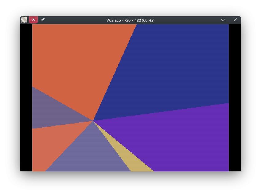

Just as a little update, I figured out full 3D clipping. This is important for rendering interior spaces, since often a visible triangle will have one or more of its vertices behind the camera. The code already employs a guard band, so triangles that would end just a few pixels off-screen can simply be scissored by the rasterizer instead of having to go through the complex/slow clipping process. This only works if all 3 vertices would have valid (±32767) 2D X/Y coordinates after projection. In cases where the vertex is e.g. behind the camera, clipping is inevitable, so I went ahead and implemented it.
This is kinda difficult to meaningfully demo if you don't already understand what it is, so let's just say the code goes to a different school for now (too lazy to clean it up).

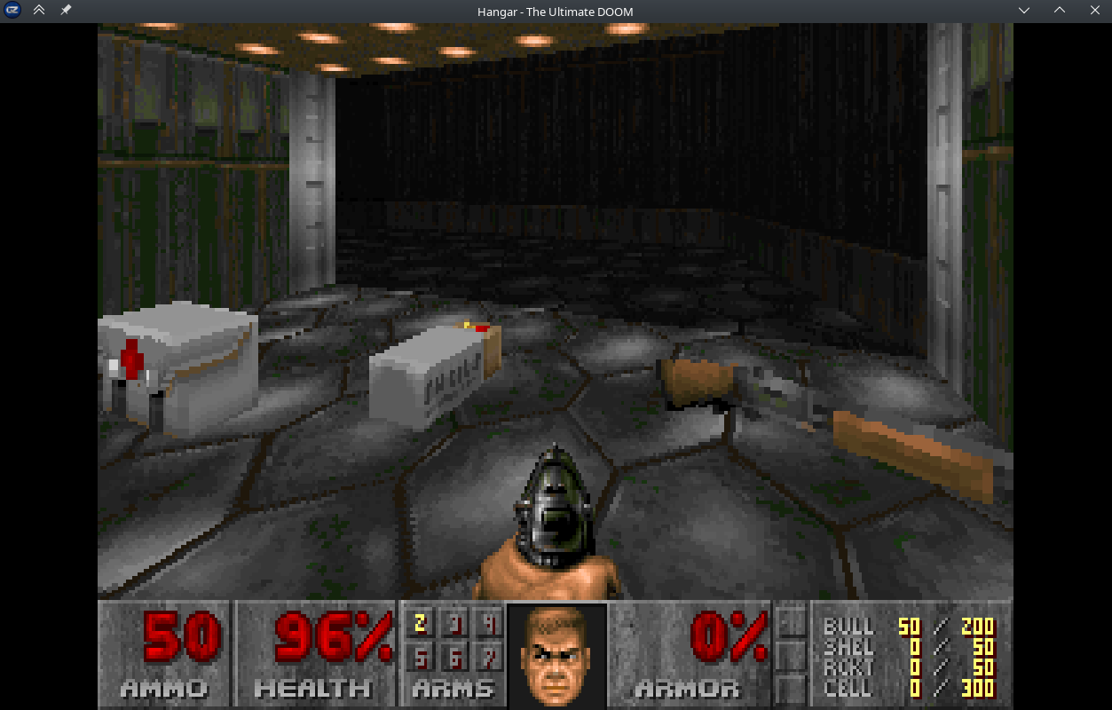

@Rayman said:
Be nice if this could be with my raycaster to show sprite like things in more real 3d...
There's a (conceptually) simple thing you can do that's almost as good and really fits into that wall/sprite column rendering paradigm: Voxel models, as first introduced by BUILD engine.
Basically you've got a 3d array of voxels (in practice you want to compress it to not store empty/interior voxels). You calculate the distance and on-screen X position for each vertical column (like for a sprite) and then draw it. Things to keep in mind: draw the most distant columns first (there's 4 cases depending on relative angle, I think?), if it's close-up, each column may need to be drawn multiple pixels wide to avoid a gap.
Here's what that looks like (in a doom mod) - hard to really get it across in a still frame:
