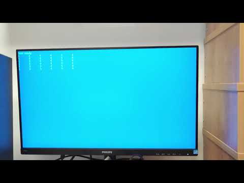

    I tried the simple triangle drawing. The time depends on the size: the bigger the triangle, the better the time for one pixel - as expected. For a triangle 100 pixels high and 200 pixels wide at the bottom, I got 7 clocks per pixel for execList call (that I made PUB to call from the test program)
    The biggest test triangle I tried was 512 px high, 1024 px wide and it took about 5 ms to draw, about 6 clocks per pixel.
    Now I need a fast procedure to prepare the list for any given triangle and that procedurew should be as fast as possible (=asm)
    The program on the attached video displays some test texts to check if the driver works OK, waits 5 seconds and then draws 256 triangles to test if drawing in a loop can corrupt the driver (that didn't happen yet)
    sub testtriangle
    var pixels=0
    for j=0 to 255
      for i=0 to 511
        list(4*i)=$C000_0000+v.buf_ptr+1024*i+(511-i)
        list(4*i+1)=j
        list(4*i+2)=2*(i+1)
        list(4*i+3)=varptr(list(4*i+4))
        pixels+=2*(i+1)
      next i
      list(2399)=0
      i=getct()
      psram.execlist(mbox,varptr(list),0)
    'i=getct()-i: print i: print i/337 : print i/pixels
      next j
    end sub

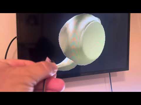

    So for the earlier demo I always just set 1/Z to a constant (essentially doing affine shading / texture mapping). Now that I'm trying to do it properly the headaches are starting:
    This is with "fog" shading towards white for clarity. Each vertex of these buggy triangles has L = $FF_FF (this is an 8.8 fixed point value). When L/Z and 1/Z are calculated for the vertex, they're scaled such that (L/Z) / (1/Z) = $FF.
    The problem is that due to rounding error in the gradients, (L/Z)' / (1/Z)' = $100 for some pixels in the triangle (since the original fixed-point value was almost $1_00_00 to begin with) and this overflows the 8 bit PIV register.
    I could clamp L to $FF_7F or something to mostly ignore this problem, but I feel like there's a deeper insight wrt. rounding here that would fix it properly.
    EDIT because forgor 💀 : There's another problem related to small triangles overflowing the gradients, which required me to chop 4 bits of precision off everything (I think in the screenshot I have it at 8 because that makes the PIV overflow problem more visible - it really only needs SUB_PREC (which is sufficient at 4) bits of headroom). That might also be solvable.
  • Though the hackneyed clamp solution does work for this particular demo, so I'm shipping it. Here you go, 60 FPS spinning teapot (full of unfinished code)
    This consistently gets frametimes under 10000µs, so it's ~3 times faster overall than teapot_demo2. (This is with major pain sites in vt_project and tri_setup_texlit)
  • As it were, slightly un-awful-ing vt_project ('slightly' in that it's still readable) saves ~300µs

    In teapot-related news, here's a "3.1" version of the demo, collecting a few low-hanging improvement fruits:
    • Aforementioned vt_project optimization (still some cycles on the table there)
    • Saved another ~200µs in gradient calculation
    • Tweaked PSRAM driver settings for better performance (apparently the burst length setting is half the actual burst length??)
    So this is 521µs faster GEO (2750 -> 2229), ~100µs faster screen upload (really?). RAS currently unchanged.
    (All measurements with teapot at zero angles, which is a quite quick to begin with)
    Other fun fact: vertex processing is really cheap! Disabling calls to tran_nrm and do_envmap only shaves off 100µs, so there's some headroom for features like dynamic lighting.
