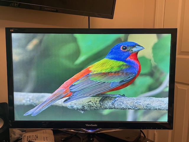

This one loads the 8bpp bitmap from uSD instead of hub ram.
Using the @evanh bashed3 uSD driver with FAT32 (instead of FSRW this time).
the bmp file has to be on the uSD of course...
Here's with 16bpp VGA bitmap, loaded from uSD.
