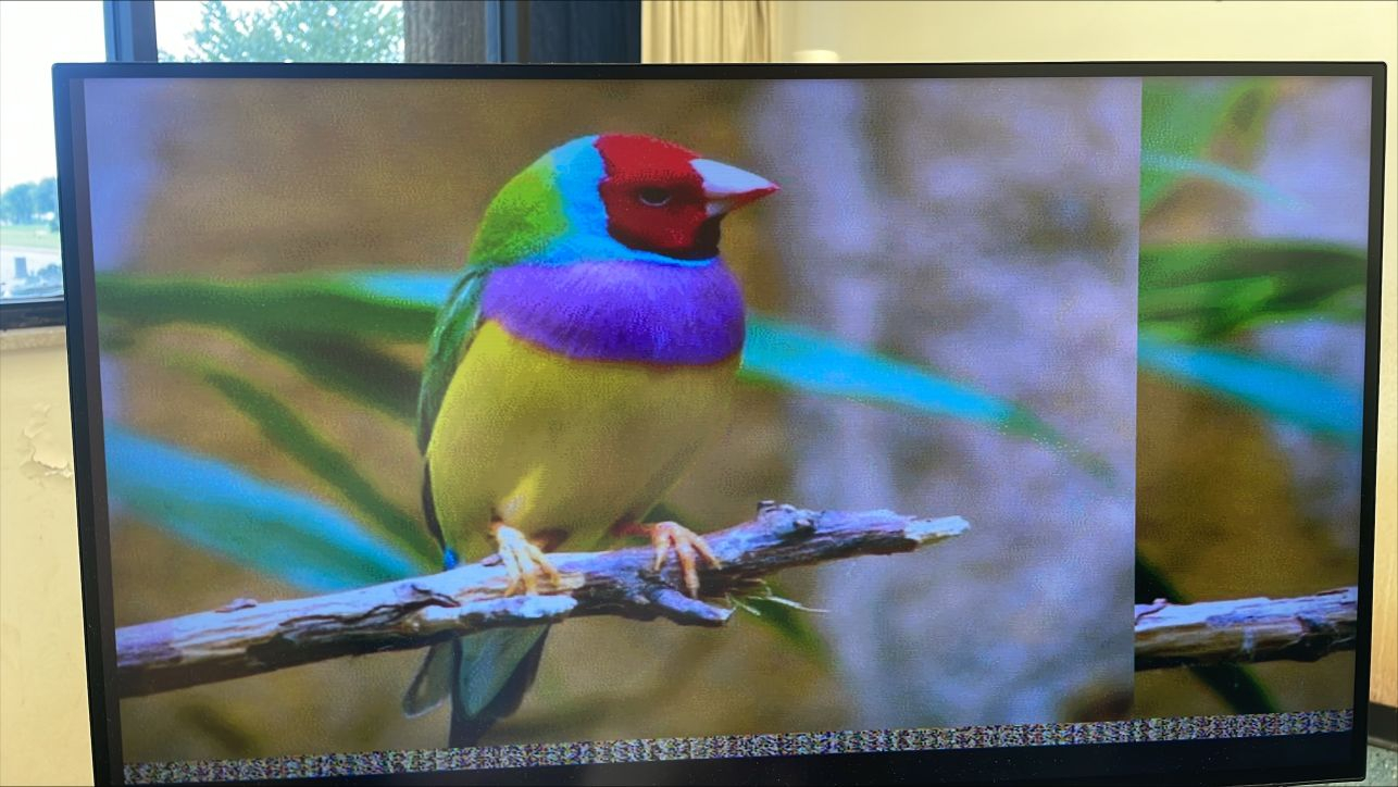

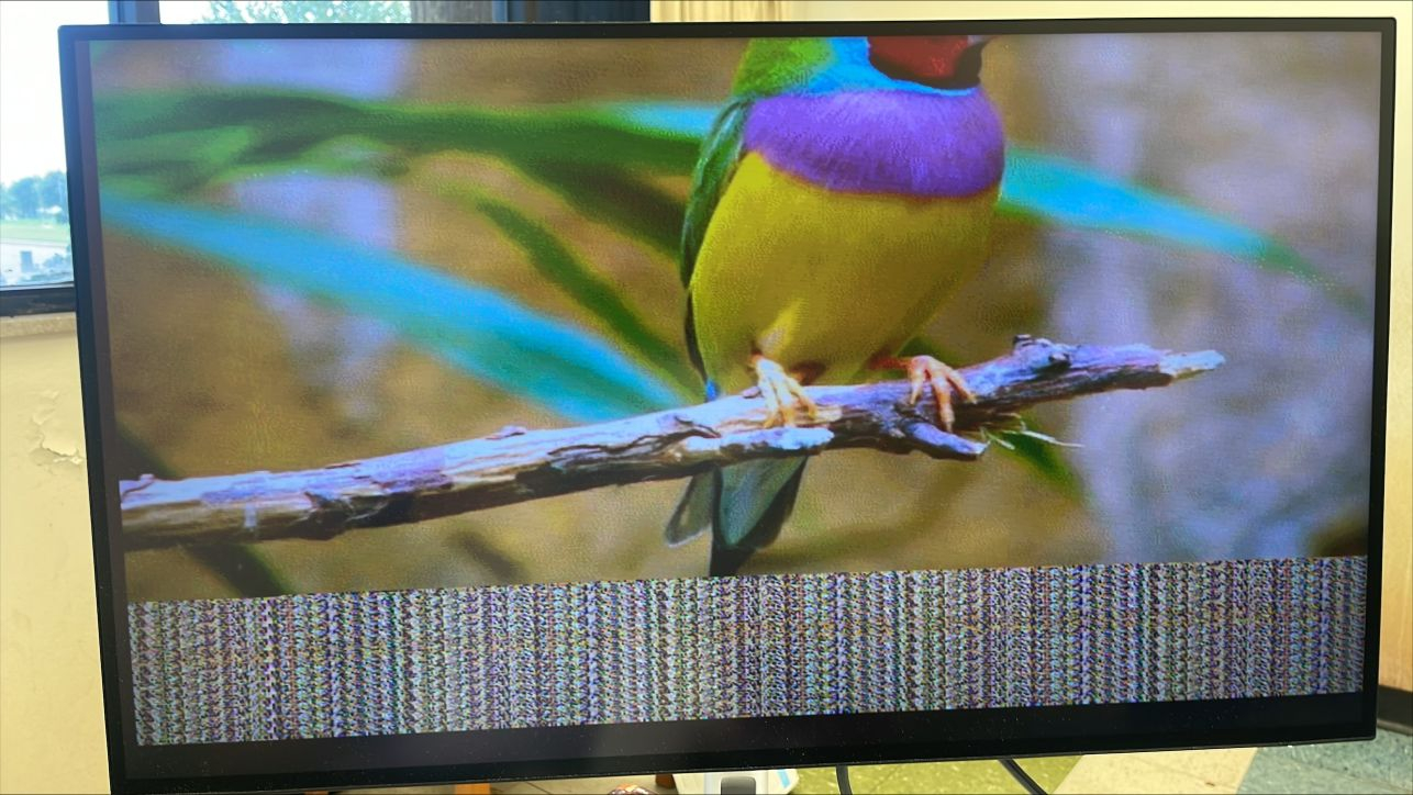

  • RaymanRayman Posts: 16,421
    Seem to get corrupted data if don't do a waitx after telling it copy a line of video...
    Shouldn't the wait loop after the waitx be enough?
    Seems it isn't...

    Also, in a video driver need to break up a copy loop into two segments or it doesn't work right...
    Not exactly sure why...
    Guess I'll play with that maxburst setting...
    Maybe set to -1 isn't a good idea here...
    Breaking up the copy of working buffer in HUB to display buffer in PSRAM into two operations seems to work, so will attempt to stick to that.
    Don't know why needs to be split though...
