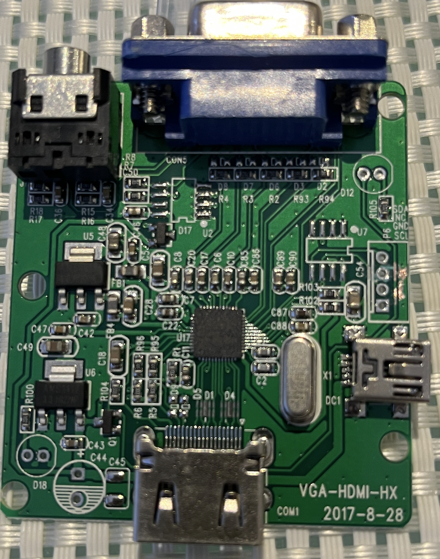

    @Wuerfel_21 One possible way to get HDMI out might be those cheap VGA to HDMI converter boxes. If they worked with this tight video timing I guess we could try to use make use of that. Be cool if that chip fit inside this box, but I still need the connector space for it and it's at a premium. Might make more sense to use one externally even though not as nice a solution.
    https://goughlui.com/2019/02/02/quick-teardown-mini-vga2hdmi-converter/

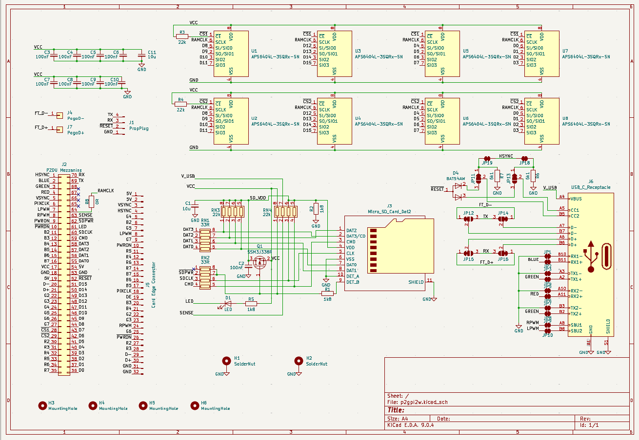

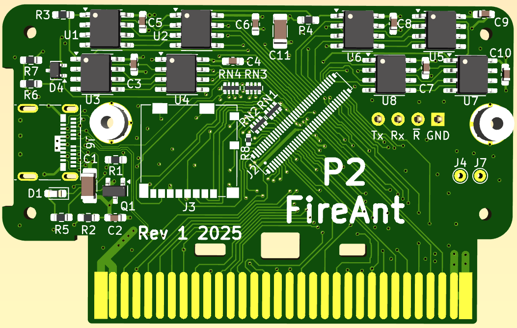

    Getting there on the next board. It's probably about 95% routed but that last 5% will of course take longer. I ended up adding USB-C to this which will allow programming and updating the internal SD card files via USB at some point - I have jumpers that can select paths via FTDI or through P62/P63 directly. I also added a bunch of solder jumpers for optionally sending VGA over a custom USB-C cable which may be helpful at some point. They are accessible on the bottom layer. Maybe a CM201 can be modified to accept input via USB-C connector and then output HDMI.
    Here's the top layer - it's filling up a bit now, I just have some more USB-C routing to do and a general tidy up/DRC etc. I've also gone to 4 layers on the FireAnt board. With any luck the heat from the layers on the top P2 board can wick down via the grounded metal solder nuts and the two larger ground planes on my board will help dissipate the heat. But that's going to be an interesting test when we get to it - the P2 sitting above is facing outwards so adding some sort of external metal heatsink plate is still possible if needed. Hope it doesn't need an external fan!

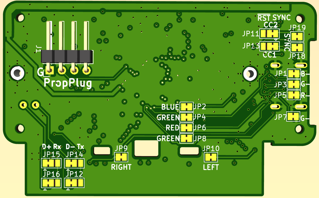

    @Wuerfel_21 , was chatting with @Tubular today and we talked about reversible USB-C cables carrying VGA signals. I wonder in your drivers whether we can make good use of Sync-on-Green as a way to deal with cable reversal or if there's any issue there. Looking at the colour channel mapping in the prior post's diagram, instead of using the TX2 pair for H/V syncs green is replicated on both TX1+/- as well as TX2+/- pins. Then if the USB-C cable is reversed then only red and blue colours would be swapped and this would be immediately visible but it would still work. Also L&R channels would be swapped but that's tolerable also. Another way to keep it working but avoiding sync-on-green is to use both CC1/CC2 pins for a single combined (H^V) sync single.
    Note that doing this is obviously completely non-standard and is just for a customized breakout application using a USB-C interface cable to output VGA, not for normal USB-C operation. Ideally though it wouldn't interfere with a USB-A to USB-C cable at all and the D+/D- pins could still be used for a USB prop plug via the on-board FTDI chip. I could either use CC1/CC2 for combined sync, and the SBUS pins for audio or vice versa. Not sure which is better - perhaps SBUS is better for audio if no pull down resistors are present so the DAC mode can be used, but for this 5k1 resistor value it's unlikely to matter anyway.

    Yeah I'll probably aim to target the C-sync way, at least as an option. All my monitors seem to accept that mode. My driver also does it as well. I believe C-sync can also be driven at video levels too. Am sort of hoping that the LCD without vsync might shut down and stop the internal amp so that would let us use DAC mode externally but not 100% sure yet.
    UPDATE: with respect to the pinning of the cable and the audio/sync, I figured out it would need to be the combined HVSYNC on CC1 & CC2 with audio on SBUS because inside the USB-C cable there is only one CC line connected so stereo audio would not work there. So I'll just put the video sync on those pins. It means that CC1 and CC2 are shorted together after the socket (I'll populate only a single 5k1 resistor or possibly do 2x10k in parallel).

    Here's what was inside my CM201 case when I opened it up. The unpopulated components seem to be a DDC EEPROM going to the VGA pins, a power LED & more caps, a LED for HPD indication, and another I2C which connects to the chip - maybe some sort of additional firmware for more HDMI features (HDCP encryption stuff perhaps?), plus a header for programming that.

    The main P2 FireAnt PCB design is now done and passes DRC. Our plan now is that it will go out in the next day or so for manufacturing along with that other VGA2HDMI breakout board I've since completed as well.
    I shielded the ~150MHz PSRAM clock with ground planes and ensured layers above and below had no other signal crossings and tried to make the same path length to each PSRAM device to minimize the clock skew although the data line lengths would still vary a little. Some of this work is probably moot as there is going to be some length variation from the board above that holds the P2 anyway, but whatever. I also added a series resistor in the clock line to try to match impedance if that helps sharpen rise times and improve signal integrity and performance with 64MB fitted (which has 2 PSRAM chip loads on each data pin, and 8 loads on the clock pin). We'll see if that helps or hinders it. Might have to run at sysclk/3 in the worst case.
    DAC based VGA (along with audio) is output to the USB-C high speed data pins and secondary bus channels by default but can be removed by cutting some jumpers. USB-C should still be reversible and something would display but red/blue would be flipped along with audio channels (in theory this could be reversed in software to accommodate that).
    Update: This reminds me, still need to doublecheck the pixel clock can be generated by a SmartPin on the same pins already controlled by the COG driving the video from its streamer. If that fails this board needs a pin adjustment.
    EDIT: just tried it on bit4 of portA which currently also outputs H/V/DE in the same byte and it seems to work. :smiley:

    Some progress over the weekend although I've not been able to use the forums much due to lots of 504 Gateway Timeout errors this week. Parts arrived and I soldered up the board. Now waiting for Lachlan's board to be assembled to test further.
    Some pics of assembly and final outcome of the hotplate soldering which I'm really happy with. The 0402 resistor R8 was tricky but just achievable - same as the resnets.

    Also made that VGA2HDMI board and it worked first go which I'm pleased with.
    Pasted and ready to cook
    Hotplate cooked
    Test setup
    Board feeding DVI input of my monitor from P2 VGA source converted to digital video
