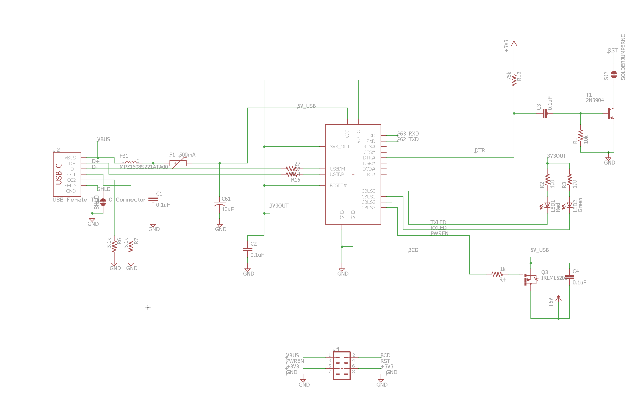

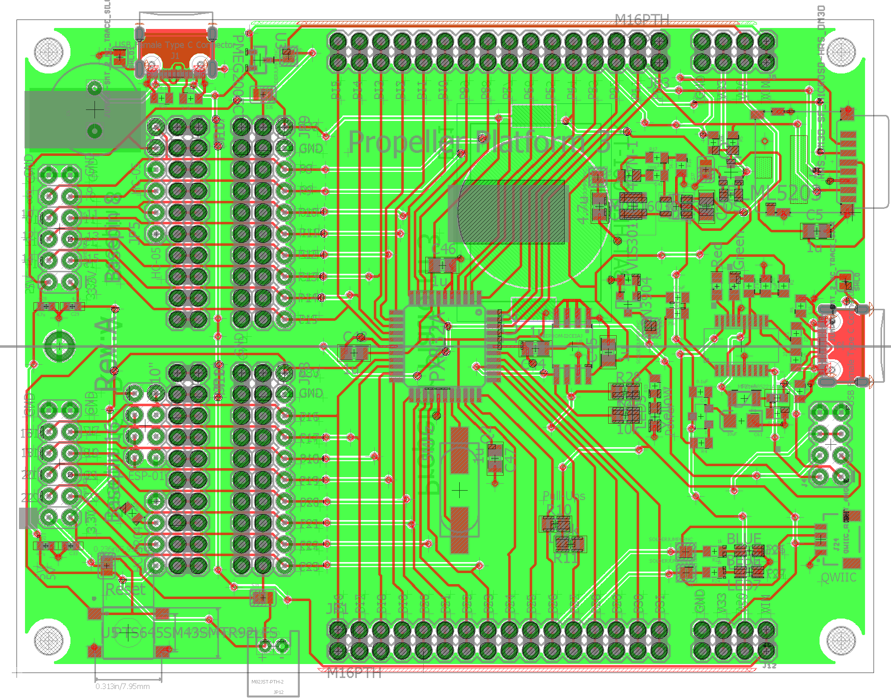

Need a new P1 board for a battery powered full color E-Ink display...
Haven't made a P1 board in a very long time, so this is fun.
Here's the concept so far (see image).
Think the last "platform" board for P1 that we made was called "Express".
This is an expanded update.
USB connectors updated to USB-C
FTDI chip updated to FT231X.
Doing this in Eagle, think was ExpressPCB last time. That was smaller, this is full size...
Adding a QWIIC connector (cause that's an easy way to add peripherals).
Added two P2 style headers, not sure what will do with those yet.
Adding a middle proto area. This is where the E-Ink adapter will connect.
Could have two of them...
Adding a second USB-C connector for power only (no serial).
Adding two pull-up resistors to uSD, even though maybe not 100% needed.
Adding a couple blue LEDs.
Think that's about it...
Update: Here's initial layout...
Update2: Made a blunder with first version and programming lines were not connected to P1 due to copy and paste error from P2 circuit :(
But, just assembled some of the revised boards and all looks good :)
  • If you have µSD, you can probably add a spot for a 23LC1024 RAM chip (sharing the same SPI pins). They're pretty neat for low-complexity volatile storage (P1 being of course super RAM starved at all times)
  • JonnyMacJonnyMac Posts: 9,809
    edited 2025-09-14 18:30
    Neat board, Ray.
    Do you have a power pin (PFET) to cycle power on the uSD?
    Is the Qwiic port shared with the EE I2C pins? One thing to be mindful of is that the P1 drives the clock line and the boot-up I2C frequency is a little over 250kHz. Devices that can only tolerate 100kHz (usually devices with small processors) can interfere with writing to the EE. I had this happen with a Sparkfun I2C 7-segment display and had to move it to its own set of pins.

    @JonnyMac Is there any P1 board with power pin for uSD? Could add one with option to bypass if need the pin.
    You might be right about I2C pins. Do not want anything messing with boot from EEPROM. Can add solder jumpers to disable the pullups. Actually, think most QWIIC things come with pullups. Is that true? Think so...

    Here's an initial design. Don't see room for PSRAM. But, think have plenty of memory boards for P1 Platform in the stash somewhere...
  • RaymanRayman Posts: 16,340
    edited 2025-09-23 18:12
    Added connectors for bluetooth (HC-05), wifi (ESP-01), and ultrasonic distance (HC-SR04). Haven't used any of these before, think they might work.
    Added a coin cell battery connector on the bottom.
    Also added a place for a large capacitor in case want to connect servos...
    The second USB-C power can be isolated from main power so that servos can't take down the P1 with power glitch.
    Think it's in good shape now...

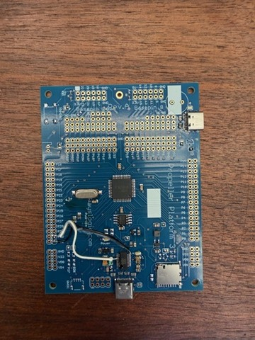

    Got these boards in...
    Hope it works...

    Finally put one mostly together :)
    Seems made a rather bad copy and paste error from P2... Seems P1 doesn't have P62/P63 for RX/TX... :(
    Works with jumpers, but have to get this fixed...

    There are two USB-C connectors on this board, one for programming and regular power and one for alternative power (to power things like servos without messing up P1).
    One hope was to be able to power both of these using USB power banks. Was thinking of using two little ones for a robot...
    Just discovered two issues. One is that the FTDI USB circuit won't power on unless talked to by a computer. Thought maybe having the two 5.1K resistors there would override that, but power is controlled by a mosfet connected to the PWREN# signal from FTDI chip.
    But, can fix this with a solder jumper that grounds the mosfet gate. That way, USB power is negotiated by the 5.1K resistors and it's all good.
    Not really sure we need the FTDI to negotiate power with USB-C. Probably could just skip the mosfet all together. But, will keep it this way for now, to work the same as older circuits, or the new way, via solder jumper.
    The other issue is that power banks seem to turn themselves off if don't see a load of some level. This is a pain. I see there are some with "Always On" mode, but they are expensive, at least with a quick search...
    The easy way around this is to put two 100 Ohm resistors between 5V and ground. This seems to suck enough power to keep my bank on. Not sure how universal that is going to be though.
    Still think will add this with another solder jumper. Definitely don't want that connected when powering board by coil cell...
    Might look to see if there's another load that would keep it going. Maybe a couple NeoPixels would be enough. Robot needs lights anyway...
