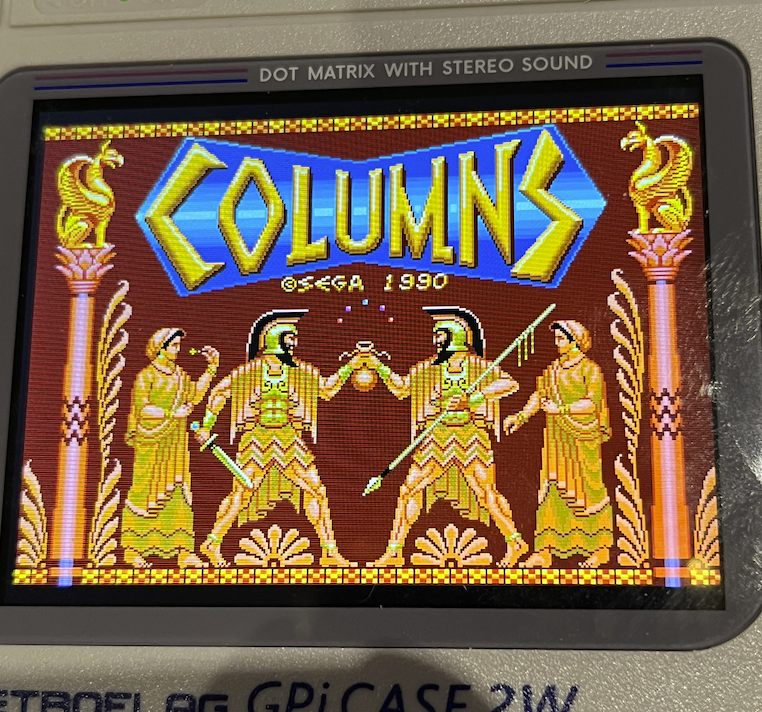

Video glitches now seem fixed once I did this change below with an added waitx #15 to phase adjust the clock edge (so it may not be audio related, although it seemed to make a difference before):
' setup CLK pin (abuse breezeway entry)
debug(ubin_long(dira,dirb,outa,outb))
setcfrq nco_sync
getbyte pb,extravpins,#0
drvl pb
wypin bit31,pb
waitx #15 '****--- experimental waitx to sync clock
xinit ##$fffc,blank_color ' enter dummy command to ensure it stays in sync
waitx #511
jmp #video_entry
Thought you might think that but no, that was already done below. For a 16 clock pixel period waitx #15 is effectively like a "waitx -1" (which is not possible). So in this case the pixel clock is better one P2 clock earlier for the data to be read reliably. What is strange is that it's such a narrow window of good phases. For only ~20MHz clocking I'd expect far wider eye for good clocking. Maybe there's a lot of signal bouncing going on before things stabilize for all the parallel RGB data bits to be clocked - need to probe colour pins.
I realized I should try to dig up my old P2 tablet (800x480 res) and try to run this LCD test code too with necessary tweaks. It also uses a parallel 24 bit LCD interface but I'm not sure which P2 pins I ended up putting the sync's on though - might have been why I generated PWM outputs for Hsync/DE signals. That system has a 4 bit PSRAM so might be able to run something too. It does also have a VGA output and a USB host port.
Try a game with HiRes modes (Trials of Mana uses Mode 5 heavily - check if the text is readable. Make sure you have the newer ~6MB collection ROM or the japenese original - the older ~4MB english patch versions don't actually have hires fonts)
Just tested that and the hi-res text line is clear and readable and looks good. 👍 MisoYume seems pretty good, tried a bunch of things and some games fail to start up but I think that is to be expected. In general I think this is pretty decent on and sounds great too, especially on headphones. I went back to setting #5 for the WXPIN param and video is still okay with that other waitx change I made earlier.
Tried MegaYume, for some strange reason there are a lot of blank lines at the top of the menu pushing it down (maybe by design) and they are also seen in games. This seems weird as I only have 2 back porch lines in the timing so it should be able to start earlier on the screen. Here's some pics of that.

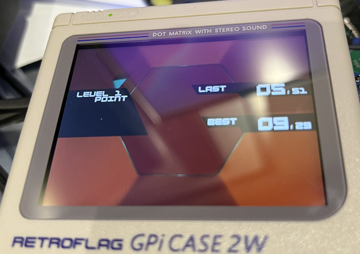

Now the proof of concept prototype worked out, progress has begun on the actual P2 FireAnt board and this (unfinished) PCB is intended to fit inside the GPi case 2W cartridge and can contain up to 64MB of PSRAM and a microSD card reader operating in 4 bit SD mode. It will work in conjunction with another small P2 board also under development that sits above it. This way it's easier to make it all fit.
@Wuerfel_21 I've assigned the Port A pins for parallel RGB as before but with the LSByte now modified and holding audio as well (see below). Do we need to keep bit 0 free if the P2 VGA output mode uses it for HSYNC or should we just make use of this for the LCD panel anyway? If bit 0 needs to be kept free for other reasons like your DIGITAL_BASEPIN assignment I can always move things up or rearrange this byte. I should really double check our pixel clock output idea can work on port A for real. I do still have a free pin on port B I could assign it if needed, or I could split the clocks and realize two independent 8 bit PSRAM banks with one chip select and one clock each which can be combined for 16 bit operation because the pairs are adjacent. It might also alleviate the high fanout for the PSRAM clock otherwise going to 8 chips but could cause different timing between banks (which my driver can handle), and the second bank of chips are slightly further away from the P2.
P0 - HSYNC
P1 - VSYNC
P2 - PIXEL_CLK
P3 - DE
P4 - LEFT_PWM
P5 - RIGHT_PWM
P6 - free for now
P7 - free for now
P8, P9 - GPi power and shutdown
P10-P15 - BLUE
P16, P17 - USB D-/D+
P18-P23 - GREEN
P24, P25 - chip selects for PSRAM
P26-P31 - RED

I also just got audio working too on MegaYume now so I'm quite happy about that too. All three of your main P2 game system emulators pretty much appear to work ok now on this system.

But yeah beyond that we just got the couple standalone games. Spin Hexagon blocked on your video driver, etc etc
You didn't mention Spin Hexagon in the list. I should try it out with my video driver at VGA resolution if that works.
I didn't mention it because I didn't apply any patch to that one.
Though another case of the whacky audio drivers lurks therein.
(The Tempest2000 one and the P1CC ones are all ostensibly normal).

Seems the audio for this game runs from an ISR triggered off the DAC ready event. Will need to make that a timer based one now, that's the trickiest part to modify plus I'm not too familiar with how sca/scas work so I tend to hack about with modifying various DAC offsets etc until I get something sort of running in P_NCO_DUTY mode.

Oh yeah - sounds a little distorted but it runs. I might have overdriven the audio a bit, but I can tweak from here. Very difficult game to master. Having a crisp VGA res LCD in this handheld is awesome.
