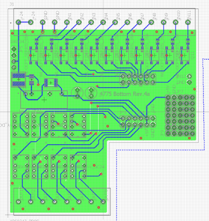

Also, looks like IDC cables to bottom board works, so will replace the middle two 12-pin connectors with regular ones instead of these smt ones.

Got one issue to sort out... Seems these OMROM signal relays are taking out the I2C momentarily...
Code can recover by processing the ACK signals, but not happy.
Not sure what is going on, but AI suggests there's an inductive spike when the coil turns off.
Think that must be it...
Having the ability for the software to recover gracefully is good. And also good to maintain an event counter of these errors too. You definitely want to know when this is repetitive since electrical damage is possible. And you never know, it might be helpful for your own sanity ... I recently improved my comport settings by monitoring the rate of modbus errors.
There's two possible electrical problems to cover. First is the coil flyback and solenoid spring return pulse back onto the coil drive component - presumably a prop pin. Second is potential RF arcing across the contacts of the relay. The effect on surrounding electronics from arcing is relative to both proximity and intensity of the arc.
There's multiple ways to improve the electrical side of things. A schematic is very helpful at this point.
The input is very simple... Just some OMRON G6K signal relays with 24V coils. When the coil is activated, a P2 pin is pulled down to ground, these have internal 15k pullups activated.
The other strange things is that there are 8 inputs to this relay array, but only the ones connected to switches right on the enclosure are giving me this trouble.
Do think it is the turning off of the switch where the I2C glitch happens, but need to verify that.
The current is very tiny here, think 2 mA, so very surprised this is happening...
But, maybe this mechanical switch has a lot of bounce and causing flyback EMI.
It is good that the I2C code can detect errors and ignore suspect input, but still not happy.

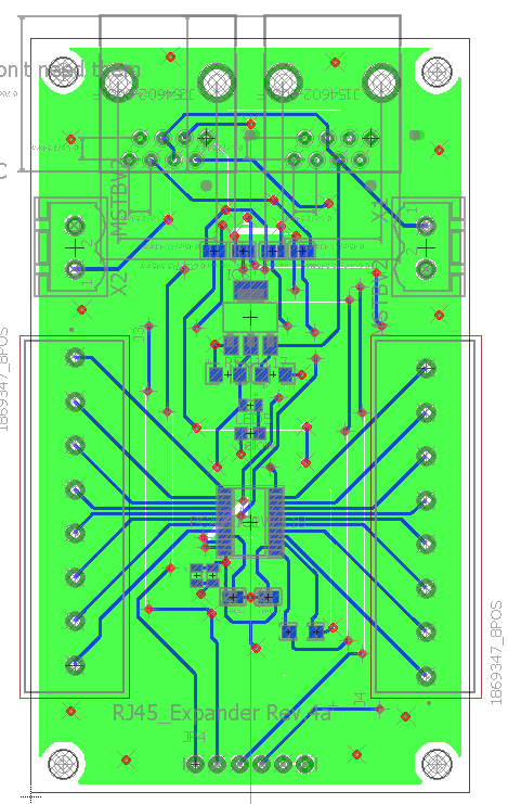

Just remembered the other thing that may have contributed to this noise problem...
The I2C I/O expander board didn't have a bypass cap close to the chip...
Soldered a leaded Ta cap on there, but that's probably not as good as ceramic.
New board being ordered now, has two caps 0.1u and 1.0u right next to the chip.
Be interesting to see if that fixes it as well...
But, also ordering a new DMB-4775 bottom board with 4-pin opto-isolators.
Oh my! You've defeated the whole purpose of using optocouplers by connecting both sides together.
Rayman, your middle name is gonna have to be "What have I done?"

Designed up two new board to help the cause...
One is for breaking out the RJ45 pins and also connecting them to QWIIC connectors.
There are twin sides that can be connected by a solder switch matrix.
So could be an RJ45 jumper, or could be two separate RJ45 breakouts.
Other one is I/O expander based on TLA2528.
Like this chip because the 8 i/o can be either analog or digital.
The left side is direct connection for digital.
Right side is voltage divider (cause needing to measure 0..10 VDC)
