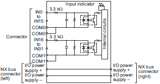

Got one issue to sort out... Seems these OMROM signal relays are taking out the I2C momentarily...
Code can recover by processing the ACK signals, but not happy.
Not sure what is going on, but AI suggests there's an inductive spike when the coil turns off.
Think that must be it...
Having the ability for the software to recover gracefully is good. And also good to maintain an event counter of these errors too. You definitely want to know when this is repetitive since electrical damage is possible. And you never know, it might be helpful for your own sanity ... I recently improved my comport settings by monitoring the rate of modbus errors.
There's two possible electrical problems to cover. First is the coil flyback and solenoid spring return pulse back onto the coil drive component - presumably a prop pin. Second is potential RF arcing across the contacts of the relay. The effect on surrounding electronics from arcing is relative to both proximity and intensity of the arc.
There's multiple ways to improve the electrical side of things. A schematic is very helpful at this point.
The input is very simple... Just some OMRON G6K signal relays with 24V coils. When the coil is activated, a P2 pin is pulled down to ground, these have internal 15k pullups activated.
The other strange things is that there are 8 inputs to this relay array, but only the ones connected to switches right on the enclosure are giving me this trouble.
Do think it is the turning off of the switch where the I2C glitch happens, but need to verify that.
The current is very tiny here, think 2 mA, so very surprised this is happening...
But, maybe this mechanical switch has a lot of bounce and causing flyback EMI.
It is good that the I2C code can detect errors and ignore suspect input, but still not happy.
@Rayman said:
That’s an option .. have to see if there are 24 v versions
Just add a resistor. Have a look at PLC manuals. They often document their I/O circuits so there is no confusion when wiring them up.
EDIT: Here's one I Googled. It has two commons so one common can be wired NPN and other PNP. You could instead have separate terminal pairs for each input.
Ok, think will switch the inputs to optoisolators... Will keep relays for outputs though.
Have used this kind in the past, think fine for this too:
https://www.digikey.com/en/products/detail/onsemi/H11L1SM/400369
Bit torn between SMD and through hole, but thinking SMD is better since also need a resistor for it.
Looks like a 10k resistor would be perfect for 24V signals.
Actually SMD is too big, switching to through hole...
