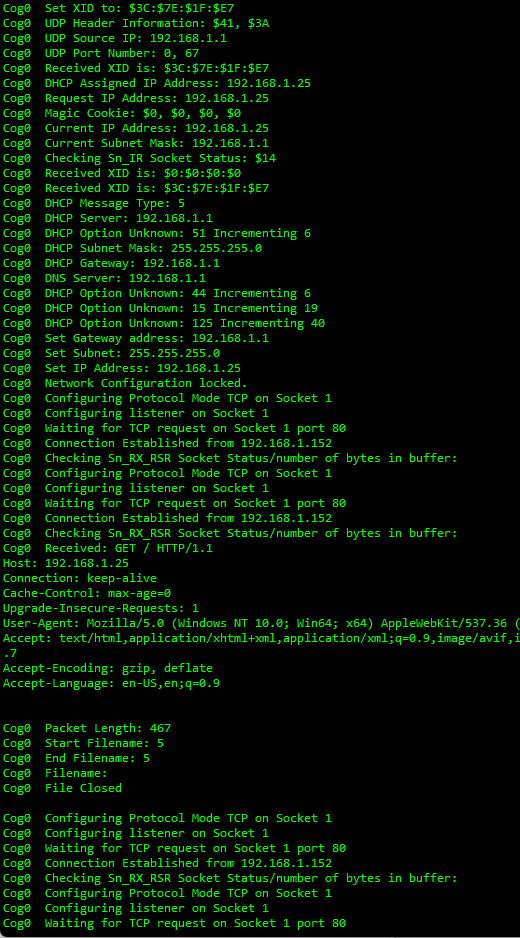

    @ke4pjw Thanks. Adjusted that delay, but doesn't help...
    Wondering if browser doesn't like the index.html file...
    The favicon is showing up on browser tab, not sure how though...
    From the debug it looks like the code is seeing a request with a blank filename...
    DHCP is working btw, testing that here at home...

    Hey @rayman, based on the debug, it should be setting the filename to index.htm. If the length is 5 characters, it knows it is "GET /". I will move that down to show the parsed filename.
    Maybe there is a problem with the file index.htm file. Make sure it is named index.htm as index.html is not the default document. I should have it configured to go through the list of potential default documents (index.html , index.htm, Default.htm, etc) It should be setting the image file as the background image of the .htm page. That's why I was asking what browser you were using. I had some problems with how Safari and Safari mobile works and have not rolled those changes into the code located at https://griswoldfx.visualstudio.com/spinner edge/_git/Software
    I have spent some time adding comments to the W6100.spin2 file in that repo. I had some additional changes I am going to make, but they will potentially break existing code. Only minor tweeks needed to make existing code work again. I am adding proper timeouts based on ms, rather than a crude arbitrary counter.
