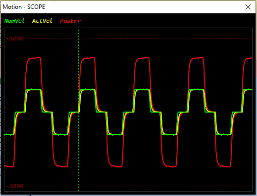

    The servo repeatedly moves forth and back by 10mm with this little NC program.
    REPEAT=1000
    G1 X10 F5000
    G4 H0.1
    G1 X0
    G4 H0.1
    NEXT
    M30
    The tuning is terrible (default factory settings) and the following error is more than 0.5mm (1000 steps = 1mm). But with this little tool I hopefully can improve it in a convenient way, soon. While the NC program runs in the background I can simply move the feed override slider to adjust the speed, set parameters over the MODBUS and watch the results in realtime.

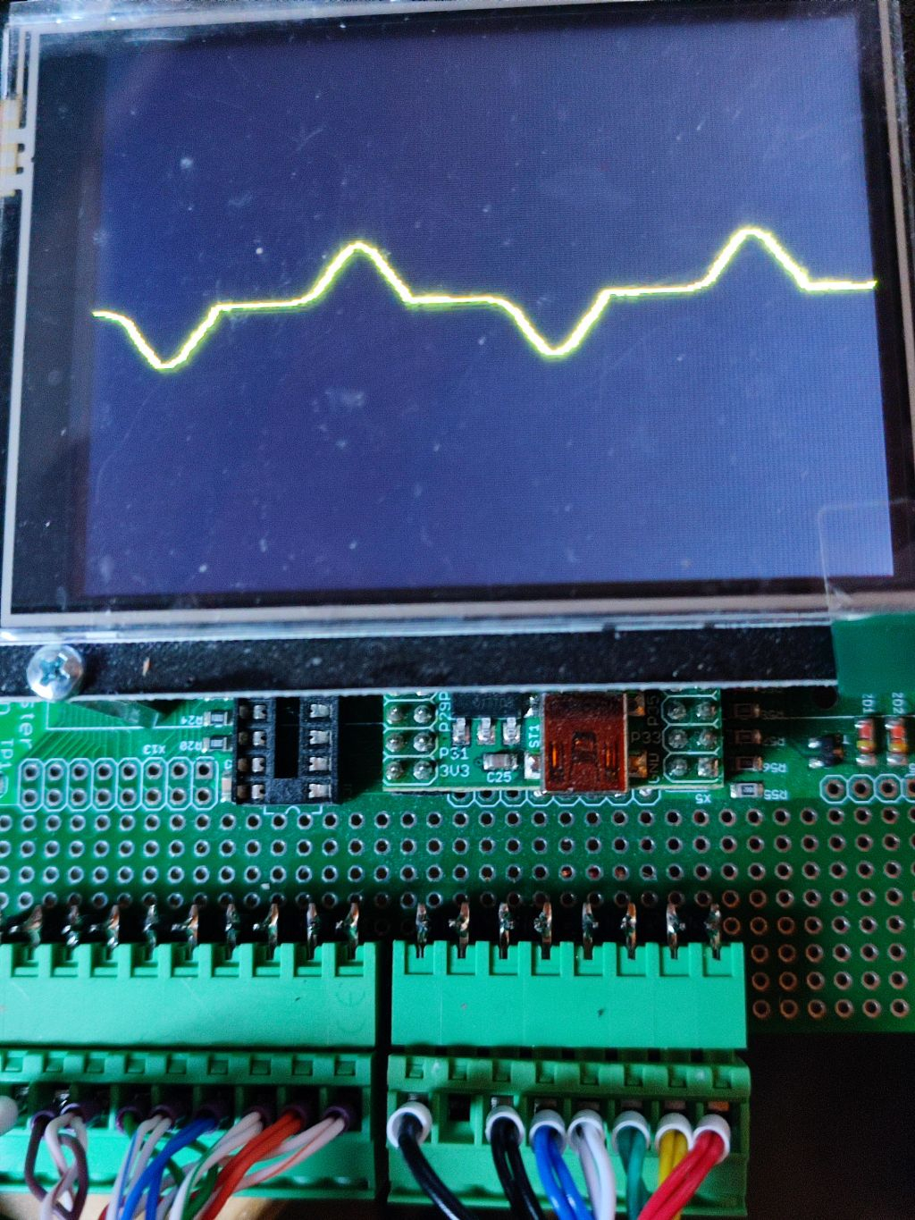

  • Of course, for the promise in the title "without PC software" to be true the scope traces have to be dispayed on the P2 board instead of the PC screen.
    The plan is to use this little board with a KISS module and an LCS screen.

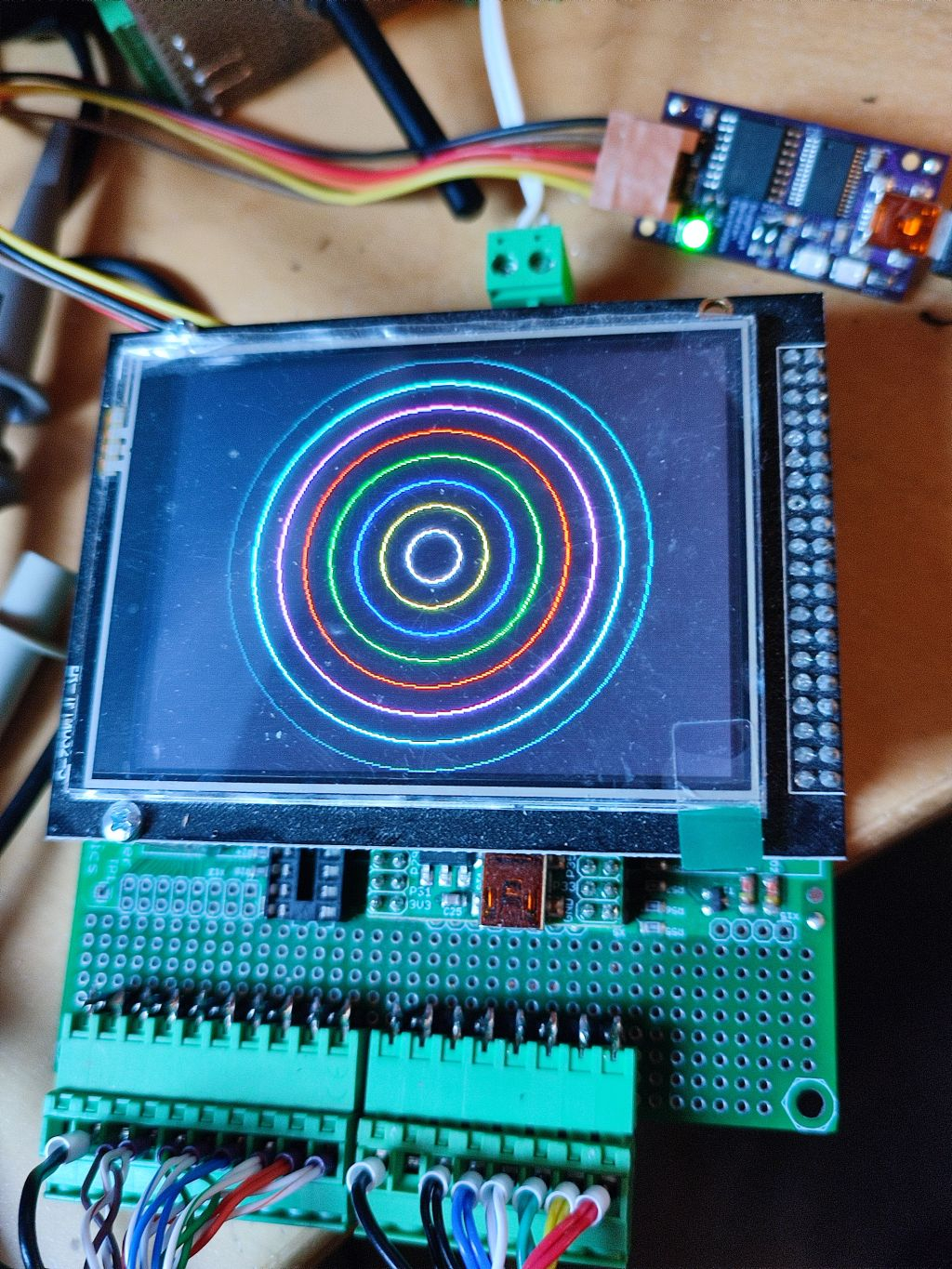

  • It works! :) But drawing the lines with the standard IL9341 LCD driver is way too slow. I need to draw to a RAM buffer, first, and then copy the bitmap data to the screen at once.

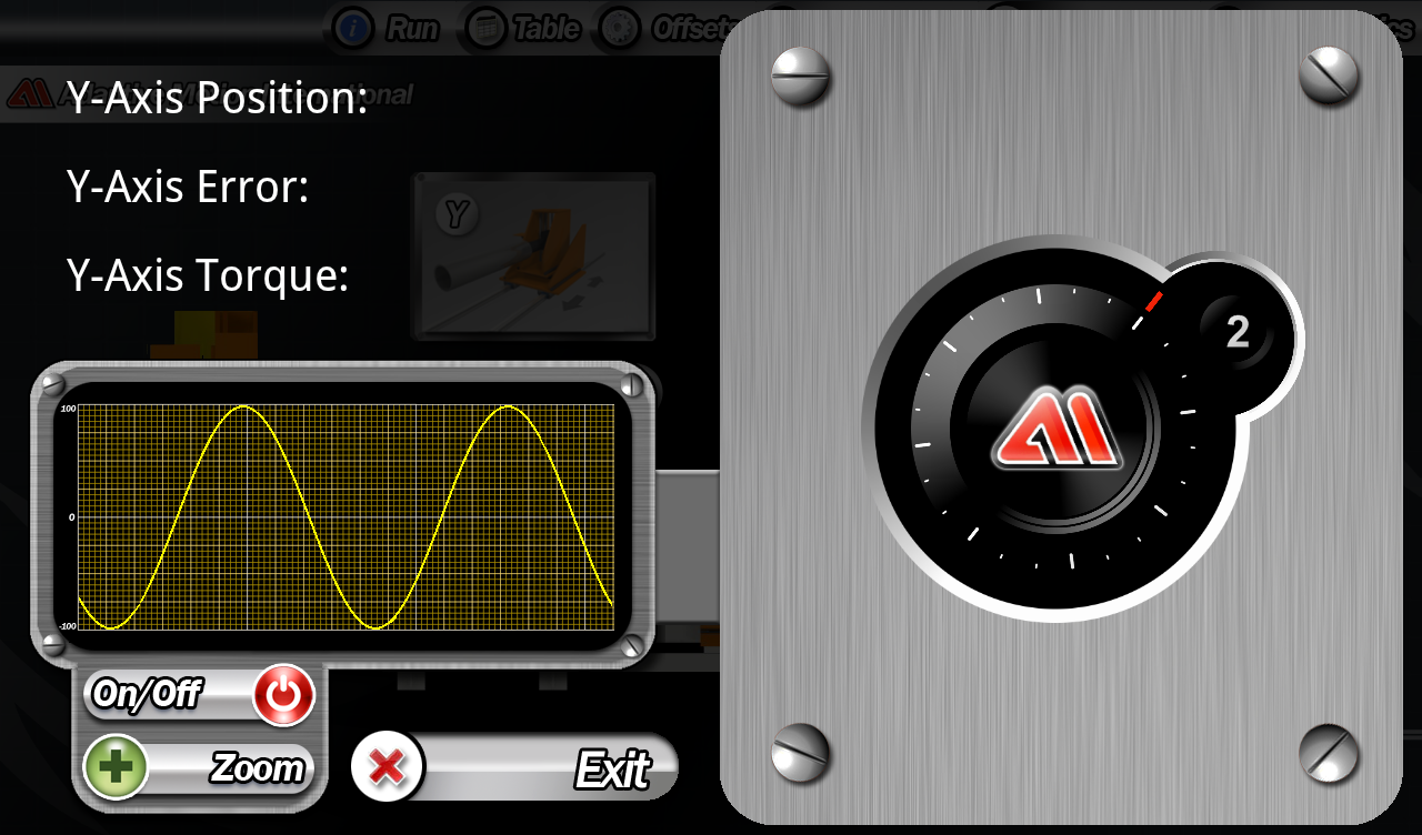

  • MicksterMickster Posts: 2,879
    I send via Bluetooth to an Android device:
