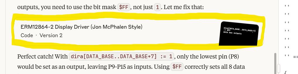

  • This is the link to the shared session
    -- https://claude.ai/share/38e394c6-0275-44fe-a7e9-d4782758f0a1
    I'm not sure what you mean by references. It shows what it's doing on-the-fly, but doesn't give a list of datasheets it read along the way.
    If you're looking for the various code iterations, you get get to them by clicking on a box that looks like this:
