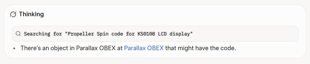

So, I tried Grok -- and not really thrilled. Prompt:
I have a ERM12864-2 display with a parallel bus. Please show me how to write Propeller 1 (Spin1) code to control this display.
Interestingly, Grok showed what was happening as it was "thinking." It even displayed this at one point.
The code output is not formatted at all, and there were two syntax errors that required fixing before it would compile at all. Since the code was short I manually reformatted it and turned it from a demo into an object. I don't know if it will work.
