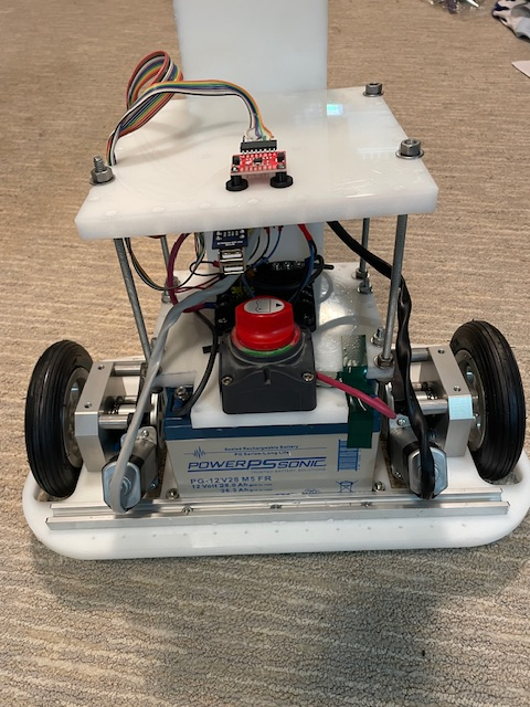

Got the motor mount and wheel kit from Parallax when saw it was half off:
https://www.parallax.com/product/motor-mount-wheel-kit-aluminum/
Also, got a caster to make a 3-wheel bot.
But, then saw a bunch of self-balancing bots and decided to try that first.
Here's the concept (see attached pic).
The construction is 1/2" HDPE and 1/4-20 hardware.
Just CNC'd the main board and it seems pretty solid, even with the giant hole in the middle for the battery.
How high up or how low to mount battery is perhaps the main question. Or, maybe if this battery is too big is another... Been reading that being top heavy is actually an advantage for self-balancing bots. But, think this SLA battery is beyond the pale, so lowering it via the giant hole. May try different amounts of lowering if this doesn't work.
Plan is to use P2 and BNO086 sensor in RVC mode to achieve balancing.
Might be a disaster, we'll see!

    "Steiner's theorem" https://en.wikipedia.org/wiki/Parallel_axis_theorem gives that the moment of inertia grows with the height in a quadratic way. As the moment of the weight corresponding to the deviation of a certain angle only grows linearly, it will be much more easy to balance, when you battery is mounted high. It is funny, that the long long rocket is a shape that is far more easy to balance than your shape. So if you succeed, the rocket will be easy-peasy for you next.... B)

    After looking at Arlo, thinking might be better to have motors on top. Mostly because of wiring...
    The allowable rotation angle goes down a hair, but not much.
    Ground clearance also about the same.
    Pretty sure that bot is going to need to balanced to start out with. Need to add weight to the front...

  • MicksterMickster Posts: 2,820
    That's the sort of thing that can be handled by an offset...added to the PID output. Same applies with vertical axes to compensate for gravity. I wouldn't needlessly increase the inertia...JMO :)

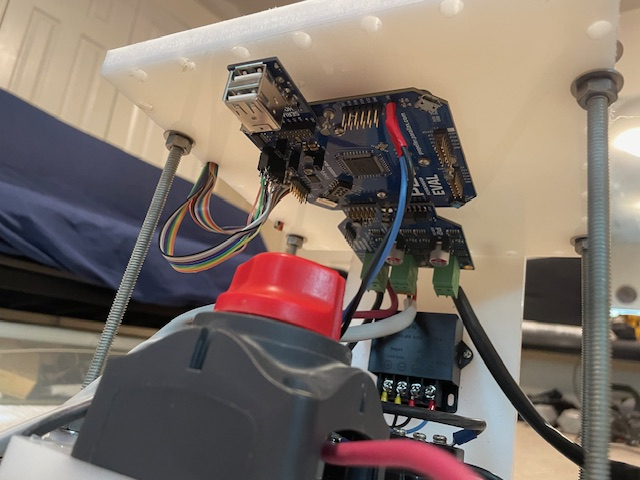

    It's all wired up. Moment of truth is near...
    480 x 640 - 157K
    640 x 480 - 165K
  • RaymanRayman Posts: 15,372
    Hmm... Motors act a little different than expected...
    They don't turn at all until drive set to 20% Doesn't turn with PWM set to 10%...
    And, they make funny pulsing noises. That may have something to do with not having any load though.
    They sound better with a little load...
    Knee-jerk reaction is aforementioned lack of feedback resolution....but no clue what you have. Also if your PID I-term is >0 then set it to zero.

    Observation is probably right. I'm not clear on the fundamentals around motors at all but I'd guess there is magnetisation losses of some sort that means you don't get torque until a certain amount of current is flowing. EDIT: Another factor can simply be mechanical frictions prevent motion until enough torque is applied. Gearboxes are a known source of this issue.
    Roughness in commutation is also probably unavoidable to a certain degree. After all, the shape of the poles are not continuous. And for brushed DC you've also got the segmented transitions around the commutator.
    PS: Also, be aware that voltage control behaves differently to current control. If you can do current sensing easily then I advise doing so. This is normally performed inside the motor drive circuit, with the demand from the motion controller (Propeller) representing desired current rather than voltage.

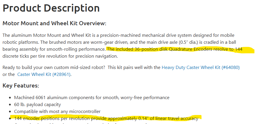

    I don't think Rayman's motors have any encoders, and maybe no current sense in the drives either. They look like simple brushed DC, presumably with primitive voltage based speed control.
    Looks like he's planning on relying on the BNO086 sensor for all feedback.
