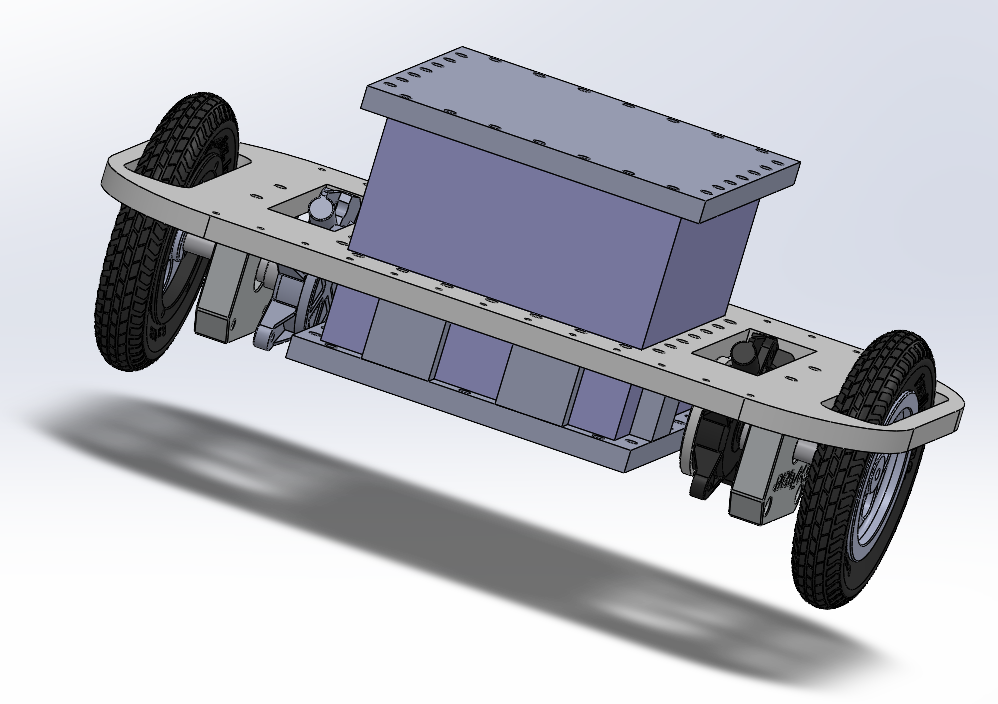

Got the motor mount and wheel kit from Parallax when saw it was half off:
https://www.parallax.com/product/motor-mount-wheel-kit-aluminum/
Also, got a caster to make a 3-wheel bot.
But, then saw a bunch of self-balancing bots and decided to try that first.
Here's the concept (see attached pic).
The construction is 1/2" HDPE and 1/4-20 hardware.
Just CNC'd the main board and it seems pretty solid, even with the giant hole in the middle for the battery.
How high up or how low to mount battery is perhaps the main question. Or, maybe if this battery is too big is another... Been reading that being top heavy is actually an advantage for self-balancing bots. But, think this SLA battery is beyond the pale, so lowering it via the giant hole. May try different amounts of lowering if this doesn't work.
Plan is to use P2 and BNO086 sensor in RVC mode to achieve balancing.
Might be a disaster, we'll see!

    "Steiner's theorem" https://en.wikipedia.org/wiki/Parallel_axis_theorem gives that the moment of inertia grows with the height in a quadratic way. As the moment of the weight corresponding to the deviation of a certain angle only grows linearly, it will be much more easy to balance, when you battery is mounted high. It is funny, that the long long rocket is a shape that is far more easy to balance than your shape. So if you succeed, the rocket will be easy-peasy for you next.... B)
    Christof

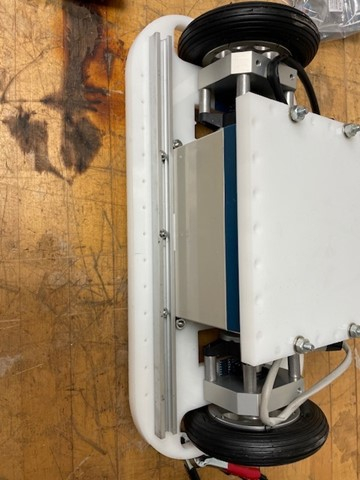

  • RaymanRayman Posts: 16,461
    Main HDPE board was bowing a bit, so added a piece of t-track that was around.
    Seems better now...

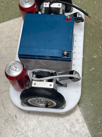

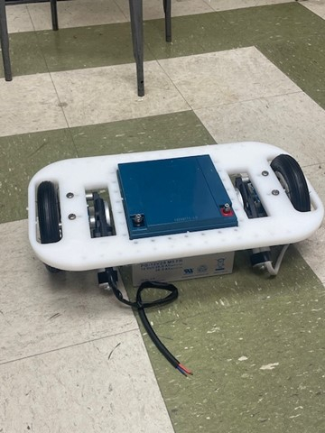

    It's all wired up. Moment of truth is near...
    480 x 640 - 157K
    640 x 480 - 165K
    Hmm... Motors act a little different than expected...
    They don't turn at all until drive set to 20% Doesn't turn with PWM set to 10%...
    And, they make funny pulsing noises. That may have something to do with not having any load though.
    They sound better with a little load...
