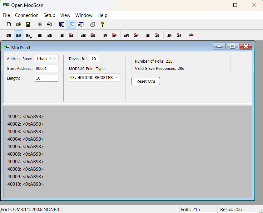

  • RaymanRayman Posts: 15,899
    Guess had a 50/50 shot at getting byte order correct and of course was wrong...
    Think good now. Found a free and open source scanner, but it also only does functions 1..4
    https://github.com/sanny32/OpenModScan
    Now thinking also want to implement function #6, Preset Single Register, which means to set one of the "holding registers" to some 16-bit value.
    Found a modbus scanner that can do functions 5 and 6, but is not free, does have 30 day trial though.
    Will keep looking...
