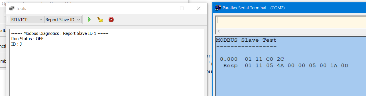

  • RaymanRayman Posts: 15,996

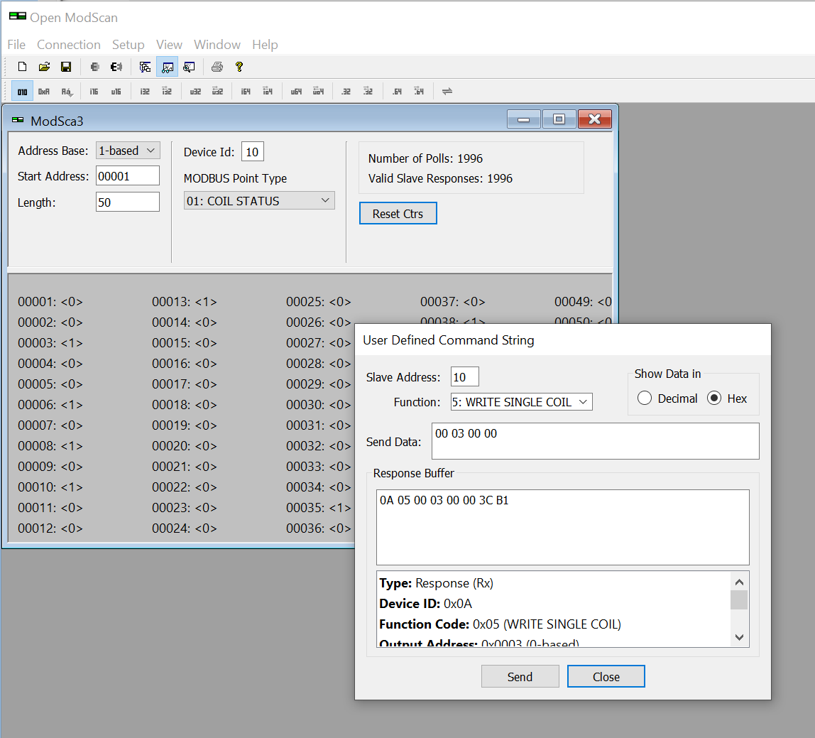

    Just tried that Open Mod Scan: https://github.com/sanny32/OpenModScan
    It's strange, but think works.
    When you do "New" you can get to that main window than will continuously scan functions 1, 2, 3, or 4.
    Here, doing 1 (Read Coil Status)
    Then, can do Setup->Extended->User Msg.
    This brings up the top window where you can pick things like 5 (Write Single Coil).
    With this open, you can send 4 bytes to set a coil and then see it change in the back window (doing read coil status).
    The first two bytes are the address and the next two bytes are the value.
    If the value is "FF 00" then the coil is set to 1, anything else sets the coil to 0.
    It seems that it injects this function 5 in between the continuous calls to function 1...
    Guess that's OK.
    So, this (although a bit clunky), seems to do everything needed to exercise the code.

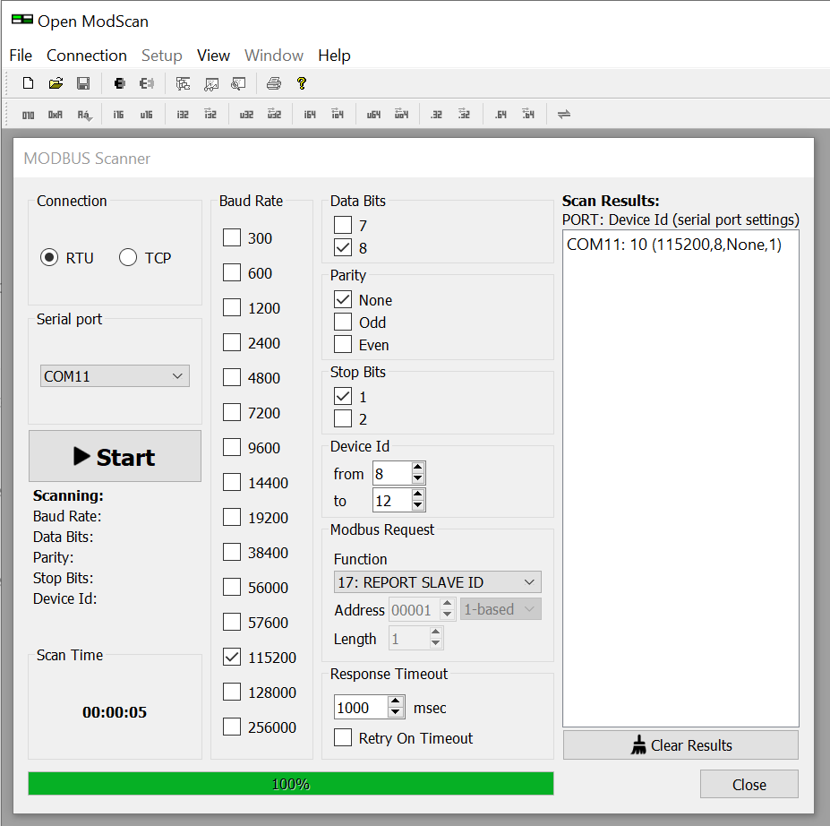

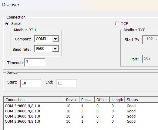

    There is also a "Modbus Scanner". This defaults to function 17 (Report Slave ID), but can be changed to function 1.
    This has me thinking that Report Slave ID is something that should be implemented.
    Guess this could be like a virtual serial number for the device...
    edited 2025-08-05 16:36
    Hmm... Looks like function 17 (Report Slave ID) return value is more or less arbitrary. There are a few examples here: https://modbus.org/docs/PI_MBUS_300.pdf
    Might just have it answer with something random for now...
    ON/OFF state is interesting though, might include that.

    Got the Modbus scanner part of Open ModScan to be happy with response from the default scan of "17: REPORT SLAVE ID".
    It's a bit annoying that the scanner has a separate serial interface than the rest of it, so you can't have both connected at the same time.
    Also, closing the serial port has the also annoying affect of rebooting the P2...
    But, am thinking this is where it needs to be now.
    Guess should actually implement CRC check on incoming data.
    That's a bit silly here because the USB interface is already doing that, but would be good in case were an actual RS232 connection...
  • I decided to follow your lead and add handling of command 17 to my MODBUS Slave framework.
    I am testing with a USB-to-RS485 adapter on my PC and my own RS-485 board on the P2, so I've been doing this. I do it at the top level so that it doesn't have to be checked by individual routines.
        crc := calc_crc(@rxbuf, len-2)
        if (crc == extract_crc(@rxbuf, len))                        ' if good message
          process_request()                                         '  reply to master
    As an experiment, I decided to return the slave id, run status, and three bytes from my firmware version number.
    pub read_slave_id() | crc
      if (rxbuf[0] == BROADCAST)
        return
      txbuf[0] := myaddr
      txbuf[1] := $11
      txbuf[2] := 5
      txbuf[3] := MY_ID
      txbuf[4] := (devStatus) ? $FF : $00
      txbuf[5] := VERSION  / 100                                    ' major
      txbuf[6] := VERSION // 100 / 10                               ' minor
      txbuf[7] := VERSION //  10                                    ' bug fix
      crc := calc_crc(@txbuf, 8)
      bytemove(@txbuf[8], @crc, 2)
      send_msg(10)                                                  ' reply to master
      show_reply(10)
    I'm using QModMaster which also has a separate dialog for the slave ID response, and it doesn't show the additional bytes past the device status.
