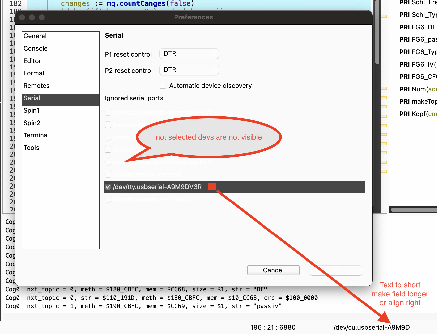

  • wummiwummi Posts: 109
    @macca said:
    Released version 0.48.0
    I tested the new version and all the problems disappeared.
    Now I can compile all my projects and run them all.
    Thank you macca for your work.
    On MacOS I found some GUI issues:
  • maccamacca Posts: 955
    Excellent!
    Yes, white on light-gray isn't much readable... I'll try to fix these issue for the next release.

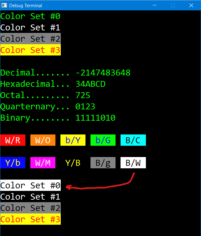

  • JonnyMacJonnyMac Posts: 9,545
    edited 2025-06-23 18:21
    I updated my jm_debug_term object to allow the use of arbitrary colors that are available in Spin Tools 0.48.1. Note that when changing the foreground or background you modify color set 0, though it's not likely that a practical app would mix the use of the default color sets with arbitrary colors.
    If we could load the old IBM character font we could have text output like on the early IBM PCs and clones! :D
    Hopefully, @cgracey will add the ability to change the foreground and background colors in PNut. Would also be nice if zstr() worked in the debug terminal window, too.
