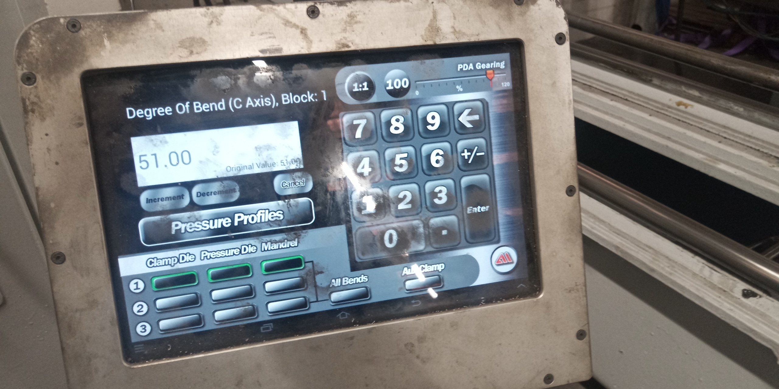

    This is a question that I have asked repeatedly but have never received a response; arguably, the most powerful and ubiquitous HMI is in your pocket.
    By far, the #1 failure is the HMI because it is subject to physical abuse.
    If your display fails, production grinds to a halt. Why not incorporate a Bluetooth link and talk to the device via any mobile device?
    More than 10 years in a grueling environment. Covered in grime and metal shavings. Responds like it was new.
    If it should fail, the customer has the same app on his phone until he procures a new Android tablet. It's only a Samsung Galaxy.
    The next machine over has a Siemens "industrial HMI". Many of the buttons are dead and the joystick mouse emulator is dead and so (what you'll see on every plant floor) a standard PC keyboard and mouse have been plugged in the back so they can at least use it.
    It's nuts. I've been using Android tablets since 2012 and they just run and run.

  • MicksterMickster Posts: 2,782
    Scenario:
    A 24/7 production line goes down at 1am Sunday.
    I am up and running within minutes. Nobody keeps spares.
    How much time would you need to get a new Nextion display and install it.
    Engineers tend to ignore these catastrophic events....it's someone else's problem.
    Bricked Android device?
    Never been a problem. Factory reset is always possible but if that wasn't happening, who cares?
    You can always find another. Pair the Bluetooth and you're back in business.
