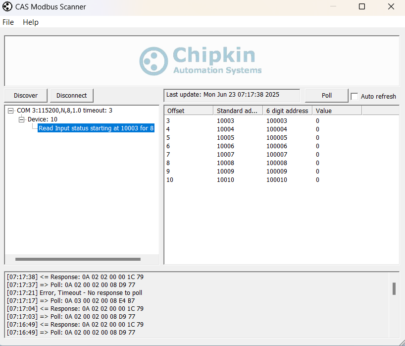

    So, the modbus scanner is very sensitive to response timing.
    Think figured out that it somewhat follows the 3.5 character minimum delay mentioned in the modbus.org document.
    But, there also seems to be a maximum delay, so it has to be just right.
    Anyway, need to be able to code the response with CRC within that delay, it seems.
    At 9600 baud, the scanner seemed happy with a delay of ~10 ms.
    At 115200 baud, seems happy with ~80 us.
    This is not exactly linear, so not sure what is going on here.
    Thinking timing is just going to have to baud table lookup.
    Might be best to just stick with one baud for now.
    Will see if 80 us is enough time to calc CRC for general case.
    There is a "timeout" setting in the scanner that seems to range from 3 to 30. But, don't want to mess with that for now...

    The modbus scanner will sometimes not be 100% "good" with P2 replies on first pass. Better, if not perfect on later passes... Not sure how bad that is.
    Going to work on better timing control and see if can improve that...
    There may be some latency going through the FTDI adapter that can't be controlled. Although, maybe can be improved in device manager...

    @evanh
    Getting close to an actually functional slave now.
    Finding that the "Discover" window is hard to get right.
    But, the main window is very nice and shows the actual binary query and the reply.
    This is more helpful.
    Also, the 1.8" lcd is pretty useless as is because is too slow and causes timeouts at 115200 baud.
    Was also reading that 19200 baud is the usual default, but maybe that is old info?
    818 x 698 - 49K
  • RaymanRayman Posts: 16,072
    This slave test might be right... Seems to give correct response to the modbus scanner, at least with simple test.
    Unfortunately, the scanner won't let me test function #5, force coil value, so have to make something else for that.
    Guess have to code up a Modbus RTU master too...
