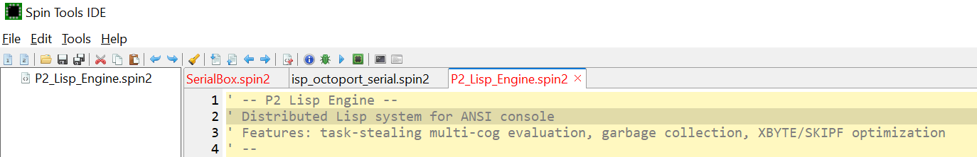

    Interesting. I was also planning to implement the Lua interpreter across multiple cogs. It looks like your Lisp Engine will get there first, but that is entirely appropriate! :)

    The editor works now also:
